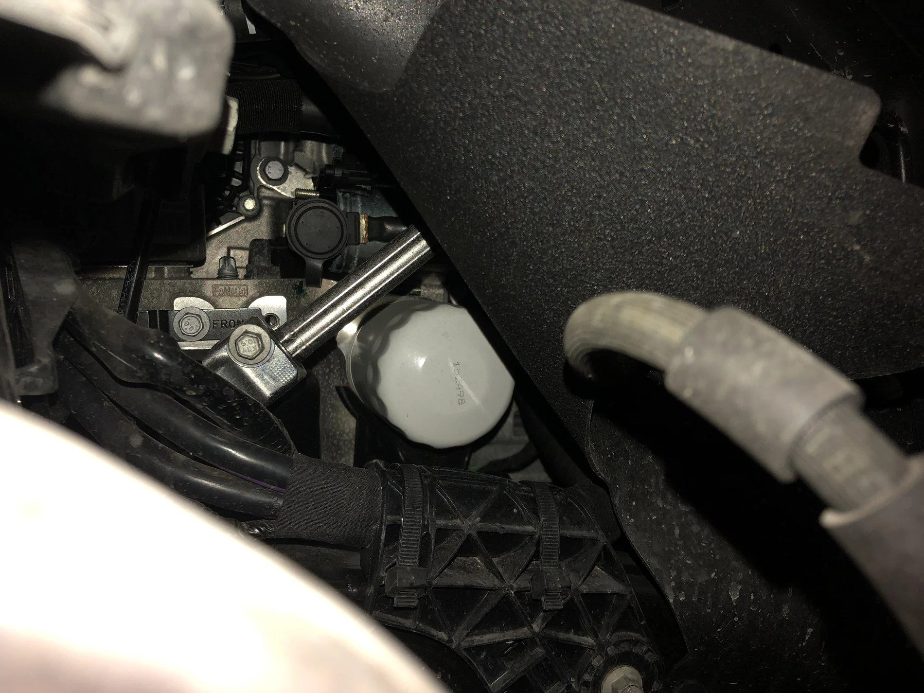

To bring this full circle, I did an oil change last week or so. The flap comes off pretty easy, the little plastic screw clips come out OK, but you have to make sure that the base of the clip doesn't turn, and they will pull right out.
The filter on mine was really tight, so it took a little while to muscle it off. I could only reach it with one hand, so it was slow...

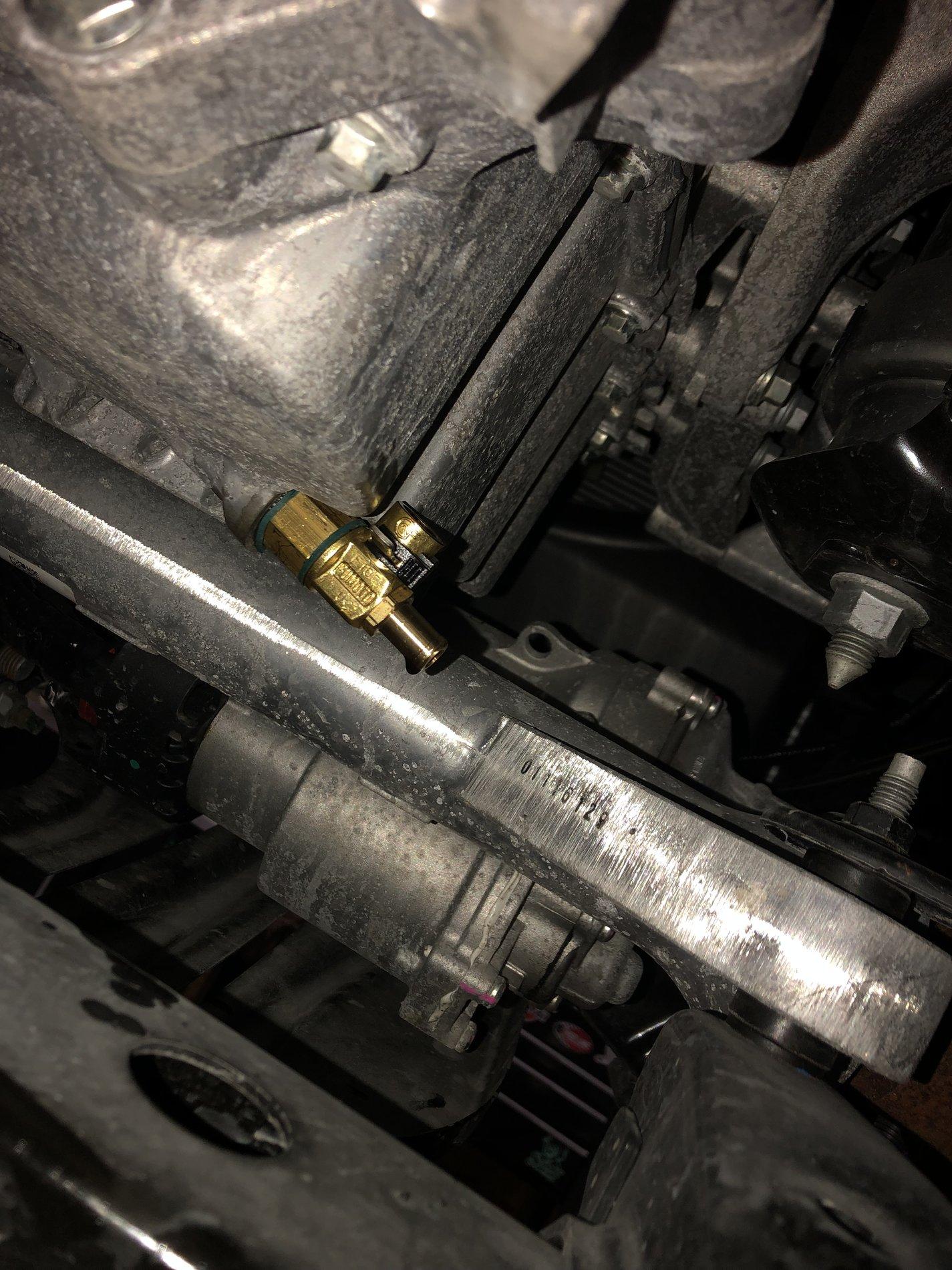

I would recommend putting an oil catch pan under it and letting the bulk of the oil go there before moving to the drain bolt. Definitely put a diaper or some other can under the funnel piece as it continued to drip for a while after the filter was removed. The Fumoto 107N does not fit, I have ordered the extension from Fumoto to see if it will fit after that so that I don't have to pull the skid plate anymore.
