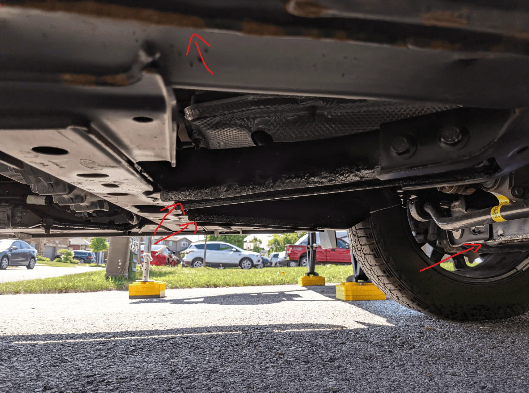

Just wanted to add an actual photo of the (mostly now-converted) rust I noticed when doing my oil change:
Seems worse than typical surface-rust.. but I don't know
