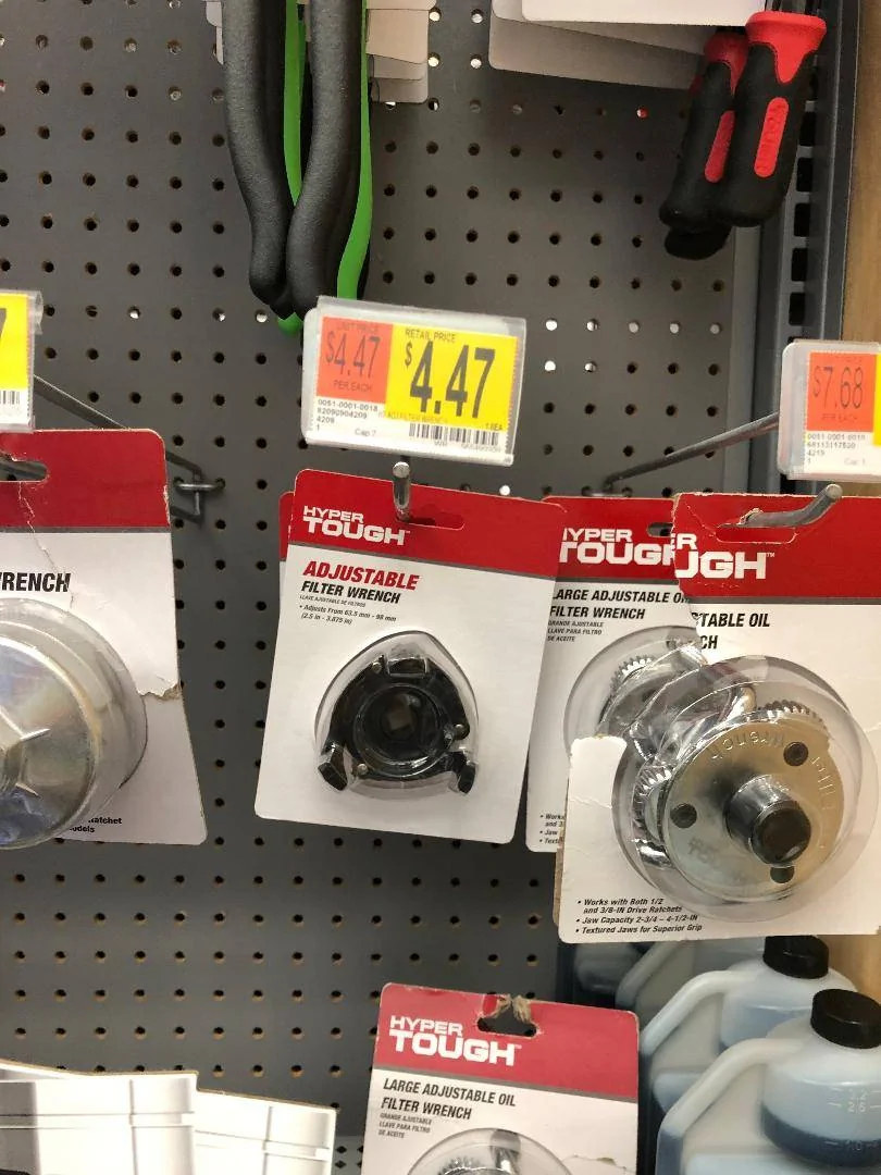

the fumoto valve with the nipple to attach a hose to. I just tuck it above the skid plate, then point it into a disposal jug when draining. I had a hard time getting the filter off too an ended up buying one of these. It's handy because not all filters are the right diameter for the end cap wrenches. I've used a wix and a moble one filter on my truck an all were different.

They’re the same diameter filter. It’s the number of flats on them that’s different. 14 flats at 73 mm is fomoco filter and mobile 1. 15 flats at 73 mm is wix. Yup I got both sizes now! That was a head scratcher for sure!

That 3 jaw filter wrench is a life saver for Harley filters. I bought the HD tool but it only works on actual HD filters. I have used wix an a few other that make long life motorcycle filters. It works well for reaching straight in like you have to on the ranger. My friends have borrowed it too. I've gotten my 6 bucks worth out of it.
