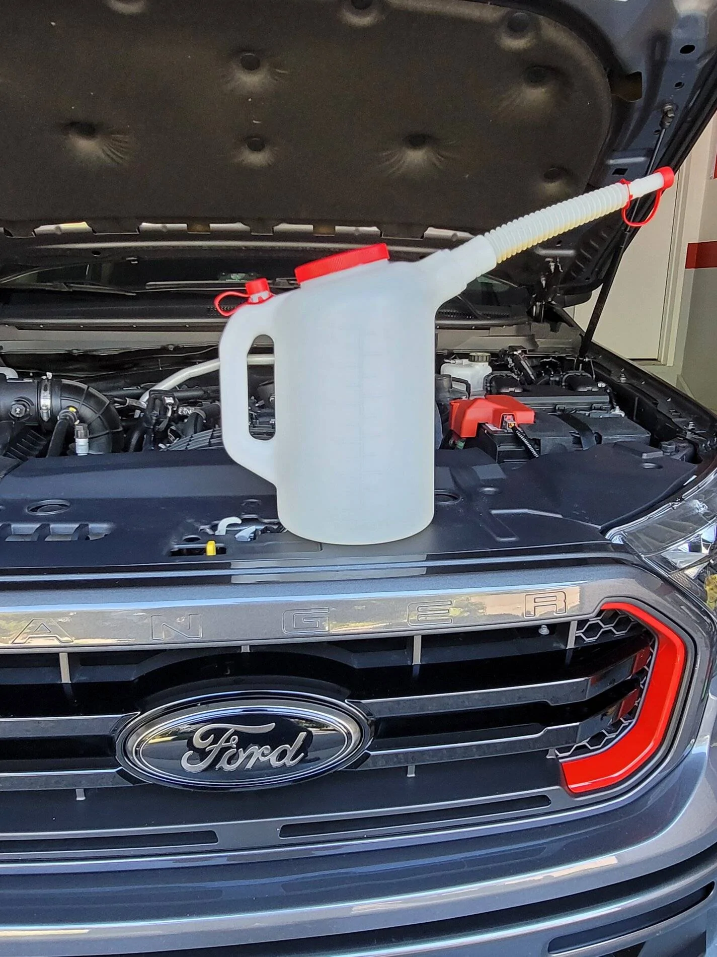

This thing is the best $7 I've ever spent. Fill it 6qrts, pour in. No mess at all
Okay, CT
From where did you get this container? Who makes it?
