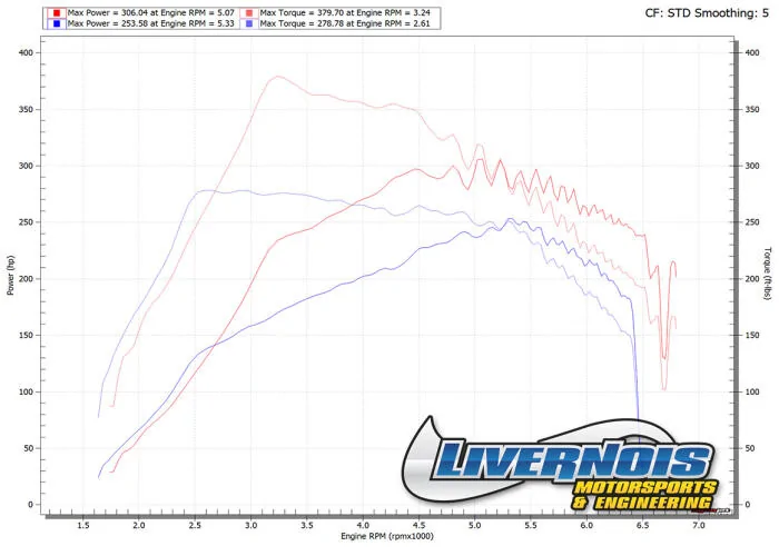

Are there dynos or estimate for all tunes?
LT Dangle
Brett
Apr 8, 2022
233
780
New York
21 FX4 (RIP), 21 Tremor, 20 Edge ST, Couple HD's
Trophy Husband / "Sanitation Worker" / Army Vet
The new MyCalibrator Touch is available exclusively from Livernois Motorsports for your 2019-2023 Ford Ranger 2.3L Ecoboost.
The Livernois MyCalibrator tuner offers multiple levels of improved tuning, with the E30 performance tune leading the way in performance. This tune is good for peak vs. peak gains of over 53WHP and 101WTQ, with maximum gains of over 80WHP and 101WTQ.
In addition to these just simply gaining power, we also spent a great deal of time improving throttle response, part-throttle and wide-open throttle shifting, and working to ensure our updates play well in all driving modes. Coupled with the performance upgrade, these drivability changes make the truck feel greatly improved in day-to-day usage. As with all of our previous tuners, your purchase today gains you access to all future updates and revisions.
Purchase of this tuner includes 1 gasoline tow tune and 1 gasoline performance tune for a stock vehicle. Extra tunes can be purchased under the optional add-ons drop down.
They dont have a chart for each individual tune, but im sure you could ask them for the rest
