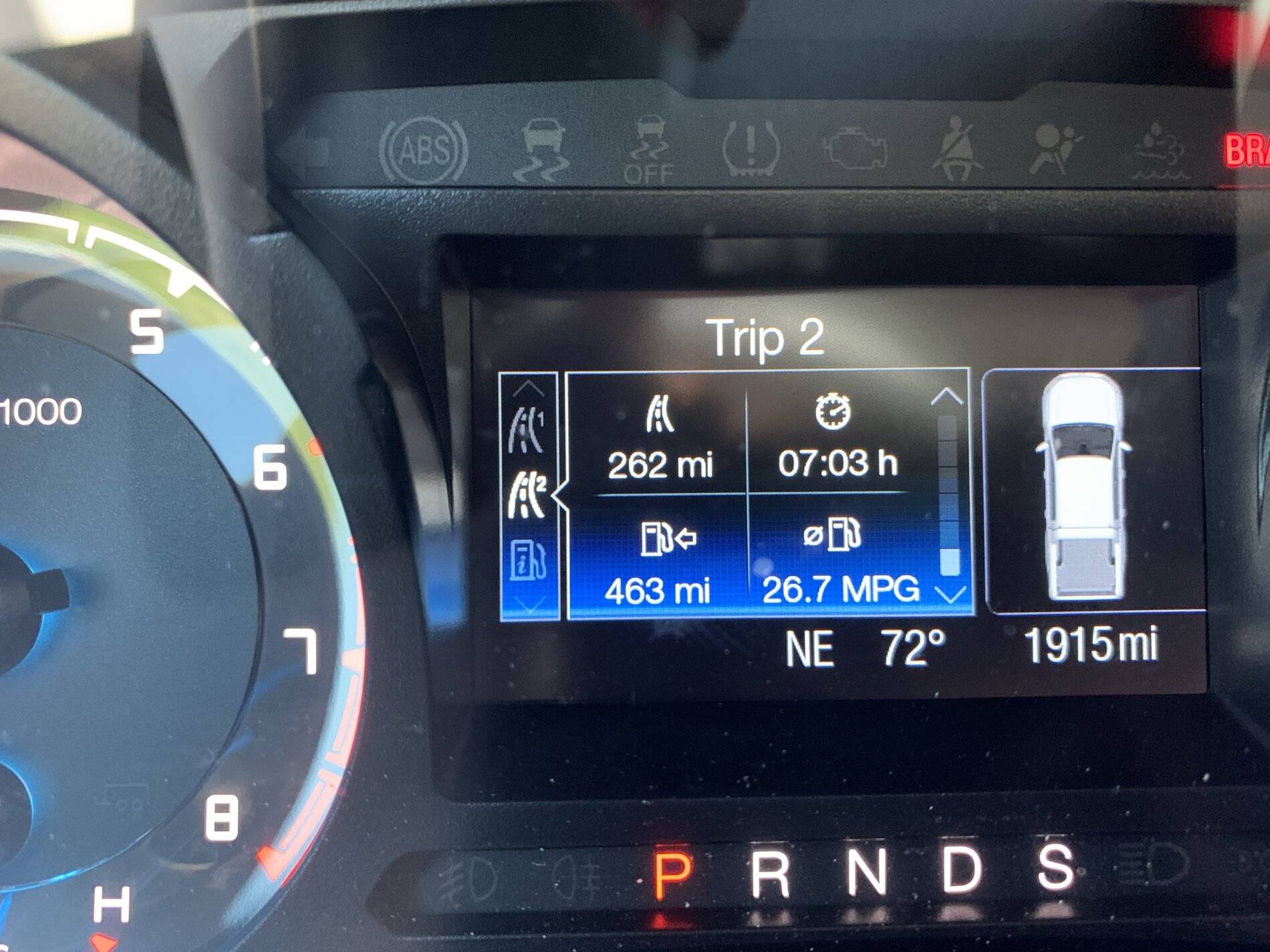

Extremely Happy! Installed the 93 octane tune at 10k miles, now at 45k. Only complaint is if I don't let it run for 1 to 2 min cold it stutters sometimes. No big deal as I never just start and run anyway. Picked up 3 mpg highway - 27 if I keep my foot out of it and has eaten every hemi that has challenged it. Shifting is much more aggressive than stock as it no longer skips gears. Stand into it and it will come loose going into 2nd and 3rd. Go easy on the peddle and the shifts aren't bad.

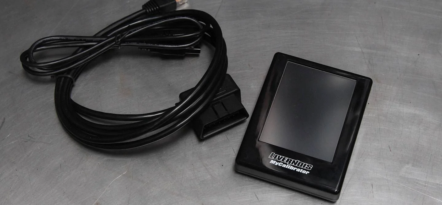

You will receive the device without tunes. Take it to a computer, plug it in and let it update firmware. Then, go to the truck, plug it in and let it get the strategy and other information it needs. It will also download your stock tune file to the device. Then, go back to the computer and connect again. It will send your stock file to Livernois for backup purposes and you can request the tune files you want. A day or so later, you should get an email letting you know they're ready. Plug the device into the computer again and download.
That's a summary from memory. My memory sucks. Follow whatever directions they send you with the device.
