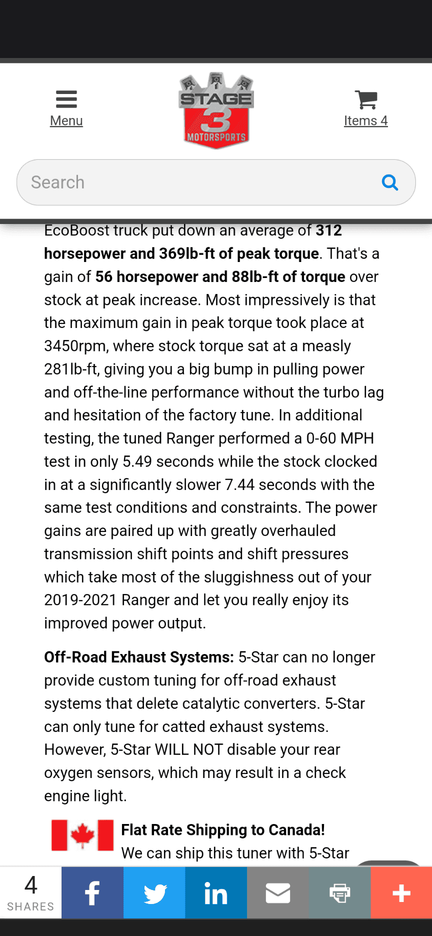

5 star won't tune the catless downpipes but they will tune the catted downpipe.

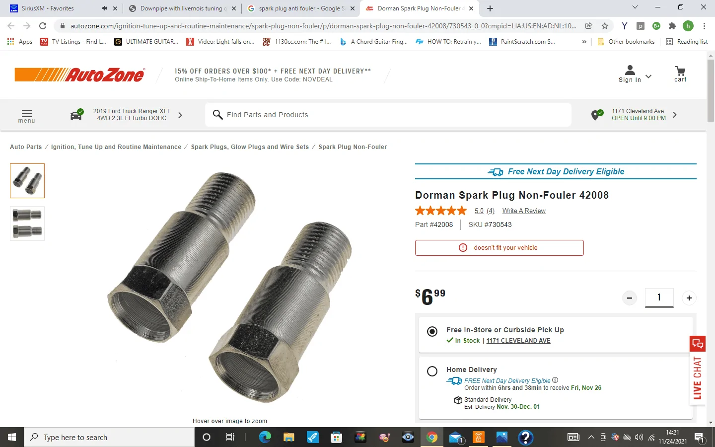

I was thinking about running a catted down pipe but not sure it's worth it now. I think the law is it's illegal for a shop to remove a properly functioning cat from a car with less than 50K on it. Harley got in big trouble with the EPA an paid a massive fine because they were selling tunes that didn't comply to epa standards. Now they will tune your bike for better performance but all their tunes comply now. I was going to wait until the 5/60 warrant expired anyway.
back in the day when I ran with the 5.0/4.6 mustang crowd lots of guys would run catless X pipes. They would "trick" the ecm by installing spark plug anti foulers between the X pipe an rear O2 sensors. This spaced the O2 sensor away from the direct flow of the exhaust giving a little exhaust to read, just enough to make the system think it's seeing cleaner exhaust.
Ahh, great explanation. So either no downpipe and just run the tune or downpipe+tune+spacer.
