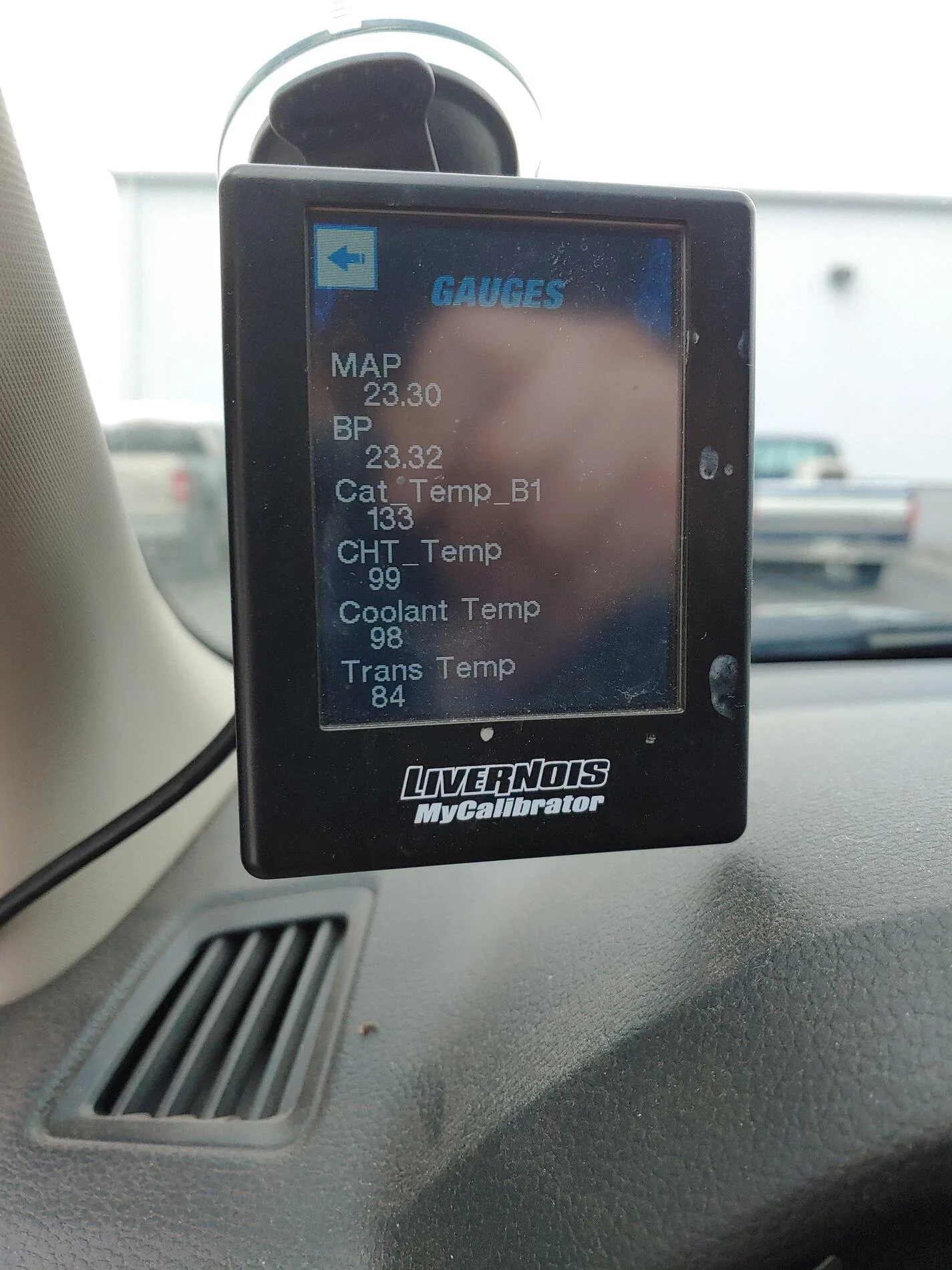

@Frenchy - Do you know of a guide from Livernois to all the gauge options on the Procal tool? I’ve tried the A/F gauge but some of the numbers I get on that gauge and others in the Procal make no sense. Feel like I need a “Procal for Idiots” guide. Right now I monitor IAT / Coolant / Tire Pressures.
Lol I don't have a guide but the reading you get on the My Touch Calibrator for Air/Fuel is a Lambda reading. It is different then wide band and a bit more precise for the PCM. I myself monitor the following: Map and BP(I use them for boost calculations) Transmission Temp, Cat Temp(calculated value but better than nothing) Coolant Temp and Cylinder Head Temp(I watch the correlation between this and Coolant so I know if a leak is present without opening the hood). What you watch is up to you. Tire pressure is also avalible in the intrument cluster. I cant speak for the XL but I know for sure the XLT and Lariat do.

Hey that’s helpful info. Thank you!
What does BP represent (boost pressure?) and how are you calculating boost pressure between MAP and BP?
What are the names of the gauges to select for the trans temp and Cylinder head temp? I’ve looked for the trans temp under the trans set of gauges but couldn’t determine which gauge setting was the right one.
My XL does have tire pressure in the cluster but I used on the Procal to “take up room”
Sorry for the stupid questions,but appreciate the guidance!
BP stands for Barometric Pressure. That is the static air pressure in the general area you are in. For example a place with. High elevation with have lower Barometric Pressure. With that being said I take my Map pressure reading and subtract the BP and then divide that number by 2. Most of the time I will see a peak in the low to mid 20's in psi. That is how I calculate. As for transmission temp you need to scroll through the transmission screen to get that temperature reading. It is a pain to scroll but it is possible. Cylinder head temp is shown as CHT.

Awesome info! I didn’t even know you could scroll on the trans gauges screen. Imma have me some fun in the AM. Many thanks, Frenchy!
