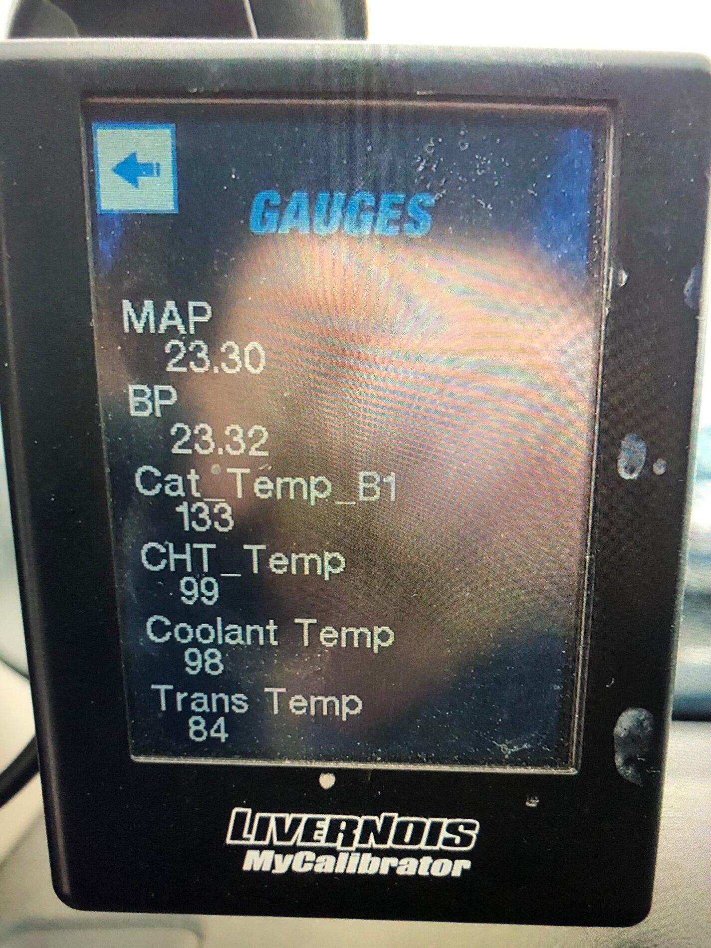

They have 5 tunes for the Ranger and you'll get all of them. I like the 91-93 performance tune and have been running that one since August. Like Steve mentioned you don't need to keep it plugged in but you can see data if you do. They sell a suction cup mount which if you're wanting to mount it you should get when you order your tune. Otherwise it cost more to ship it than the mount.

Thanks for the INFO and the picture! Nice to know I can choose when I want to have the unit plugged in but still use it when I want to see the data.

Everyone here is correct about the tune, you will not need to keep the tuner plugged in but it is nice to have temp gauges for transmission and other things.

If anyone has figured out how to get this Procal tool to display boost pressure in PSI I’d appreciate the insight. Kinda sucks not being able to when other tools like the 5star Tuning tool can.
