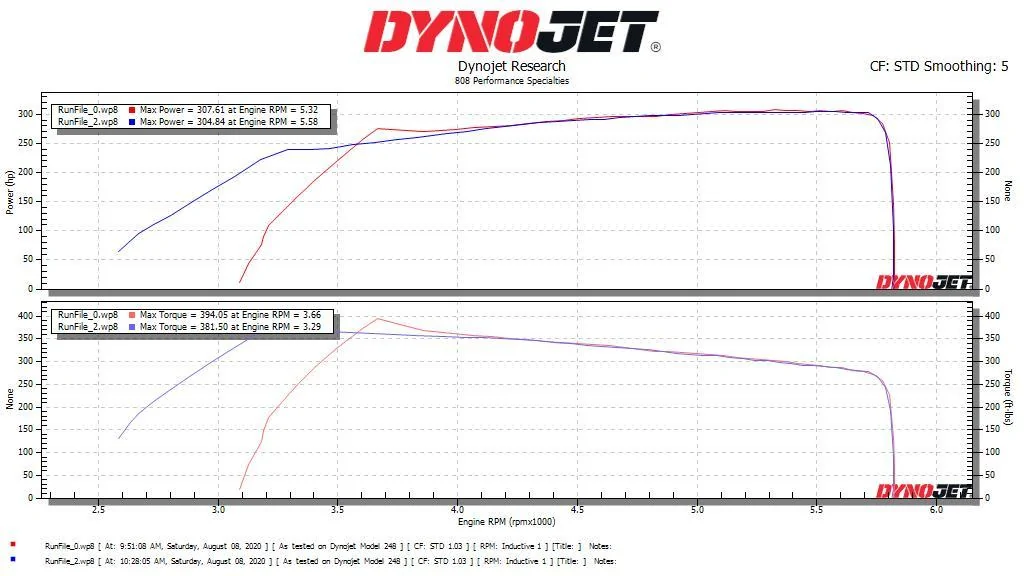

I have gotten a lot of awesome info from this forum so I thought I would share some results. This was with the Livernois soft shift with 92 octane. I have some bolt ons installed (FP Borla Exhaust, AFE Charge Pipe, AFE Downpipe, and Turbo Smart BOV). waiting on Mishimoto CAI to ship this month. I was aiming for "Henessey Numbers" (I think 330 hp and 440tq). Fell a little short but still very impressed with the drivability and power. The gentleman conducting the test did say he was hitting the speed limiter so I'm guessing theres more power in there. Not sure how to get to the last 40hp and tq. in any case I just wanna say thanks for the wealth of information and shout out to Livernois for high quality product.

Very Good !
Regards
EDIT: Those hennessy numbers are at the crank, you have exceeded their rear wheel numbers in torque..You are at 394 lb/ft of torque at the rear wheels...
“The stock Ranger is equipped with a 2.3 liter EcoBoost four-cylinder, rated at 270 horsepower at the crank. In this dyno video on Hennessey's YouTube channel, the base truck is good for 243 wheel horsepower and 267 lb/ft of torque.
After adding Hennessey's performance software and their stainless steel cat-back exhaust system, Hennessey claims 360 horsepower at the crank and 440 lb/ft of torque. On the dyno, that translates to a respectable 306 wheel horsepower and 374 lb/ft of torque.”
