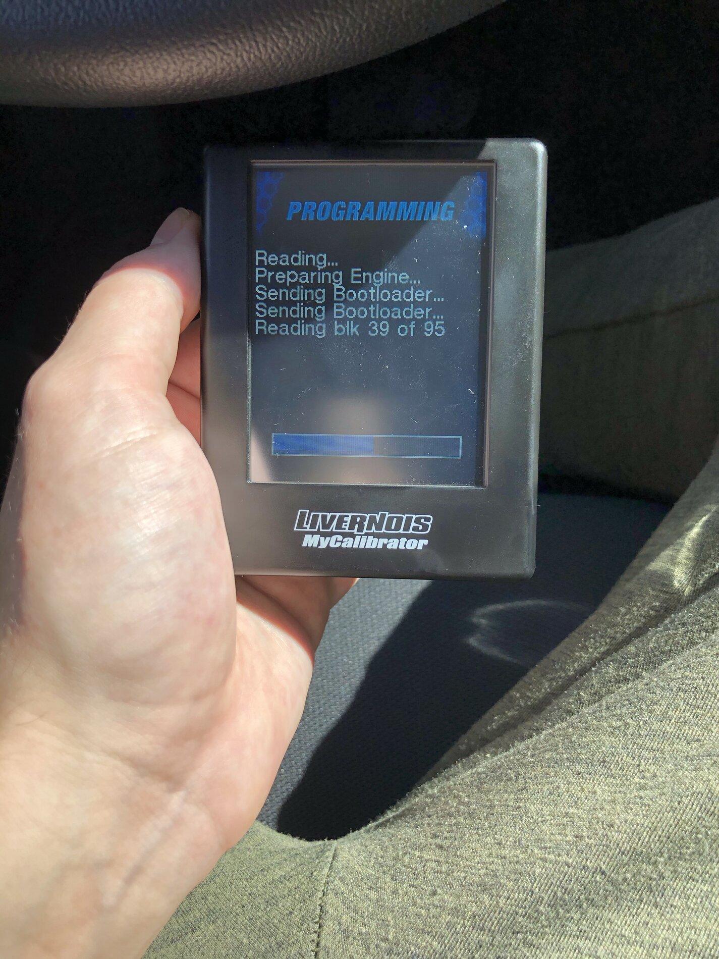

Yes, they'll send you whatever tunes you ask for all at once. I received a tow, 91-93 performance, 91-93 performance soft shift, 85-87 performance, and 85-87 soft shift. The tuner gets all the tunes they send as well as your original stock tune stored on it, and you can swap between them whenever you like. Just plug in the tuner and follow the instructions.
The initial backup of your stock tune will take around 10 minutes, as it has to read something like 91 blocks from the vehicle. Some blocks just take a few seconds, others take a lot longer. When you receive your tunes, it only writes a few blocks when you install a tune (I think maybe 11 blocks? Maybe 13?) so that only takes like a minute or 2.
Keep in mind that any time you change your tune it'll forget the shifting programming for the transmission, and the first little bit you drive it the shifting will be either rough or wonky until the computer re-learns. In my experience, the re-learn is very fast... a few sort of stiff shifts the first time it runs through the gears, then normal thereafter.
