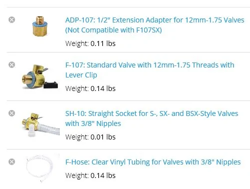

Just as an additional PSA for people reading this that aren't up on the Fumoto valve, you need the valve and the extension in order to install on the Ranger's recessed pan, afterwards, it's absolutely easy to drain the oil.
Are you running a drain tube off the valve? I'm really interested in running this setup. If anyone has a chance to get a picture of their setup I would appreciate it. Just curious how it looks.

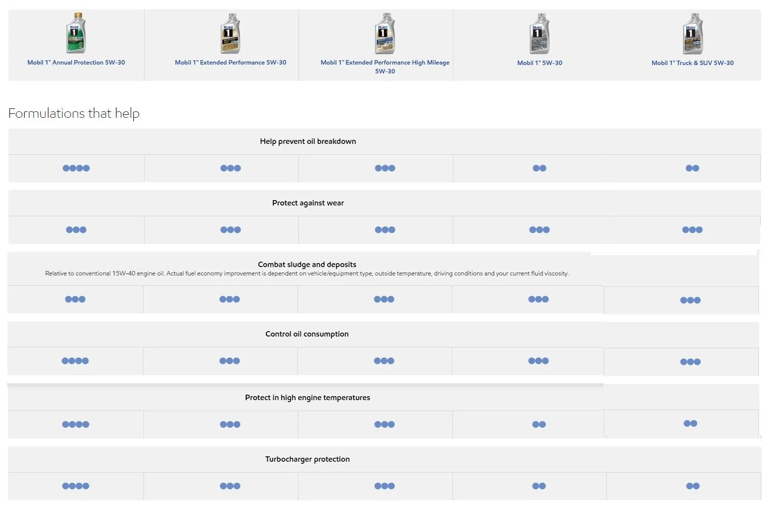

Something to consider.... Mobil 1 recommends Annual Protection Ultimate Full Synthetic SAE 5W-30 Motor Oil for our Rangers because of the turbocharger and related high temperatures,. Annual protection also has the lowest Noack Volatility rating (compared to the silver label, high mileage and truck/SUV oils), which is important for our direct injection gas engines.
Check it out at the Mobil 1 site... plug in 2019 Ford Ranger.. https://mobiloil.com/en/product-selector
I’m good, of course they recommend their most expensive oil for every reason. I’ve been using straight sn+ oil since it came out, if I were to switch now it would be penzoil platinum plus.
I appreciate the information though.

From what I can tell it looks like these are all the parts that I'll need to switch out to the Fumoto system. Is anyone using the 90° hose adapter from the drain?
