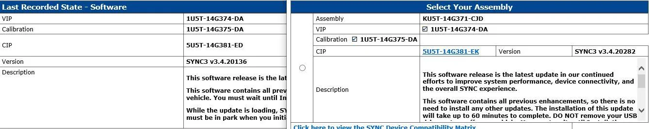

Just fyi - I was one of those that lost the climate icon when I upgraded to v3.4 Build 20136.
Looking in Oasis, Ford has since changed the As Built value at 7D0-04-01. Previously was 3480, now is 3400 to Enable Climate Domain
It must be the 8 that controls that - my asbuilt was 3380 and my "fixed" version is 3300.

Ford has pulled this latest update. No longer available in Oasis. Very frustrating.
My speculation is that in their effort to restore the missing climate icon, now the icon is appearing on lower trim vehicles that never had the icon and don't have the hardware to support this feature.
SSM 49408 - 2019 Ranger And Fusion - SYNC 3 - Climate Control Features Missing On The TouchScreen
Some 2019 Ranger and Fusion vehicles may have a symptom of the climate control features missing on the touch screen after updating the SYNC software. At this time it is not recommended to update the SYNC/APIM software on 2019 Ranger and Fusion vehicles. 'Additional Climate Options' will display without on-screen controls after updating the SYNC software. Engineering is currently working on a solution for this condition. Inform customers that Ford is developing a software fix that is expected in late January. In the interim, let the customer know that the climate control will still function with the standard control buttons on the dash and schedule a follow-up appointment with the customer for late January. Once the update becomes available, contact the customer and confirm the service appointment is going forward. Monitor OASIS for updates.

This is too much...
Once again Oasis shows Sync 3 v3.4 Build 20282 is available.
However, this time it is available for download on the Ford Owner site and I was able to download
