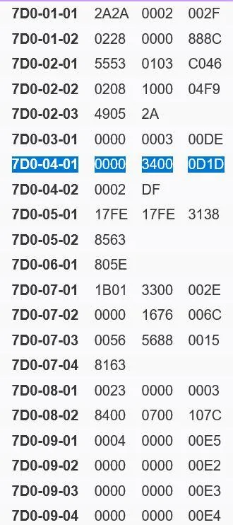

Just fyi - I was one of those that lost the climate icon when I upgraded to v3.4 Build 20136.
Looking in Oasis, Ford has since changed the As Built value at 7D0-04-01. Previously was 3480, now is 3400 to Enable Climate Domain
