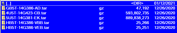

I updated my 2019 Lariat and had the same issue with no log file. Mine took about 30 minutes and then a message popped and said Restarting...and then another message popped up and said the update was complete, remove usb....before I could even read the rest of the message, the screen went dark. It stayed there for about3 or 4 minutes and I turned off the truck. After the restart, it took a while (another few minutes), but the screen turned on and I was at SYNC3 v3.4.20282.
After a 3rd restart, I got a message that said the system has been updated. I can run the Check for Updates and it now says my system is up to date. It never said anything before. The ford site still thinks I need the update, but like others already said, who cares.
The file the website built for my update looks like this
I only have 5 files in the syncmyride folder,
Mine now shows Gracenote Ver 1.1.1.2218 (NA-0020)
It doesn't look like the nav maps were updated. Mine still shows NA 117. Perhaps that is still the most recent?
When I hit the VR button, I get the chime, and it says Say A Command. If others say that has changed for NA trucks, then perhaps I did miss something??
After the update, XM radio had to update and things were a little slow for a few minutes.
So did I miss something with a missing 6th file?

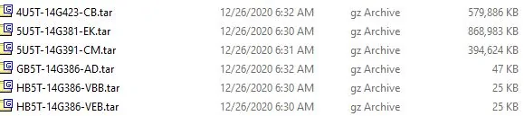

Yes - you are missing the updated NA Language Pack file 5U5T-14G391-CM
If you follow the procedure I posted in post # 209, you should be able to see the file name of the NA Language pack file you currently have installed. You most likely have CL or earlier. The CM file is a significant improvement over previous versions.
As UofMEngineer mentioned earlier, if you haven't reported to Ford the update has been installed, you should be able to re-download the update and the missing file "should" be included as Ford was correcting this error in the download. Then you can simply reinstall the update and only the missing file(s) will be installed. Another option would be to download the update for another VIN # that has all 6 files, then reinstall the update - refer to post # 206.
If using the VIN # from another vehicle to download the update, just be sure in your case, the vehicle is equipped with Navigation.

Try re-downloading the update. I was told this had been fixed...
I just re-downloaded it a few mins ago and I still only get 5 files. I'm missing the 5UST-14G391-CM.tar file
I just downloaded again, Ford has not corrected the problem.

I just downloaded for the VIN that @UofMEngineer posted earlier and got a new zip that included all 6 files. The other 5 are identical in size to what I got - it just includes the 5UST-14G391-CM.tar file in it.
@UofMEngineer - if I want to install this, do I need to update the autoinstall.lst file with this additional file? It does appear in the autoinstall.lst file in the new zip. I thought I had remembered you saying we just needed to add it to the SyncMyRide folder and it would get picked up but I wanted to confirm.
I'm wondering if this is why it keeps telling me there is an update available - because this file isn't updated?
If all files are the same, you can just use the other autointall.lst / entire package instead. Even quicker than editing. Put the -CM file in SyncMyRide, copy that, go. No idea why the system keeps saying one is available though.
Yeah, this is happening to me, too.
Not sure why I didn't get notifications about recent posts in this thread, so I missed the early talk about the CM file being missing. But mine definitely didn't include it. I re-downloaded today (Ford site still says I have an update available) and while there are some file size differences between the new download and what I installed before, I still got the same number of files and I'm still missing the CM file.
For me, all the other files were exactly the same (names and sizes) as what I downloaded over a week ago. It was just missing the one file.
My theory on why it keeps telling me that there is an update available is that although I've updated MOST of the files, since I didn't get that one file, it still thinks I need an upgrade (which I do). So whatever is creating the download package is out of sync with whatever is figuring out if you are up to date. It will be interesting to see if I get a "you are up to date" once I apply this last file.

Thanks for the help. Ford needs to clean this process up, very sloppy.
For the Map update to 119, I went to that site and all it offers is for me to buy a $40. flash drive with the new map files. Is there no way to just download for free? Do we have to pay the $40. each time they update the maps? I do not see any option to download.
As for the missing file, I went back and downloaded the zip file again, and again it only contained 5 files. I used the VIN from post 206 and it contains all 6 files.
I think this question has been answered, but I want to confirm before proceeding. Can I use the files from the vin from post 206, the entire set of files and try updating again? Or do I need to take the missing file from the other VIN and add that file to my set of files for my VIN?
@UofMEngineer - I have sent you PM with my VIN. Can you please check to see why Ford is not including the 6th file?
