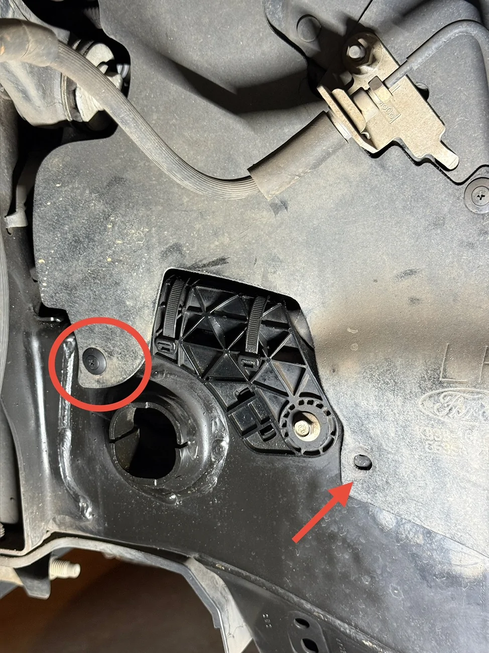

True, I was just in there yesterday attaching my splash shield correctly…Technician put the bottom left trim pin in the frame but forgot to actually put the pin through the splash shield first..😆
It does appear they lost the very bottom pin though…Ford Part W715694S300 if you ever need.
It is pretty tight in there and I’ll need to buy a new stubby screwdriver to get proper clearance, darn..(said no man ever 🤣 Snap-On SHDP22IRR here we come🫡)

You have to fix that. That missing pin will lead to harsh shifts, fuel in the oil and then one day your bedside will be too high. Even worse, there will be a dancing banana in the bed.

I’ll have to reason with the wife that I need a new tool and trim pin or else the engine could hydrolock driving in the rain. 🤣

I would highly recommend replacing those plastic fasteners with rivnuts and thumbscrews. Someone suggested it a few years ago and I did it and it is a lot easier to remove than those stupid plastic things. Other people have used magnets successfully.
Here are a few threads about it:
https://www.ranger5g.com/forum/threads/do-i-need-to-replace-this-part.37343/
https://www.ranger5g.com/forum/threads/oil-filter-access-modification.25526/
https://www.ranger5g.com/forum/threads/finally-did-my-own-oil-change.19229/post-402579
