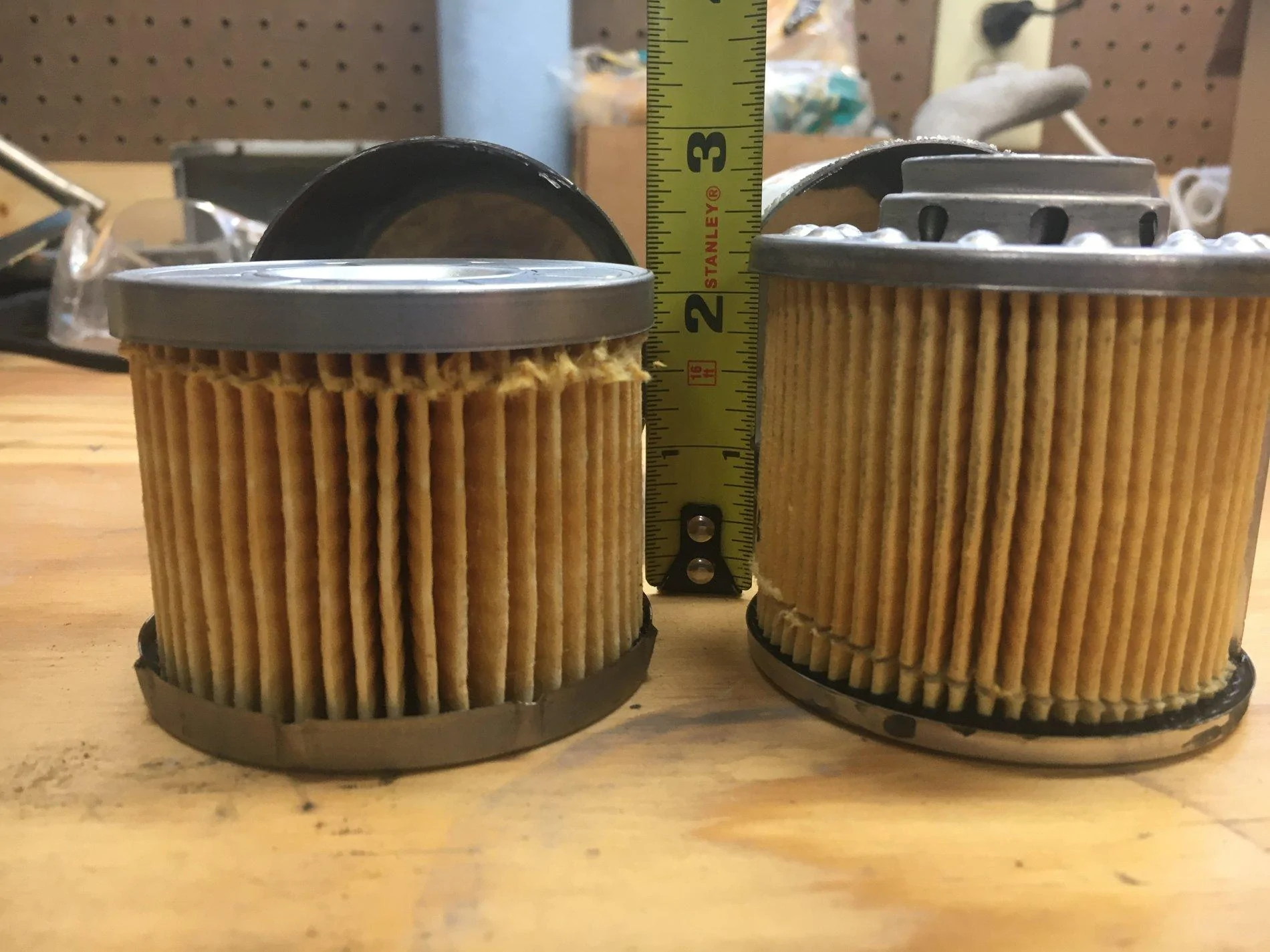

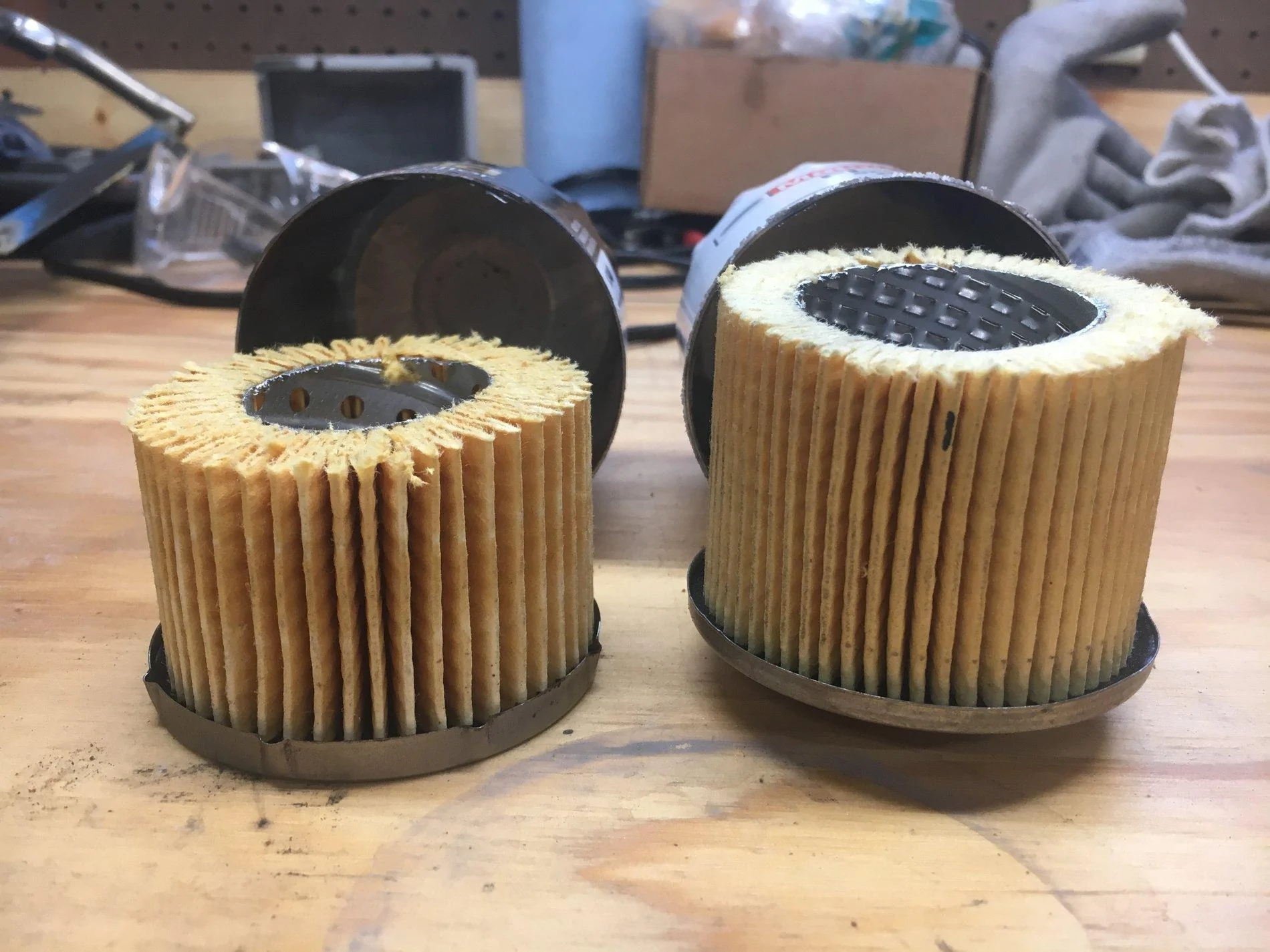

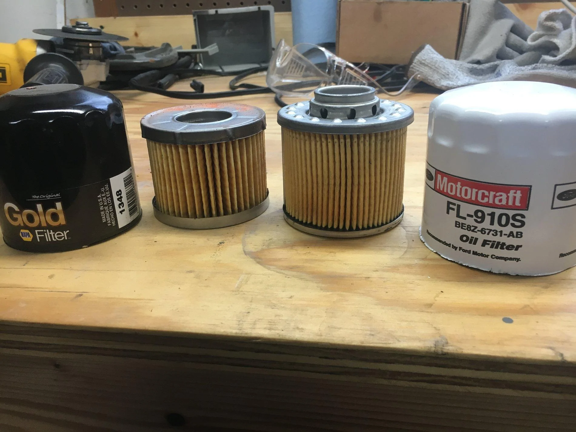

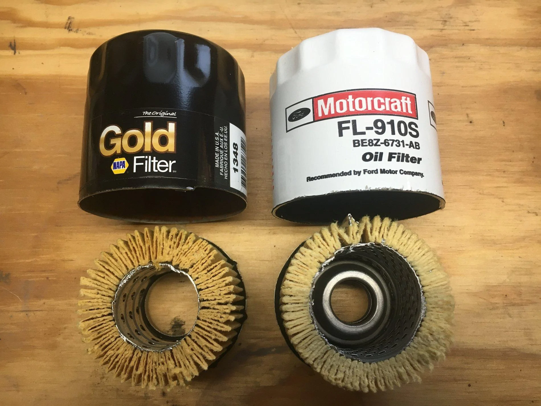

I went down this Wix vs Motorcraft road when I first got the truck. I almost posted these pictures but didn't want to start a war.
Tl;dr they're both perfectly acceptable but I'm using Wix
The Motorcraft is taller, so on first glance it looks like it has more filter media. However, the Wix pleats are deeper. I don't remember the calculations but the Wix had a significantly higher filter area by the square inch.
Not sure the deeper pleats is a good thing. Look at the center core diameter difference between the two filters.
In the videos they take out the paper element and pull it length wise.. then measure the length.
And the Motorcraft is longer, plus it's taller, thus more filter area.
Do you still have the two filters such that you could measure the filter elements extended lengths?
What I was describing was exactly what you’re suggesting, only measured a different way. If I had pulled them out flat, the Wix would have had more material.

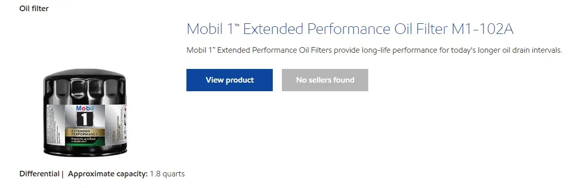

I'm using the Mobil 1 equivalent of the FL400s because I get them buy one get one free, or with $10 off my oil purchase making them really close in price to the FL400s. I had already acquired about 5 FL5400s (for my Focus ST) filters on clearance for 1.99 each, so I used those up first (I think I have one left) in rotation with my Mobil 1 filters. (I think the Mobil filter is a 201a or something like that)

https://www.mobil.com/en/lubricants...-us/wmi/recommendations/2019/54/696/14865/1/0

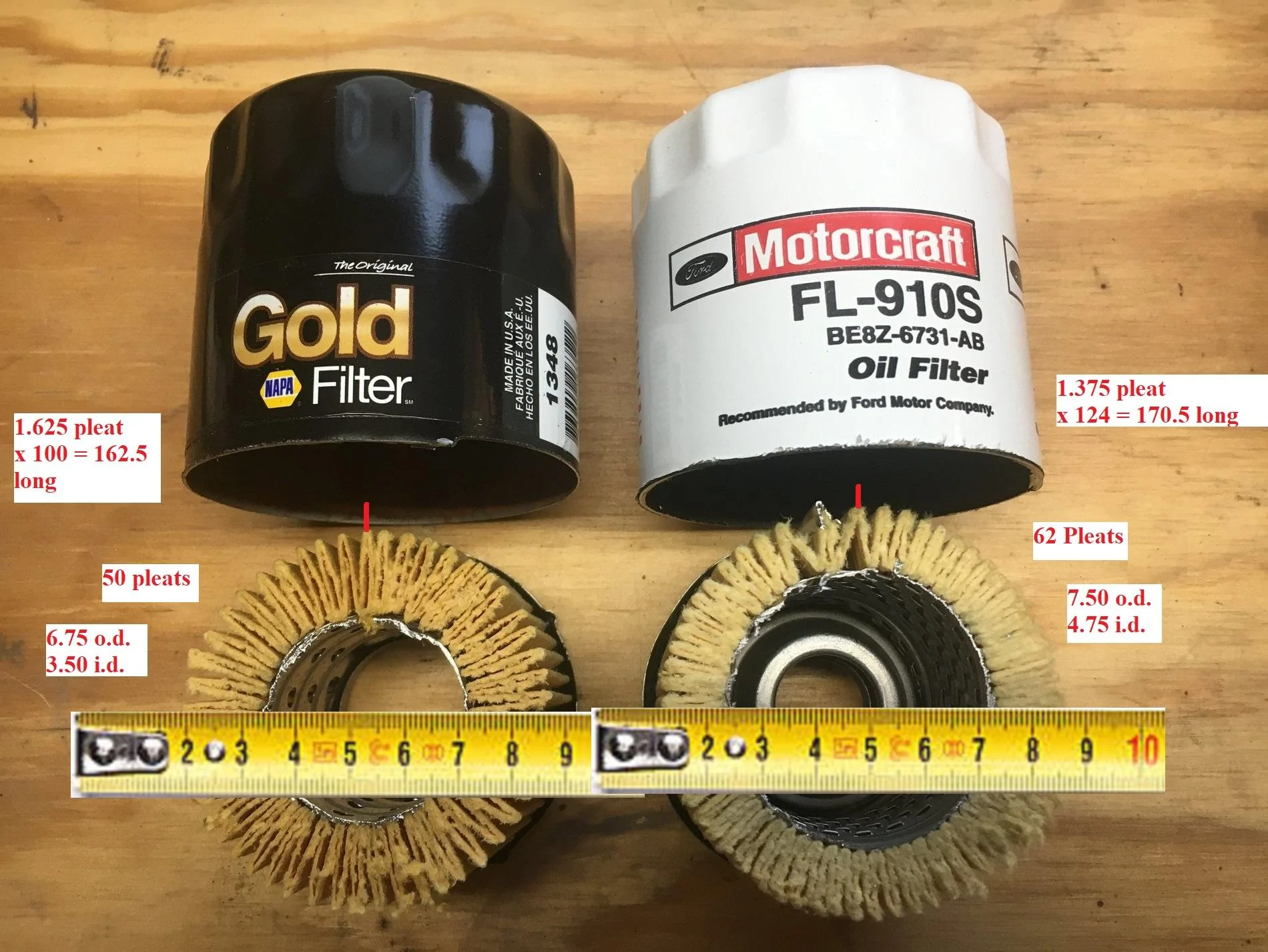

Did you take into account that the Motorcraft has 62 pleats, where the WIX has 50 pleats?
I guess I need to buy a couple of filters once my truck gets out of warranty.
Motorcraft has more pleats, and the o.d. is bigger and the filter element is taller. Taking some crude dimensions from your photo's (scale doesn't matter since the same scale was used for each) it appears the Motorcraft would have more filter media area?

@HenryMac I can't find them now, I think I probably pitched them. At any rate, I remember making the same assumption as you (Motorcraft is better) until I actually did the calculations, then the Wix came out on top. I got an A in geometry so I don't suspect that's the issue. Point is, we're splitting hairs here and like I said before, both are fine quality filters.

Take that paper out of the filter entirely, stretch it out, and do an area calculation on both. LxW. The one with more will have better filtering capacity.

no, that one has more surface area. unknown in that comparison is what they pass and how efficiently they pass it. just looking at the two it's seems that the ford filter material is thicker. that one also has more holes on a larger inside surface. they almost certainly won't behave identically, but do they behave "close enough"? I don't know, but I don't see a good reason not to just stick with the one ford says to use.

Surface area along with micron rating is what I was getting at. If they have comparable micron ratings, then generally the one with more area will be the better filtering device. I also like filters with metal inside vs plastic that you see in tons of other filters, so it's nice to see they both are comprised of metal parts.
