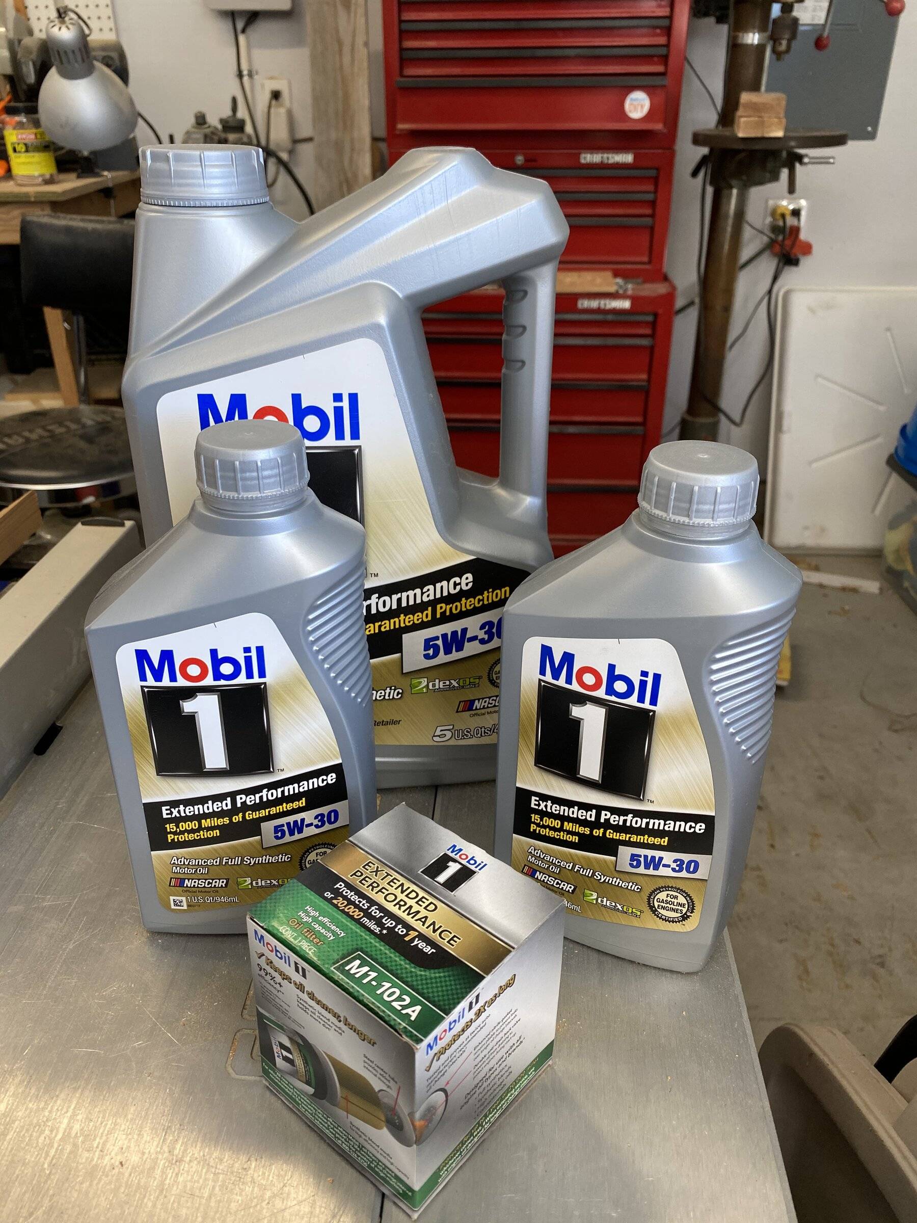

Eh, I'll beat the dead horse as well: My first oil change was at 2250 miles, and I used OEM filter and oil. Next one was at 5000 miles, and I switched to Mobil-1 Extended Performance filter and 5W-30 full synthetic oil, and will use that every 5000 miles for the life of the truck.

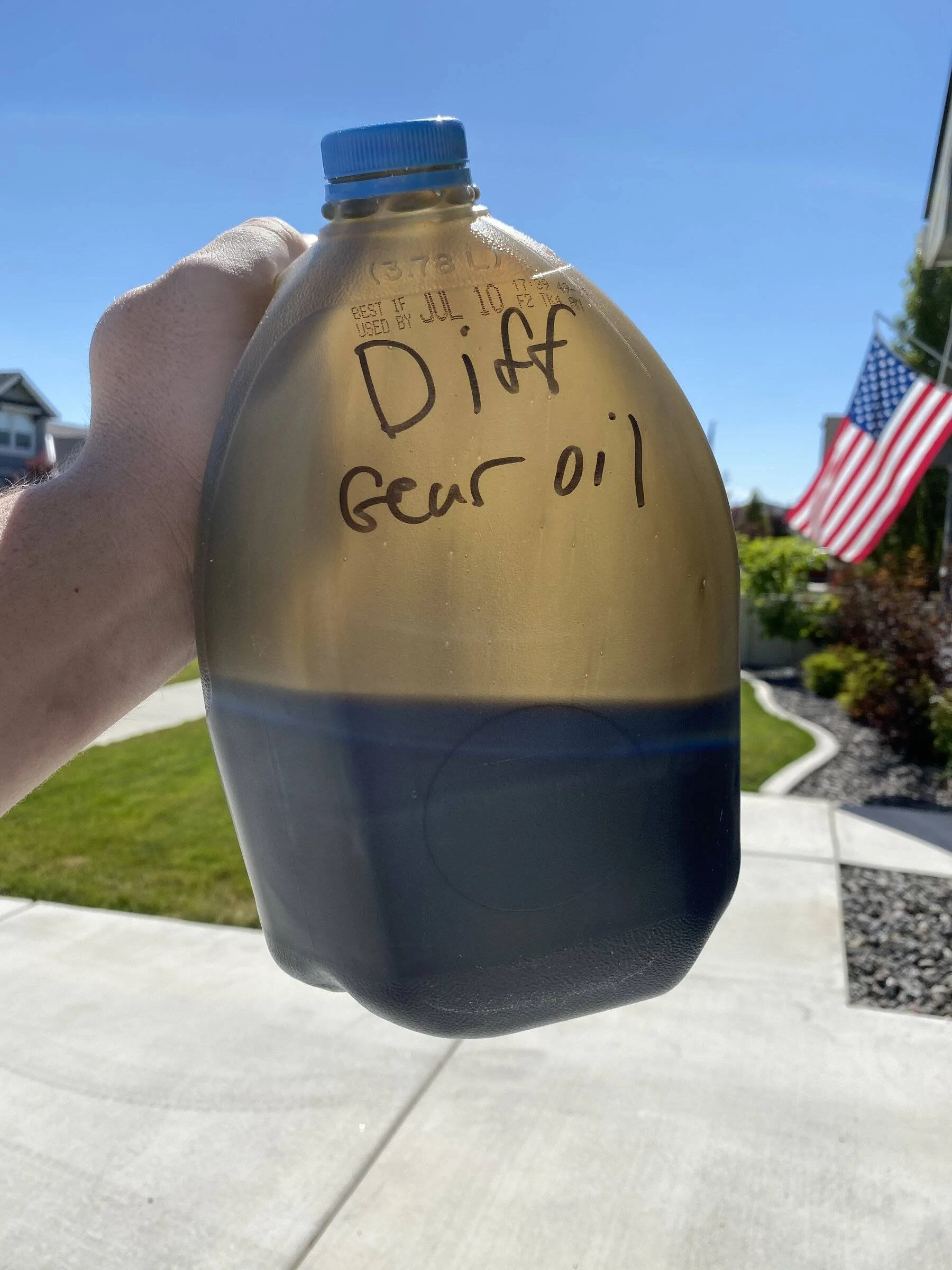

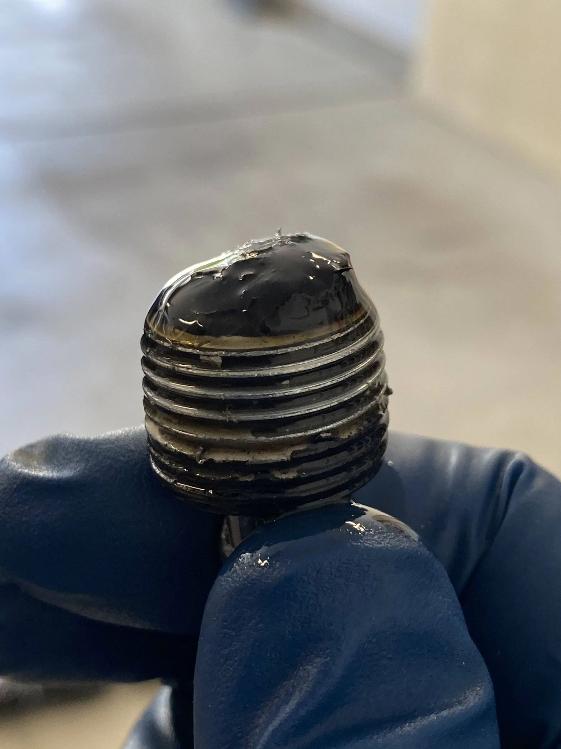

Since it has also been briefly discussed: at 2500 miles I also changed the front and rear diff oil as well as the transfer case fluid. I have not touched the transmission fluid. I used Amsoil Severe Gear 80w90 Synthetic oil in the diffs, and Motocraft Mercon LV in the transfer case. The rear diff fluid from the factory was already pretty dark, and there was a small amount of metal on the magnet. The front diff fluid looked much better (I only had maybe 100 miles of 4WD on it by then, though). Transfer case fluid also looked good.
Here is the drain plug from my rear diff, at 2500 miles. It's magnetic, and all that build up is metal shavings from the gears wearing in:
Here is the factory fluid I drained from my rear diff at 2500 miles:

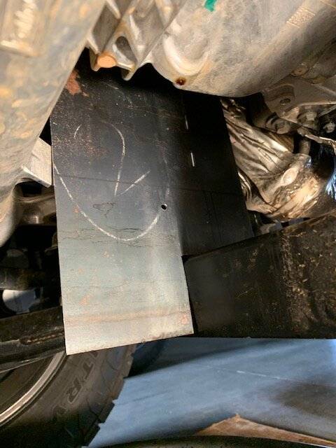

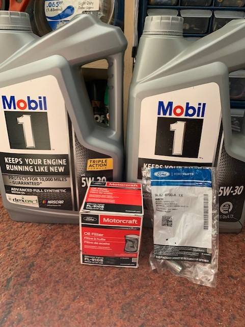

I just use Mobil 1 and a motorcraft filter.. Also made a deflector to save a mess to clean from the drain plug..
