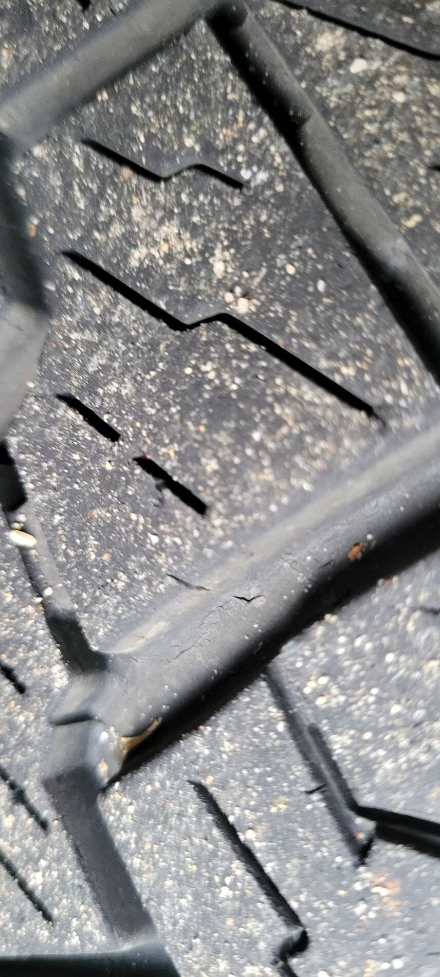

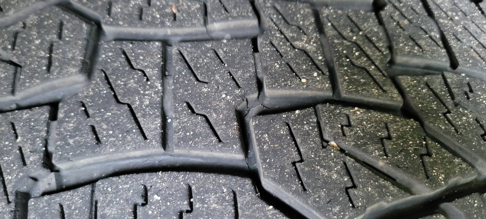

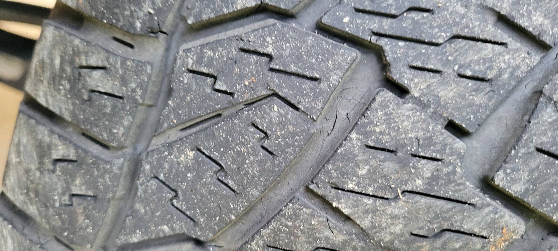

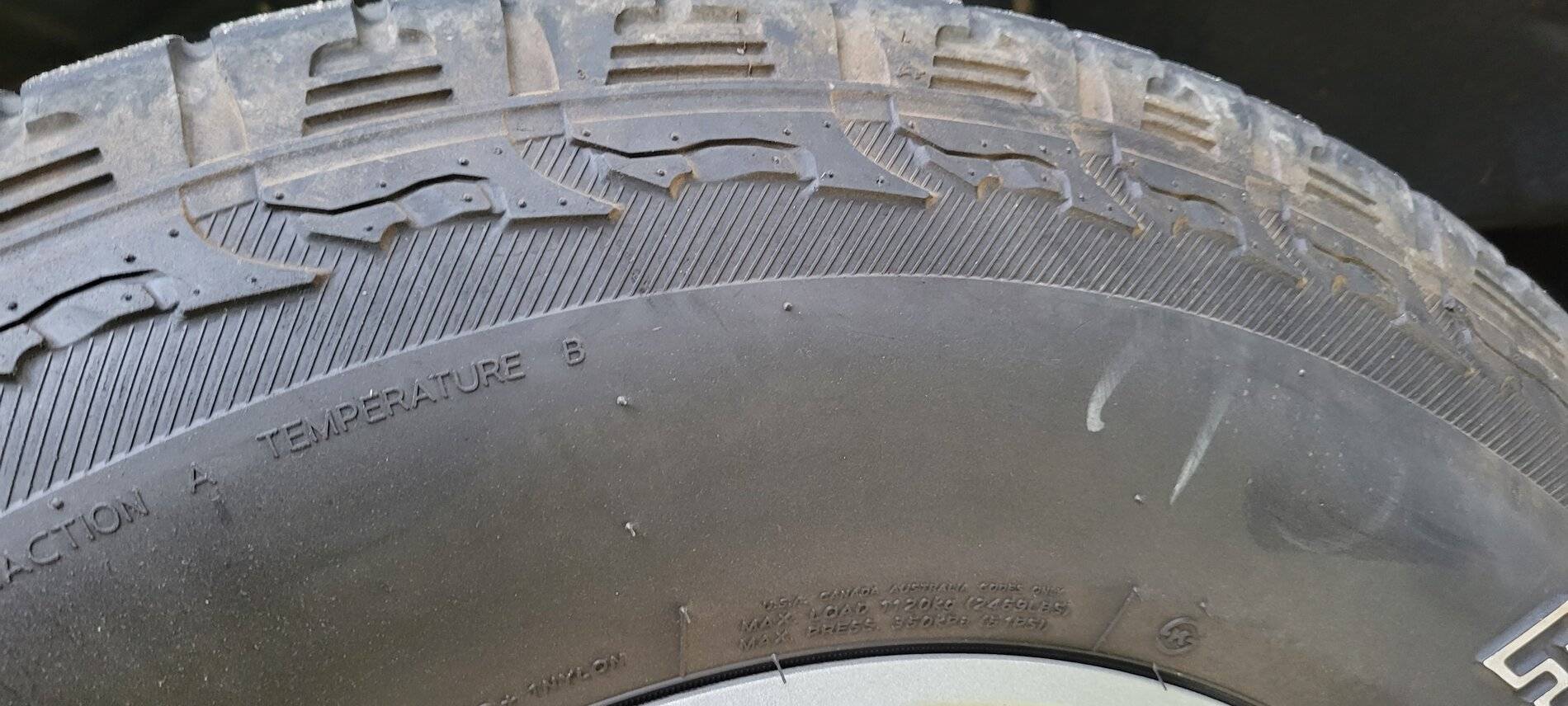

I just went out and checked the air pressure in my tires ahead of a trip I've got coming up and I saw these cracks in the tread. The cracking is kind of uniform throughout al of the tread and tires. Sidewalls look good. Stock Duratrac FX4 tires.

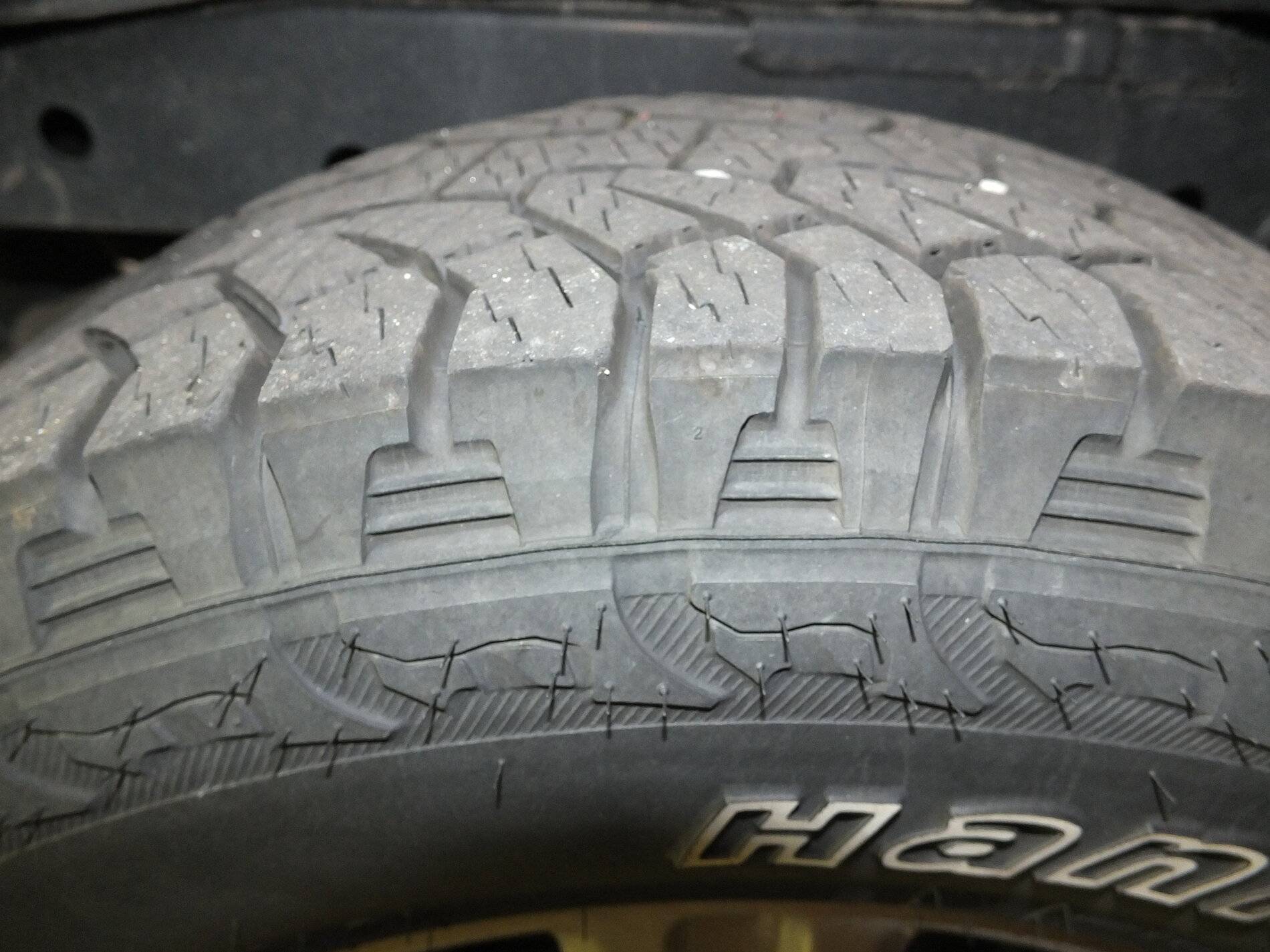

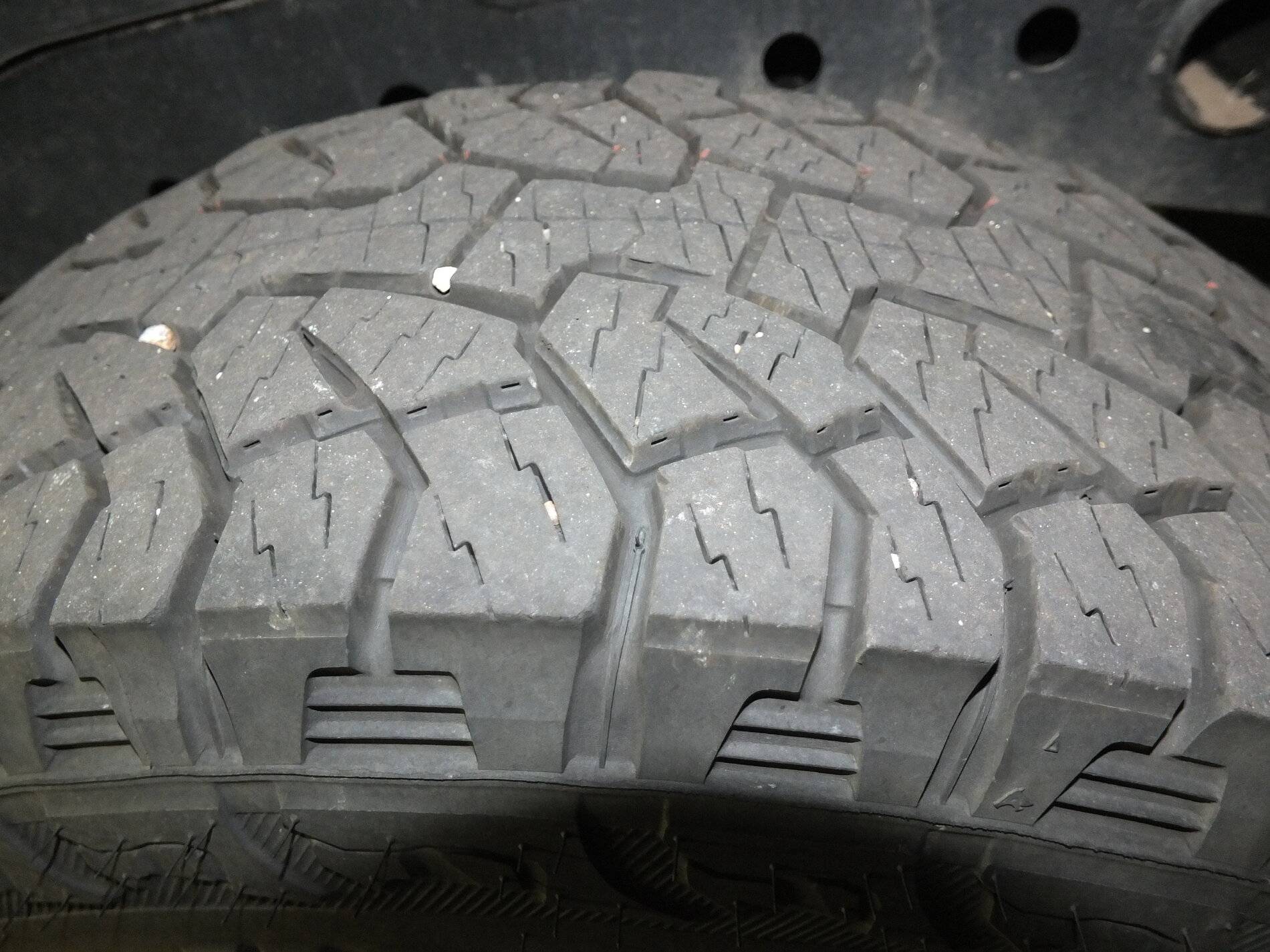

As @ATGC mentioned, those aren't Duratracs, they are Dynapro Hankooks.
Here are some photo's of the Hankooks on our Ranger that has 17,000 miles. No cracking at all like your tires have.

I found this for you. Most likely too late. That said, They are tiny cracks. Just go to work and bring it to a tire shop ASAP. I' sure they have been there for a while now so the chances of an immediate blow out is small (IMHO)
What Causes Tires to Crack in the Tread?
While tire sidewall cracks are more common and unavoidable, cracks in tire tread are a potentially urgent concern that drivers need to address. In most cases, a crack in the tire tread develops first on the sidewall, and then moves to the outer part of the tire, going underneath the tread. Tire tread cracks can also indicate dry rot underneath the tread that could lead to the tread blowing off the wheel entirely, which can put the vehicle at risk of losing control on the road.
Cracks in your tire treads need to be examined immediately. Given the thickness of this part of the tire, the crack likely indicates an underlying structural issue that could put the driver and other vehicles in danger.

Yeah. I don't know why I typed Duratracs - I was shopping those for replace tires. I have the Hankook Dynopros.
I think my last off-roading trip is what caused the issue. There was a very long length of trail that was shale, and I only aired down 10 lbs. My tires were actually over inflated at the time to 35 lbs. So they only got aired down the 25 lbs. on the trail. I'm thinking that shale was rough on the not-aired-down-enough tires.
I'm going to drive the Ranger up to work today and get one of my friends at Fleet Services to look at it and give me a pass or fail.
When I saw the potential issue last night I went into panic mode because I pretty much knew there isn't time to get this fixed. No-one has tires in stock for same day installation!
This is my opportunity to get 27570R17 tires installed when I get back though!
I've got about. 25" of tread on these and I'm still above the wear bars.

I think they look fine. Those look like battle scars and not tread separation. But as a service advisor, I’m suggesting 4 new 275/70R17 tires just in case. ?

For short term your tires maybe safe, but for long term no.
A look at your tires indicates that they maybe dying to old age. If that is the case they most likely will not blow up in short term, but their ability to stick to the road and stop is already degraded.
You can check the age from DOT mark. Usually 5-7 years (+2 year shelf life) is enough for any tire.

On the plus side, the fleet manager where I work says send it. He said my tires are nearing the end of their service life but the cracking is not deep and the tires have some miles left to them, but not much.
