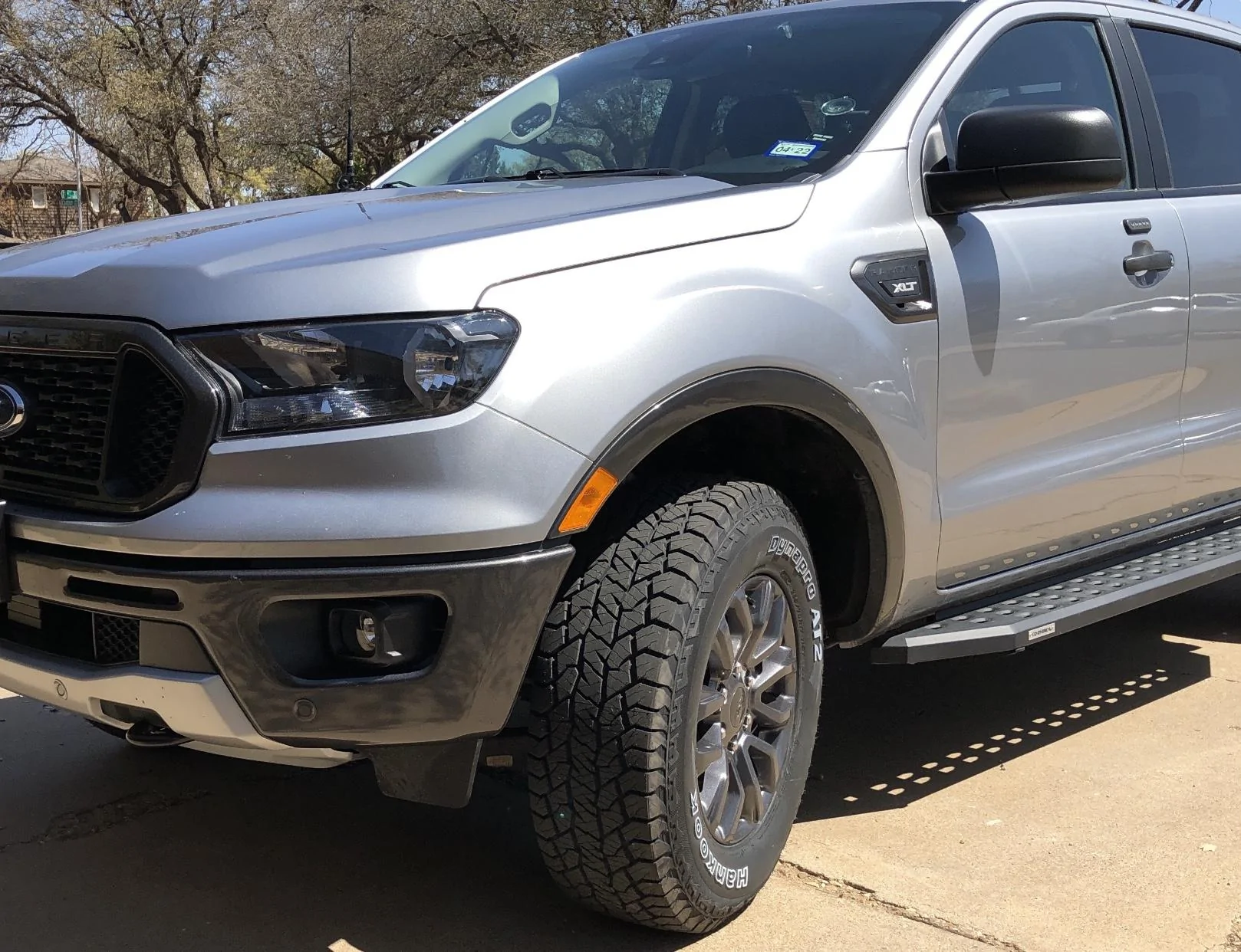

But my wife will notice the scorpions. If you want to increase the diameter of your FX4’s stock Hankook Dynapro ATM LT265/65R17 you can install 265/70R17 Hankook Dynapro AT2 and your wife will not even notice.
Of course no one else will notice either, but they are 5 lbs light than stock and have a MUCH smoother ride.

Hi John, I am debating whether to replace my Standard Load Hankook ATM with the newer Hankook AT2. I do love my current ride with the ATM. Please provide some feedback on your AT2. Current mileage on them? Comfort? Noise? Wear? Traction? Etc? Thanks.
If you like the ATM, then by all means keep them. I like my ATM also, but they were Light Truck tires and rode rough, and the replacement AT2 are one size larger and standard load, so they have a more comfortable ride.

Thanks. Yes I plan to keep my SL Hankook ATM Pro until it’s time to replace them. I am just looking ahead. How many miles do you have on your AT2? How is the wear? Traction in rain, snow?
Brand new. Maybe 300 miles. All I can tell you is they are quieter and that is saying something since I thought the ATM was quiet.
