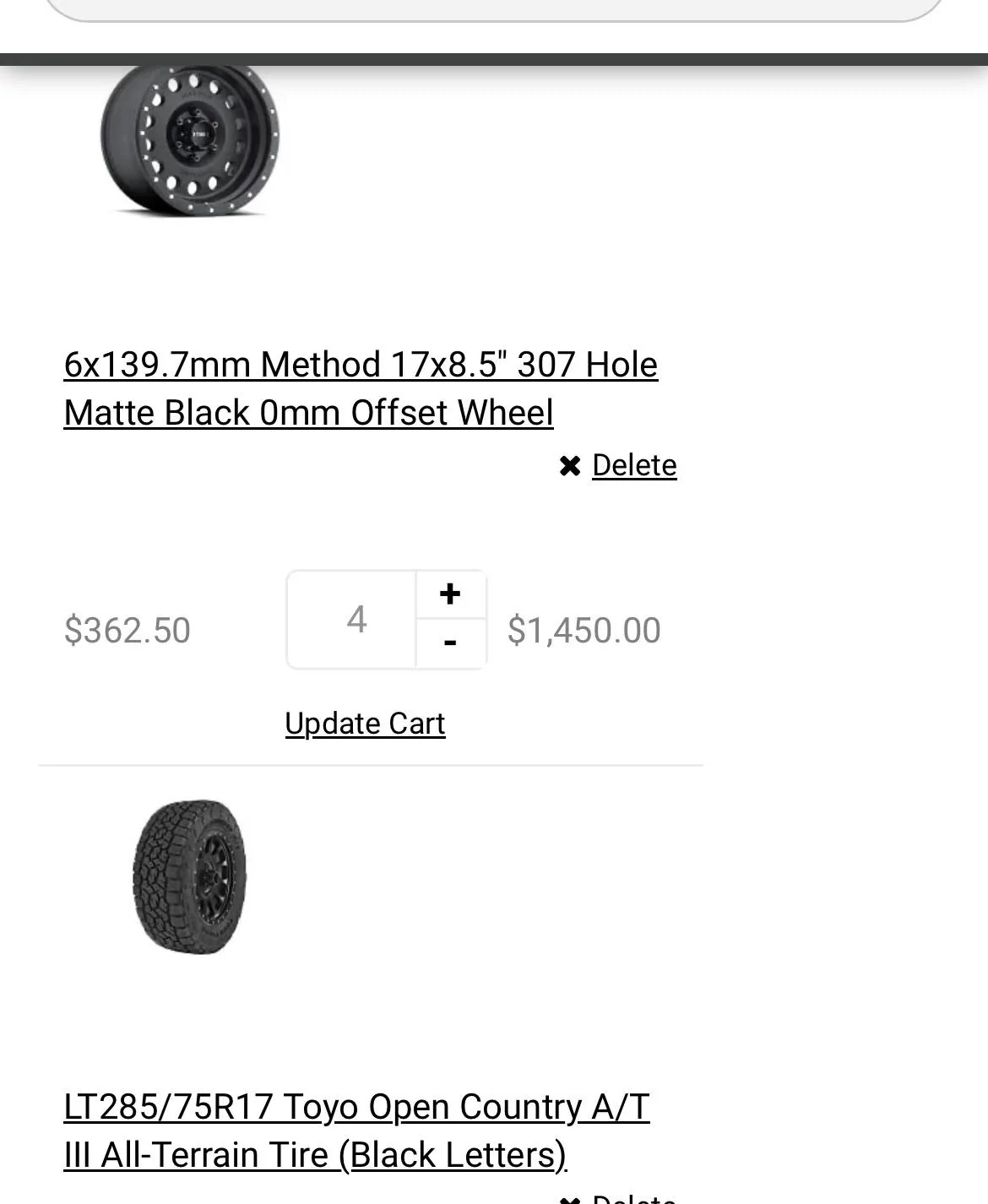

I stumbled upon this thread and hoping maybe someone might take the time to enlighten me on weather this will be a go and what offset would be best for the Method Wheels I want to go with. I’m trying to find a tire that fits closer to a 34”. Most seem to be a realistic 33.3”-33.8” height. Anyone willing to shed some light on potential rubbing or if I need to alter the wheel specs? I of course will be doing the extrusion bar chop. First Ranger to lift, unfortunately all my knowledge is on Tacomas and what works for them.
I ordered the Icon Stage 8 lift for my ‘22 Ranger,RCI full body skid plates, rock sliders, etc.. Just needing to clarify what my realistic options will be for the wheel/tire combo.
Thanks!

Given the lift you mentioned, the wheel size and offset is perfect. The 285/75R17 in the Toyo will be pretty close to 34". Toyo's website has it coming in at 33.9 inches on an 8" wide wheel, so you're close!
Product is available for ordering. I'd love to help. Sending a DM your way.
