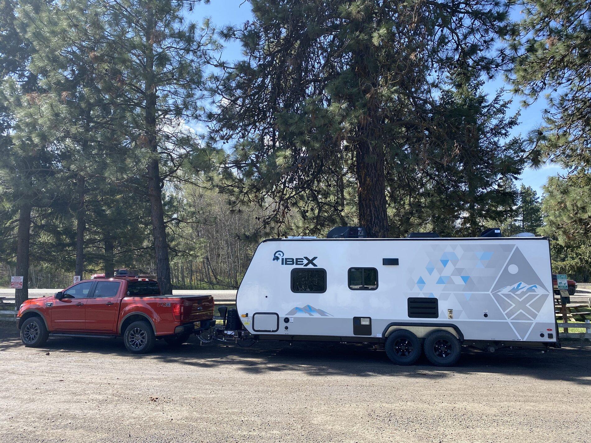

Lots of nice looking rig combos out there!
What kind of MPG is everyone averaging? We got 10-11 mpg and travelled 600+ miles over 2 large passes, and the only issue is the size of the gas tank.
We have an IBEX 19MBH Dry weight is 4261, (per manufacture sticker). Length is 24ft bumper to hitch. We have a Blue Ox Sway Pro WDH w/750lbs bars. We had an RV repair shop install some cameras and they had a tongue weigh of 580lbs with some gear (since then I added a few things to the front compartment). We took it out for our first trip and it towed very well after a few stops for fine tuning for the WDH. Over the 2 large passes we had no issues 50-55mph. Flat lands we had about 20-30mph winds and I did feel some sway (not bad at all). Over all we average 60mph and when semis passed us there was no issues and felt less push/sway then when on flat lands.
CAT scale #s
Steer Axle 2620 (Max 3130)
Drive Axle 3340 (Max 3370)
Trailer Axel 4040 (Max 7000)
Total 10000 (Max 12500)
I’m very pleased with the set up, just wish we could have a larger gas tank.

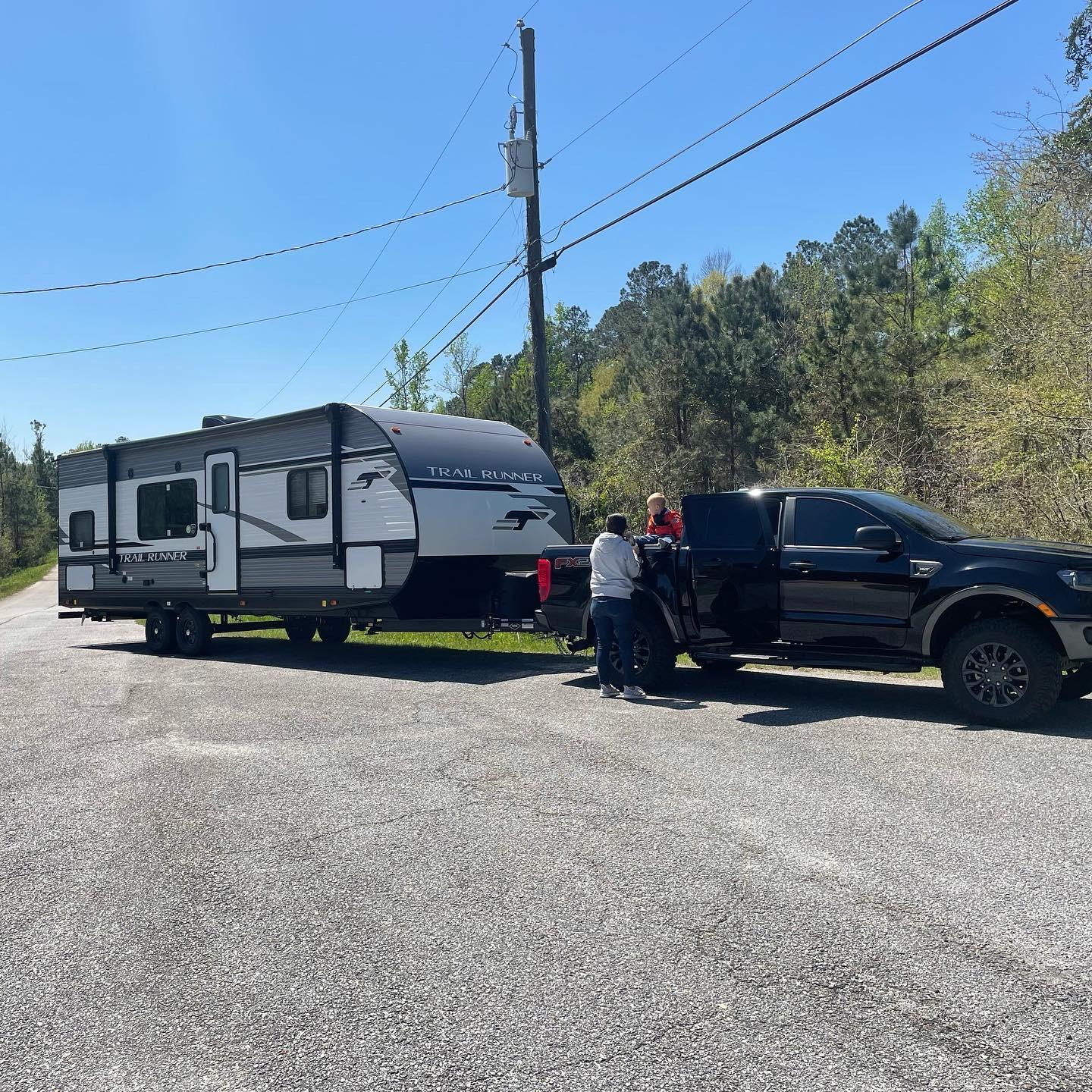

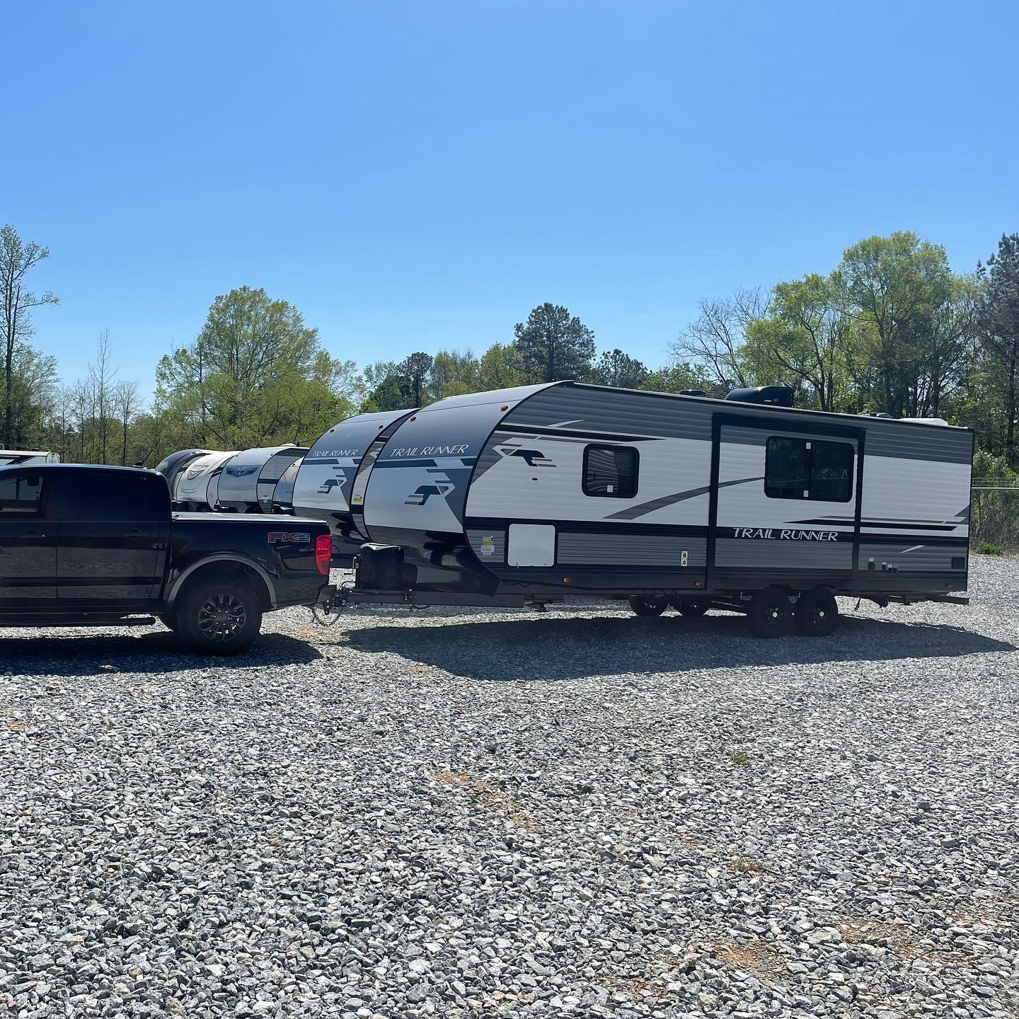

Picked up a 2021 Trail Runner 261BHS last weekend with a weight distribution hitch. It’s 30 feet 9 inches and 6000 dry. Haven’t pulled it but about 100 miles so far but no issues with the weight. The trailer brake gets installed by Ford tomorrow, I hope. It was supposed to be done today as I dropped it off at 9 and turned into a giant shit show at the dealer in Columbus Georgia. That’s a whole different story lol.

I noticed you truck maximum axle weights. They are different than mine.
I have 3130 max for the front and 3370 for the rear from the door sticker. I have crew cab FX4 too. Anyway, nice setup. :thumbsup:

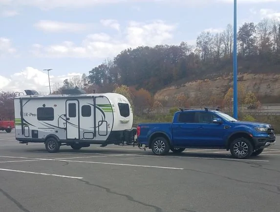

Ours is a 2020 E-Pro 19FD. It was about 3100 lbs dry and we are about 38 feet overall.
Very happy with our setup.
What brand is on the top of your truck? Model number? We want one like that for our Orange.

You are correct, good catch. I just went out side and checked my door sticker, 3130 front & 3370 rear, super close to my Max.
Thanks!
