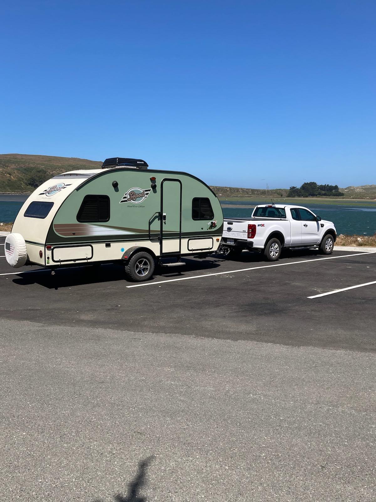

My first tow. Round trip Sacramento to Bodega Bay about 300 miles. Ran into 12 to 15 mph steady winds going there; a little sway and 12 mpg. No wind on way back and got 21 mpg; huge difference. Have a WDH without sway control.
Big Blue ... does your Centerline WDH have sway control, and what capacity hitch did you get ?? I'm think about getting a new hitch.

For your trailer, I would get an Equal-i-zer hitch - https://www.equalizerhitch.com/. The built in sway control with the Equal-i-zer hitch hitch is a step up from the basic friction sway control add-on that many RV dealers like to sell. If you were towing a larger trailer, then recommendation would be a Hensley or ProPride hitch.

Yes the Centerline TS does have built in 4 point sway control. I'm running the 400-800 pound bars, the lightest they make. I'm running about 475# tongue weight. The ranger really doesn't need weight distribution at that weight, still recommend. You definitely need sway control. Separate sway bars are a pain because you need to disconnect them to back up. I went with the Husky because it had the sway control and the bar range fit my tongue weight, you don't want bars that are too stiff.
I have done any long rows yet but plan to. Just some local camping so far. A few clunks when making tight turns and backing. So far I like it, no issues with semis passing at speed.
