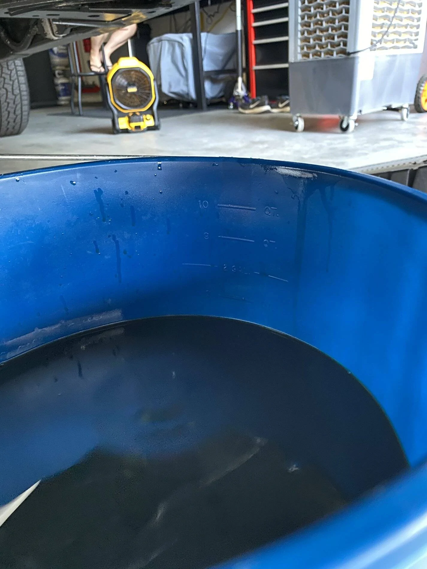

Well, I’m OCD so I did an oil change. Not including the oil in the filter, almost 7 quarts came out. Zoom in on the picture, you can see the measurement lines.

I'm still puzzled how you got the stick to look so full compared to that amount, though.
Interesting. Glad it's not as bad as it looked initially.
6qts and a cup brings mine to the full mark after run and settling.
I didn't post any pictures.

It calls for 6qts and a cup... so there ya go!
Agreed that is not even 6 and a half quarts, real close to correct.

judging by the lines, thats closer to 6 than it is 7.
to say "almost 7" isnt correct unless youre trying to convince yourself of a problem that doesnt exist.
save the oil for your lawnmower, i dont think its saturated with fuel.
for confirmation, send a sample to blackstone
I noticed that also. I was waiting for somebody to say it clearly to confirm what I was seeing.
