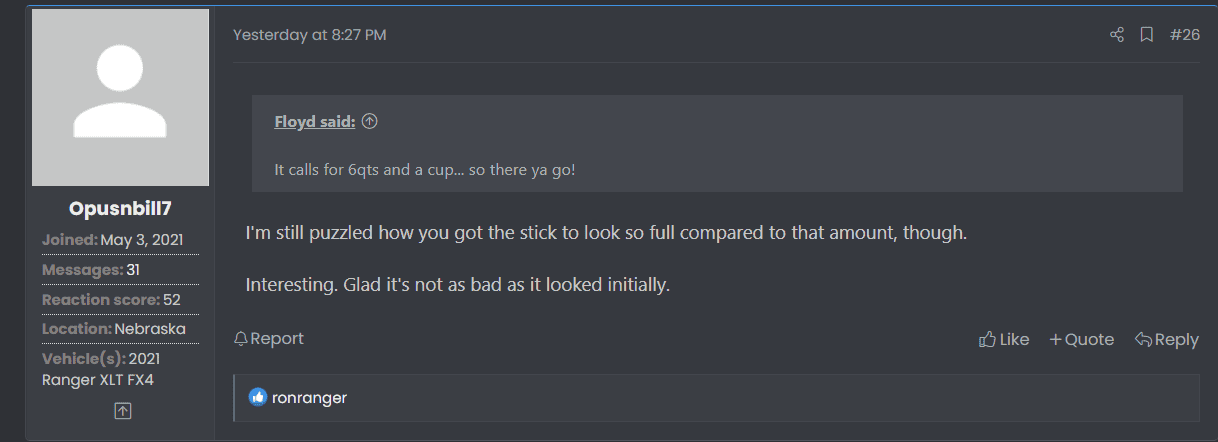

Well, I’m OCD so I did an oil change. Not including the oil in the filter, almost 7 quarts came out. Zoom in on the picture, you can see the measurement lines.
As noted by others, it looks like you pulled less than 6.5 qts. To my eye looks like a hair over 6 qts. I'd say you're in good shape and can now go on your trip with good peace of mind knowing that your engine isn't going to fail at any moment from an overfilled crankcase, nor is your engine mysteriously creating copious amounts of fluid.
Now that you've changed it, how much oil did you put in it and how does the level look? If it still looks super high, I'm guessing you must be somehow picking up residue from the sides of the dipstick tube as you're pulling it out. If you continue to have issues with it, just drop by the dealership sometime and ask them what the trick is to avoiding it. Sure you may feel a little stupid asking how to check a dipstick, but it sure beats never being confident in your reading!

Yup that was after pulling the stick, wiping it, checking it, and repeating the process 3 times. The engine was cold, I let it idle for maybe 1 minute, shut it off then checked it. It idled maybe 1 minute max from cold before I checked it.
These engines are different than any other vehicle I've owned when it comes to checking oil. The truck either needs to literally sit overnight (or at least several hours) to get a good reading off the dipstick, or if you pull the dipstick the oil settles faster and you can get a good reading after about 15 minutes of being off. Don't idle it right before checking, or you will never get a reading, the whole dipstick will just be covered in oil.

I was going say check at proper running temperature. Oil expands when it’s hot. When I change my oil , I’ll fill it 3/4 on the dipstick or just shy of, take it for a good run so it gets nice and hot then recheck it. Usually it just needs a little too up afterwards. Thankfully I haven’t had any issues like this. 25,000km on it now.
Think of it this way, your car or truck isn’t cold when you take it to a quick lube. Hope you get it figured out.?

6qts and a cup brings mine to the full mark after run and settling.
I didn't post any pictures.
I was referring to the pictures at the beginning of the thread where the OP was showing oil clear up to the "twist", but thanks.
Opusnbill7
May 3, 2021
80
176
Nebraska
2021 Ranger XLT FX4
you quoted Floyd though.....so thanks??
I was replying to Floyd because he listed the actual amount that he should have had. The OP had posted a stick with a lot more oil on it than should have been there. Try to keep up. ?
