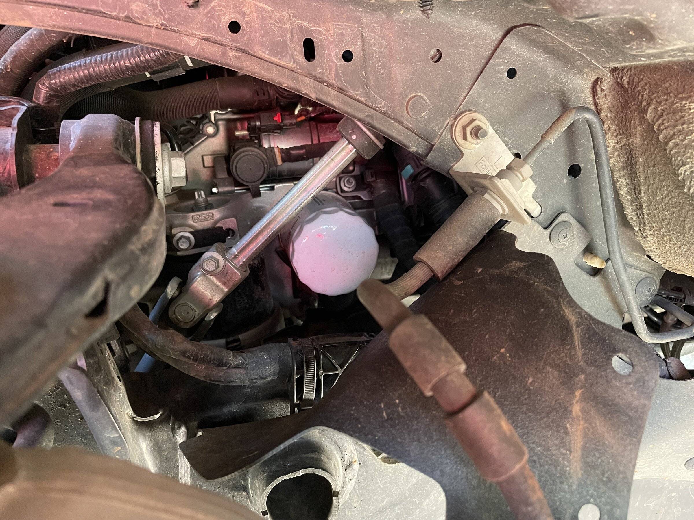

Go Now and get the oil filter wrench. As some have mentioned, the filters are apparently installed by a roided up gorilla with a SnapOn impact gun. Supposed to be a 76mm with 14 flutes. I will confirm this after I get one. Edit: Confirmed.
The drain plug was very tight too (15mm)

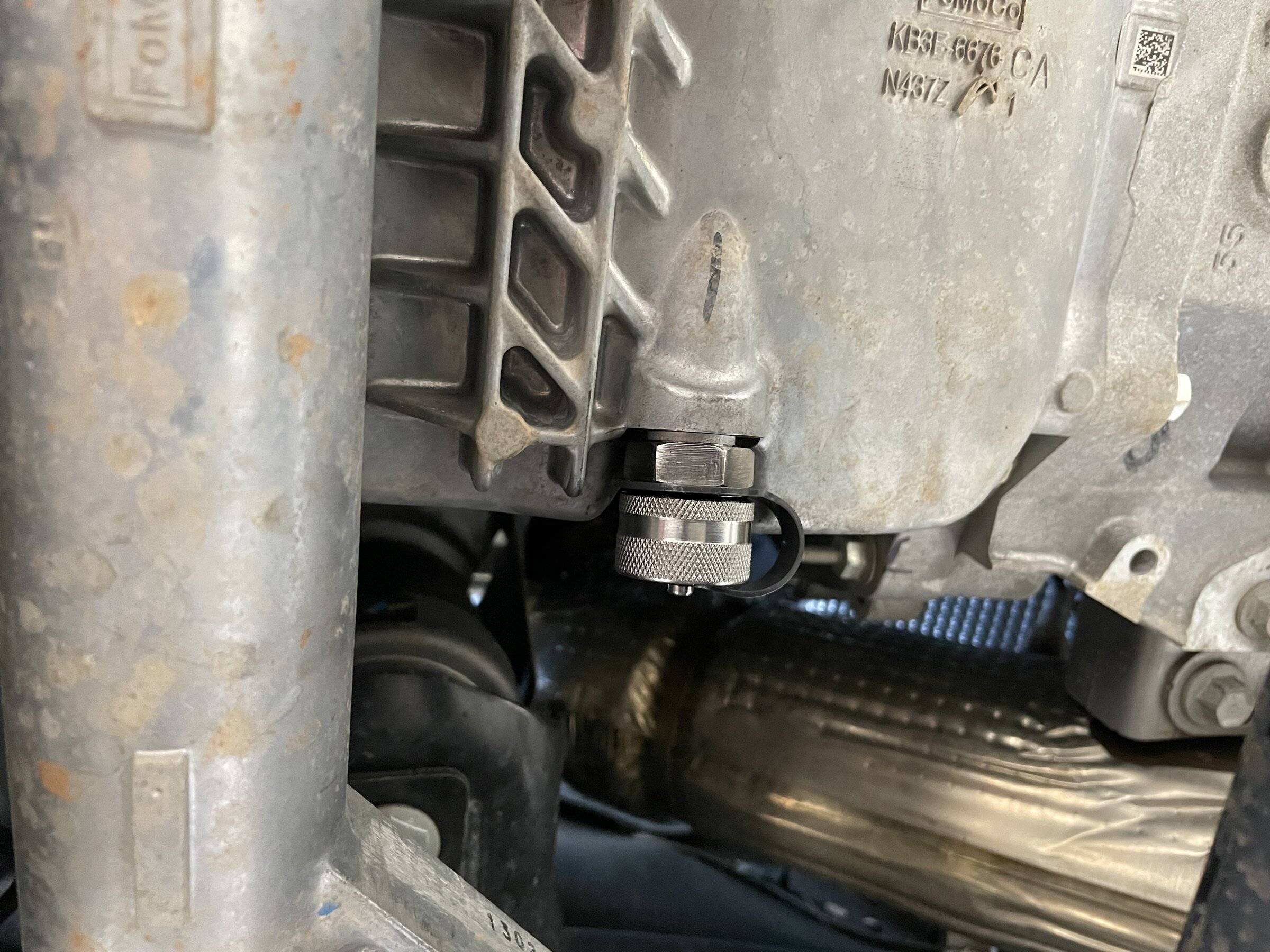

I installed my ValvoMax so the next change should be much easier.
With the ValvoMax, I won't have to loosen/drop the skidplate (all skidplate bolts are 15mm).
The filter was surprisingly easy to get to, maybe because my truck is leveled?
I didn't have to turn the wheels for access.
Remove 3 of the plastic retainers and move the flap to access.

Great write up. I've been doing my own since day one. Never trusted the dealership. Thanks for posting pictures of the ValvoMax. I actually have one too waiting for my next oil change so I can install, and was wondering what it looks like installed.

That valvomax looks pretty neat. I went with the Fumoto and while I don't need to remove the skidplate anymore the oil drain takes forever.
Confirmed 76mm and 14 flutes.

Definitely be carefully with the quick drain. There have already been some reports with the Fumitomo one getting cought during OffRoad use(might have been a Toyota but still a risk). As for the oil, ues the spec is 6.2 but you can get away with 6 qts
