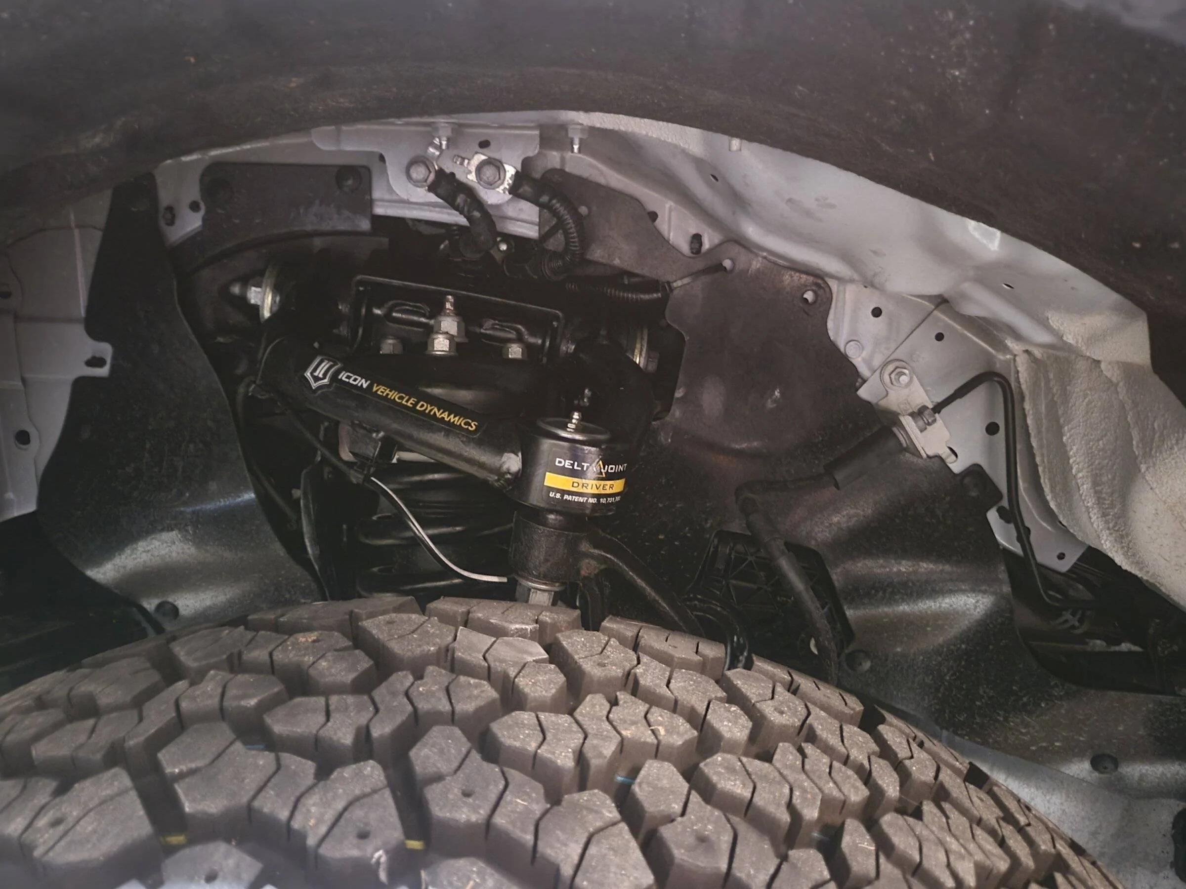

Someone just posted on another thread...looks like the 22s come with 10mm bolts now. I guess you are ahead of your time ;) :clap: Thanks for posting the pics :like:
Thanks, but I still like the thumbscrews better, no hunting for a 10mm socket :)

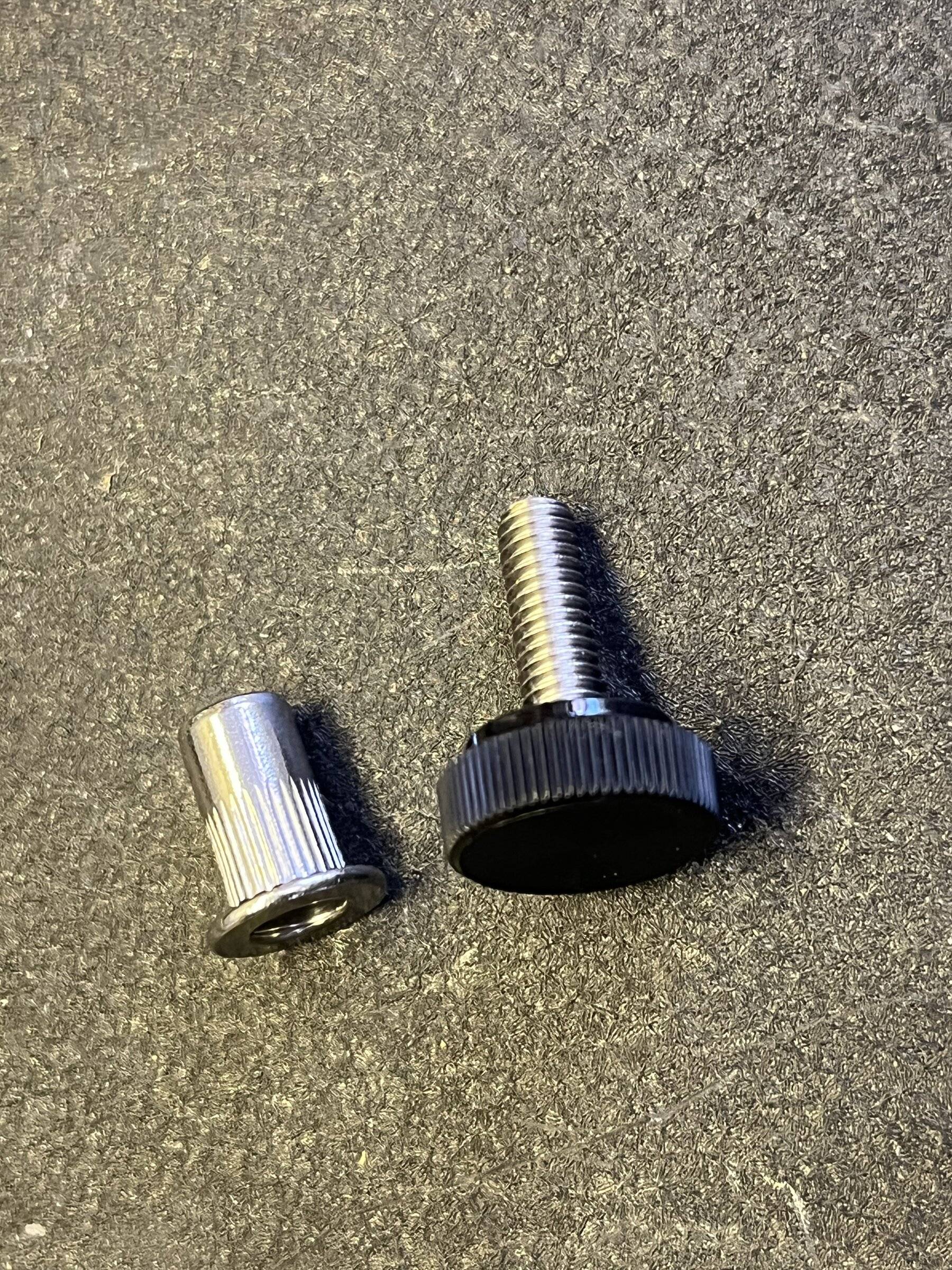

Please indicate what length thumb screws
Ah... the rivet nuts are 11mm long, so the 12 MM would be perfect and not stick out the back. But there is plenty of space behind the fender well so the 18mm will work as long as you don't get JB weld in the end of the nut (stick a small plug in it, then the screw will push it out)

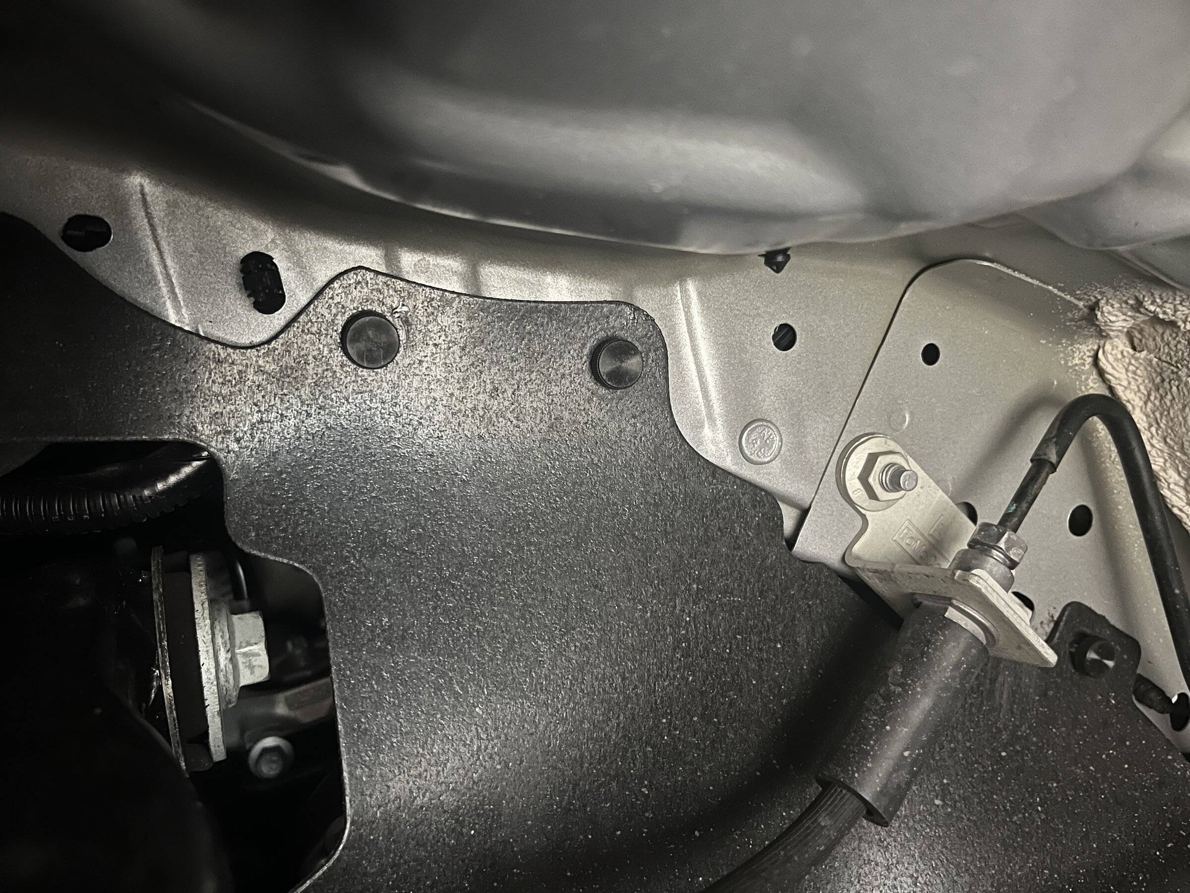

I use zip ties for the oil filter flap. Super easy.
That works, but carry extras in case you need to have the oil changed on the road :), The zip ties are a nice contrast to the high end Icon suspension :LOL:

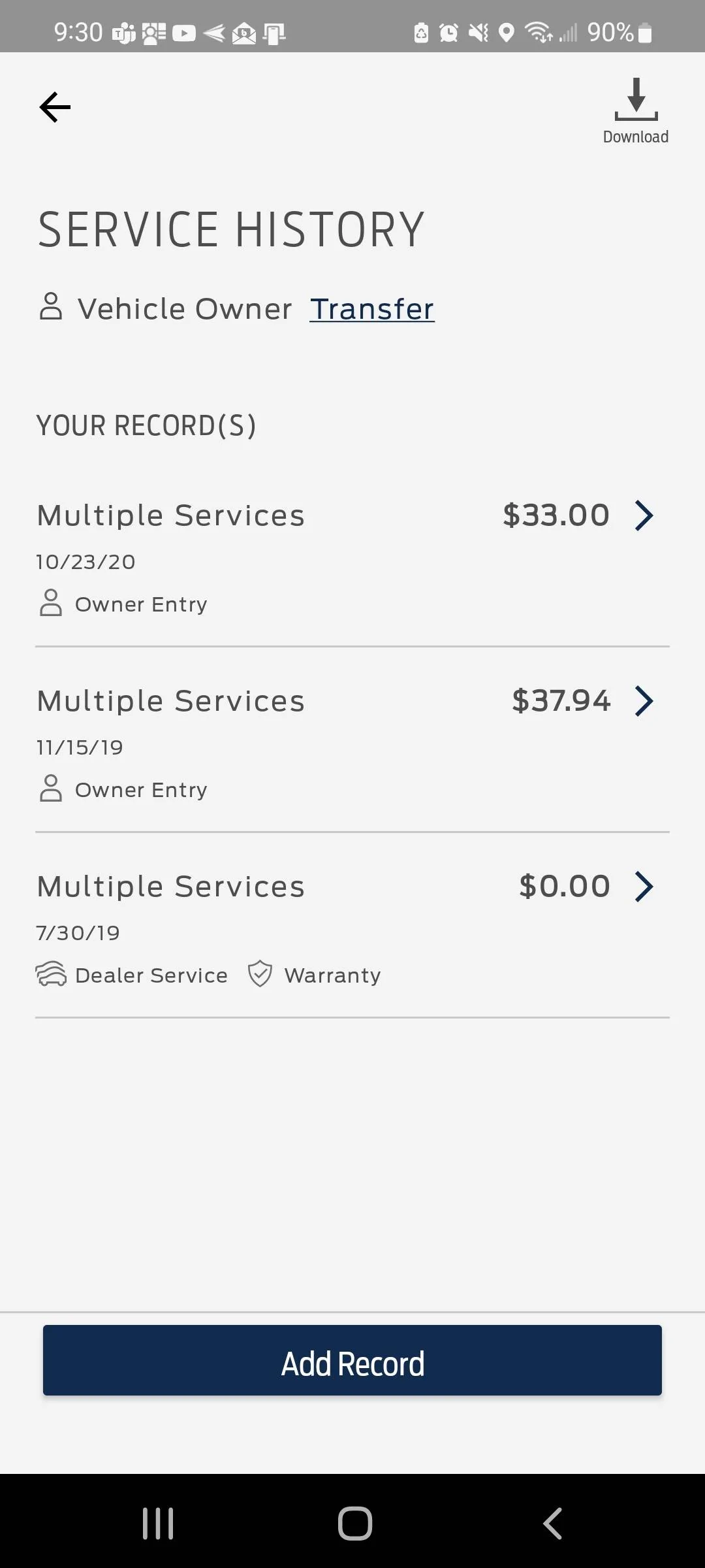

Has anyone been able to successfully add your own oil change?
I've tried to add this multiple times and I always get "Oops! Something went wrong adding your entry. Please refresh and try again later."
RedlandRanger
Nov 14, 2018
44
5,194
11,369
I have. It has been a while, but I've added two oil changes successfully - they both show "Owner Entry" - the other one was the warranty work to replace my mirror light that leaked:
