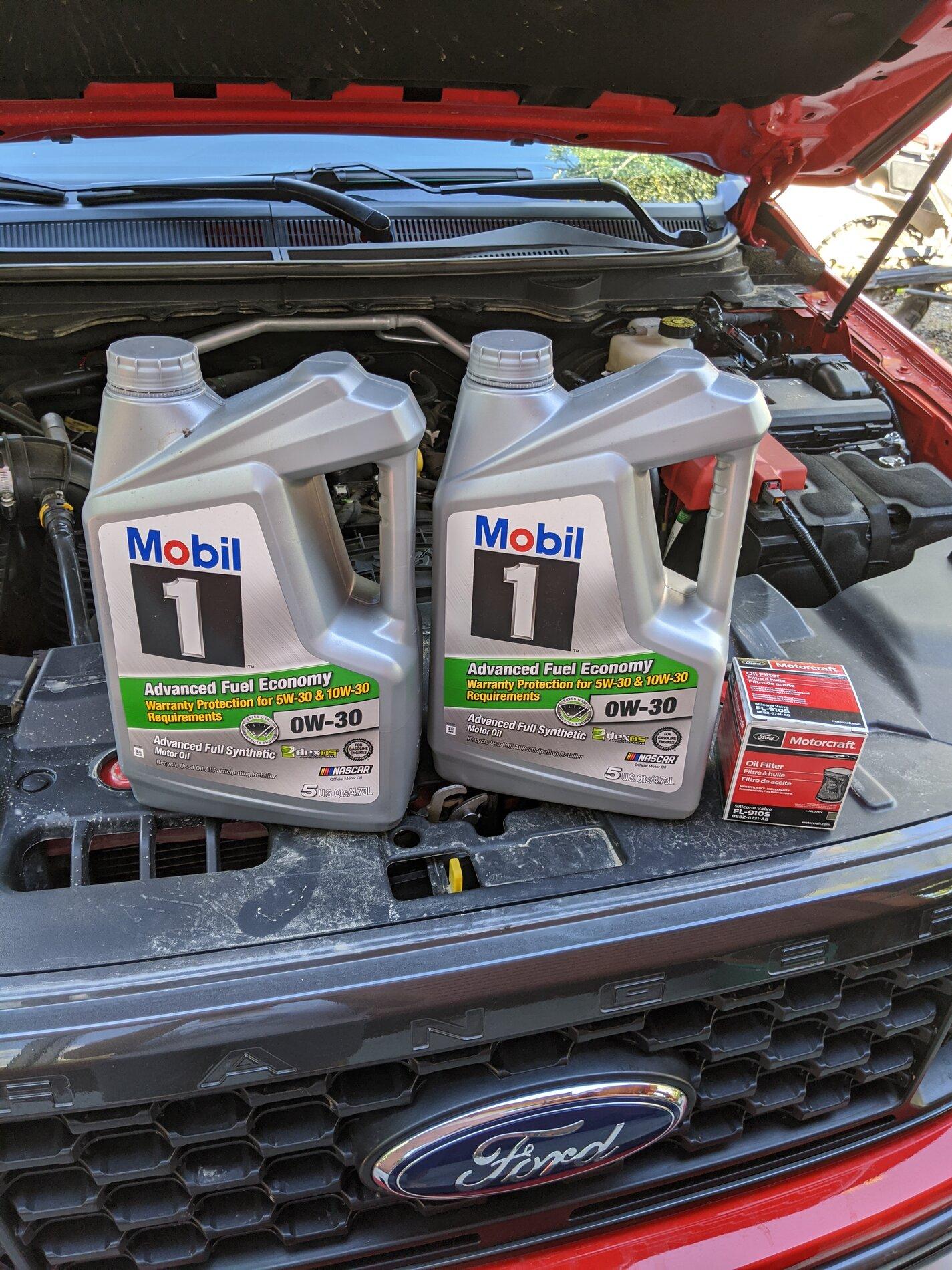

Usually I try to do a break-in oil change at around 1,000 miles. Oil looked pretty good. I was able to get a pair of slip joint pliers up in there to get the filter off. That was the hardest part. I'm just happy to have a vehicle again where I can crawl under without using a jack or anything. I had a Focus RS before this lol

‘Just did the first on min yesterday with AMSOIL.
Would love the throat punch the individual who put the oil filter on like they were torquing head bolts lol!
Did miss putting the drain pan under the correct little drain spout for the filter,and had a nice little puddle to clean up,but overall,not bad.
She did run a little smoother with the fresh brew in the crankcase.
