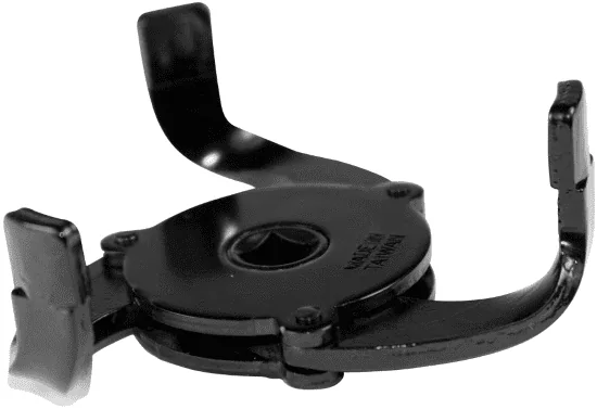

I did my 2nd change yesterday. installed the ValvoMax after the 1st. (Hint: be certain to remove hose before filling. Yup I dint and poured 5 qts fresh 0-30 thru the motor onto the driveway. Worked great!. Then removed hose and filled again. Der.) Used this to remove the filter which I installed to spec but could not otherwise remove: https://www.amazon.com/Performance-Tool-W270-Universal-Filter/dp/B0002KO1GC

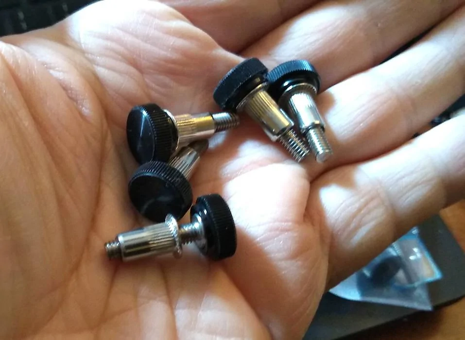

First test of the Valvomax and I plan on picking up some thumbscrews for the flap.

Have they stayed on off road? At 100 MPH? :LOL: That's not a bad idea, I use some of those around the RV. But I didn't want to take the chance so went the thumbscrew route, whatever floats your boat is good.
I put them on last June. Changed the oil last week and the first one was missing, so that's 10,000 miles (I change the oil every 5k). I do not off road it but PA weather is pretty wet and snow. They come in a 6 pack and I used 3, so I still have 2 left. When the weather gets warmer I'll try Gorilla Gluing them to the flap.
