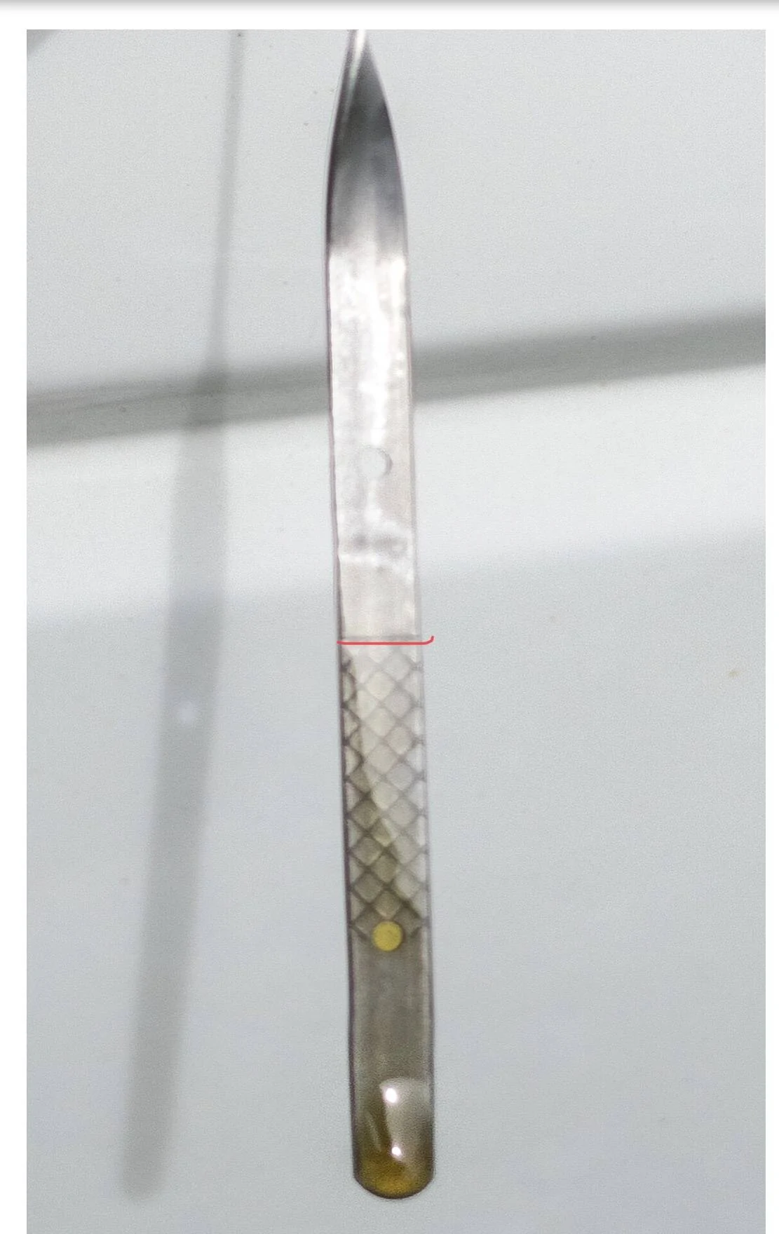

I put in 6 qts the last oil change and it had it just a hair below the hash mark towards the topI marked it in red,the top hole is the maximum level,so it’s in the safe zone
I like to run my cars at max line on an oil change. Maybe it is because the car I traded in for the ranger tended to drink oil so starting at full gave me more time before I had to throw more in.
