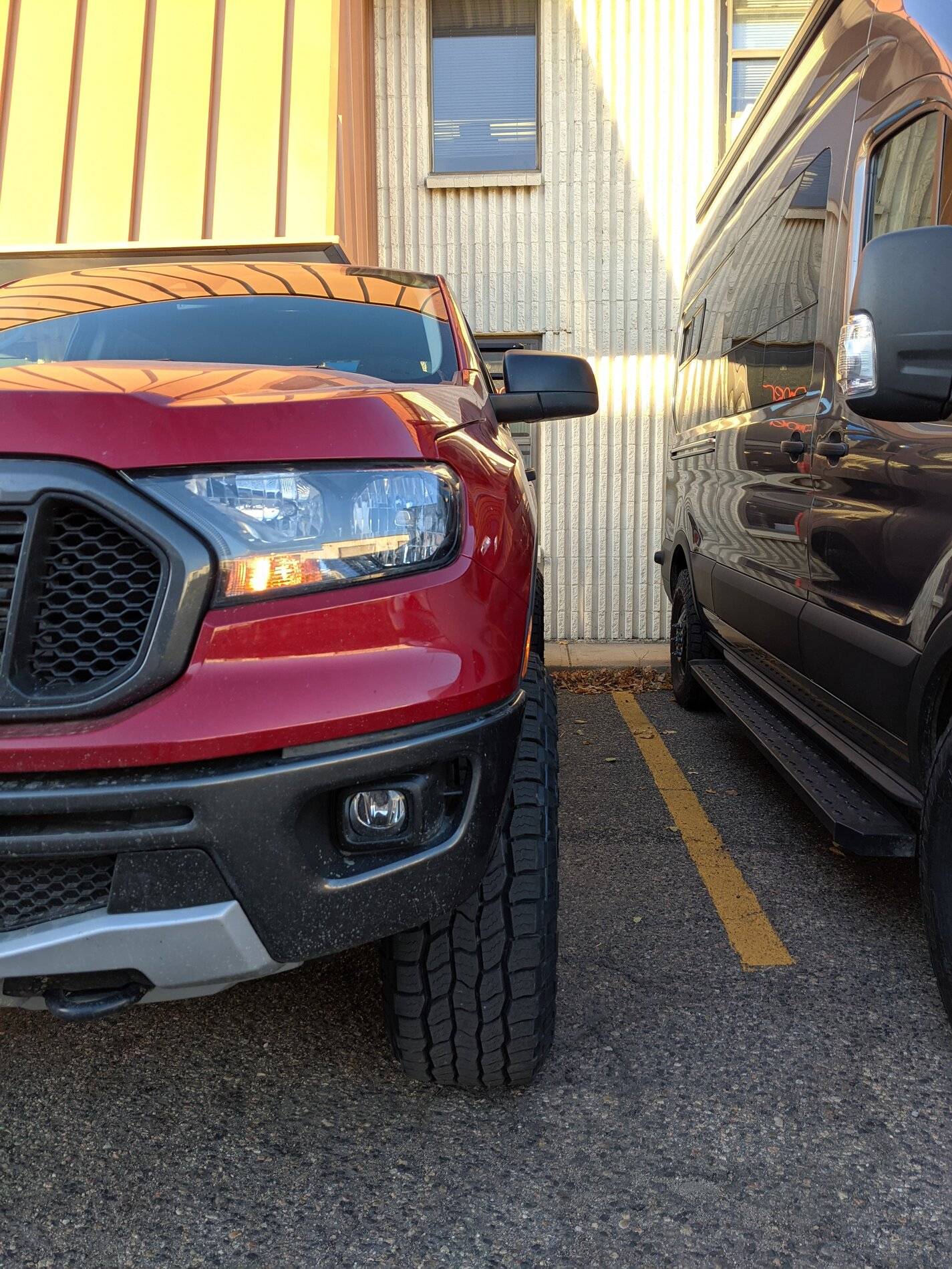

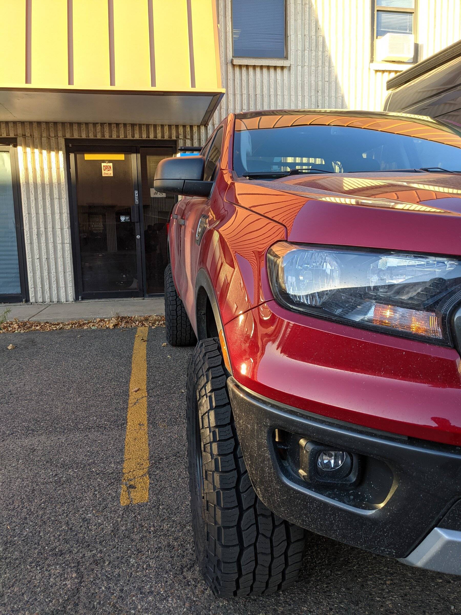

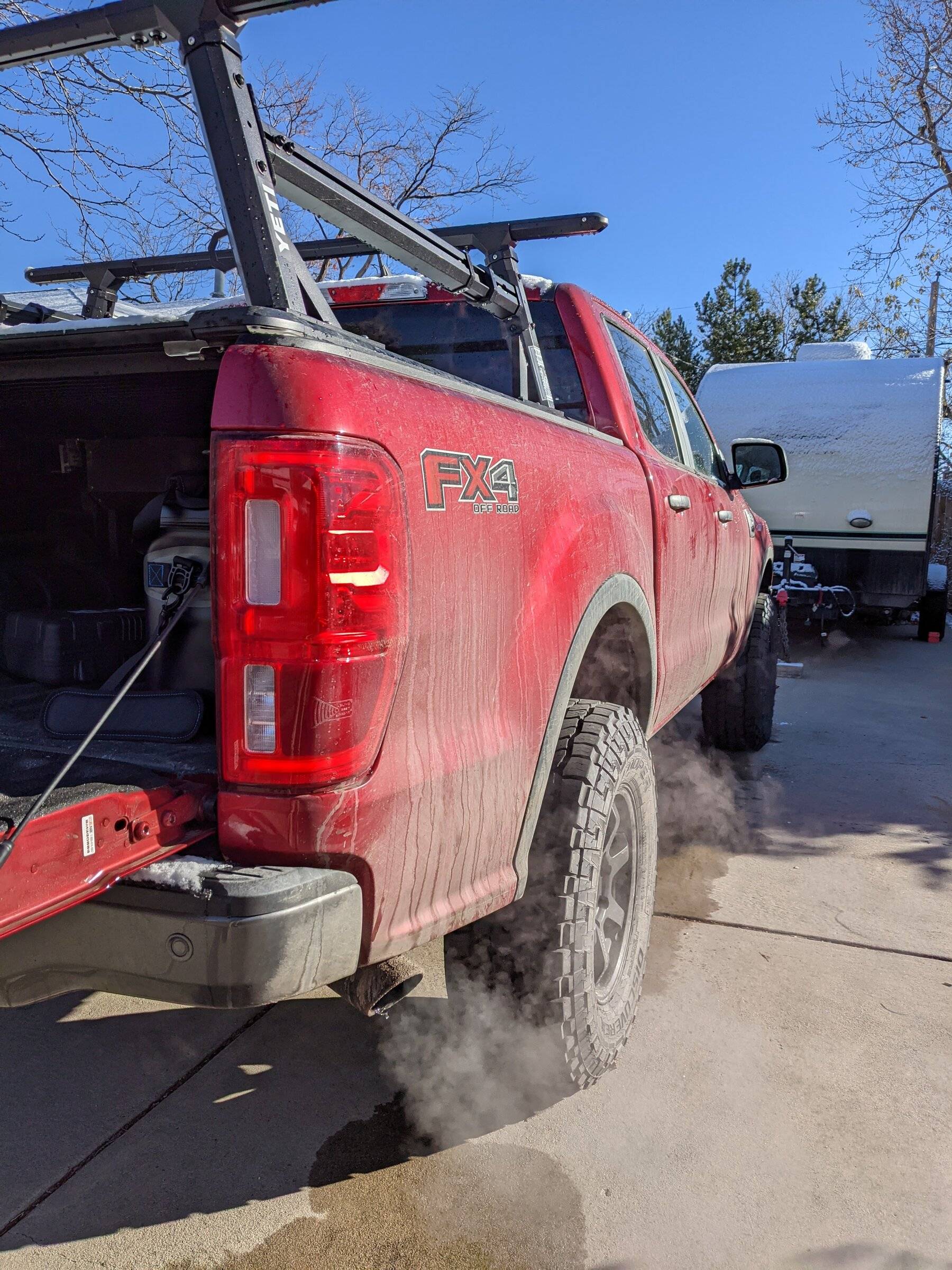

Just installed new wheels and tires to go with my new lift.
Motegi Trailite 17x8.5 +18 offset
285/70/17 Cooper Discoverer At3 XLT Load Range E
Old man emu standard lift
Readylift intrusion bars
Tasteful poke, no rub.

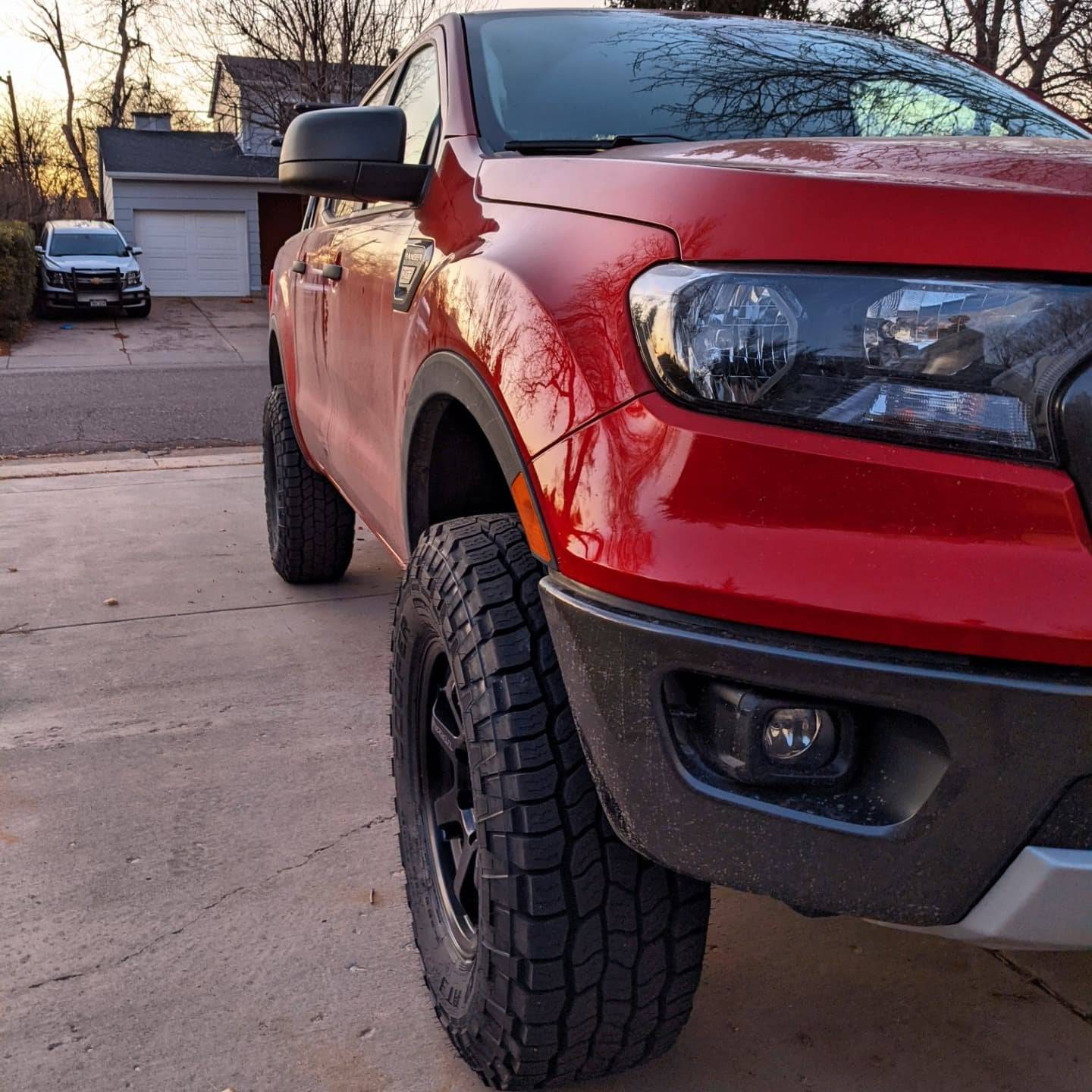

Finally got my wheel/tire and suspension set up
Wheels: Relations Race Wheels RR6-H, 17x8.5 0 offset in matte bronze
Tires: BFG k02, 285/70/17
Suspension: Fox 2.5 front and rear, front raised about 2.5"
Cut out rear intrusion beams, they were rubbing, cut out some fender liner that rubbed behind the tire, and BDS front intrusion beam. Fog light pockets removed to add dual light bracket.
Still some rubbing on the fender liner, I need to cut a bit more out, but doesn't seem to rub on any chassis parts!
How are you liking the standard OME lift? Your build is very similar to what I am trying to achieve! I want to go with 17x8 +20 with 33x10.5R17 tires. Except for crash bars, are you close to rubbing anywhere, even at full articulation? Thanks!

‘21 Ranger Lariat
I'm loving the setup so far - the wider tires feel a lot more planted, and the suspension is more firm but not harsh at all - just more planted. Totally with the money invested. As far as rubbing goes, I did trim the black aero thing that deflects air from in front of the front tires. Other than that, nothing. I would personally go with the 20mm offset in your situation - you'll still have tasteful poke, but it'll be just a bit less poke than my setup.
Here's some more pics to get an idea of my current poke-age:
