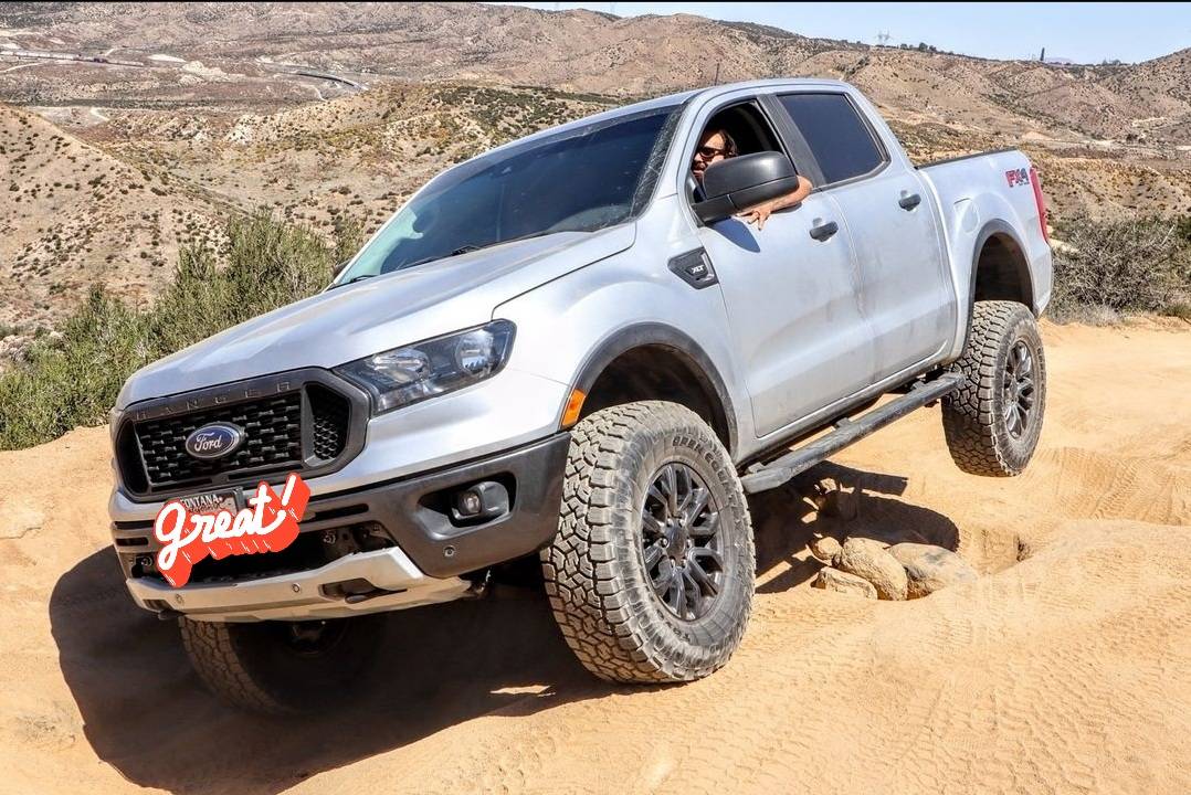

Hope this helps. No rubbing with the amount I cut out even so no rubbing on wheel well covers either. Picture is to show I have flexed it out quite a bit. Accelerates about same speedo is off 7mph although I haven't recalibrated ecu. I get between 11 and 12 mpg.

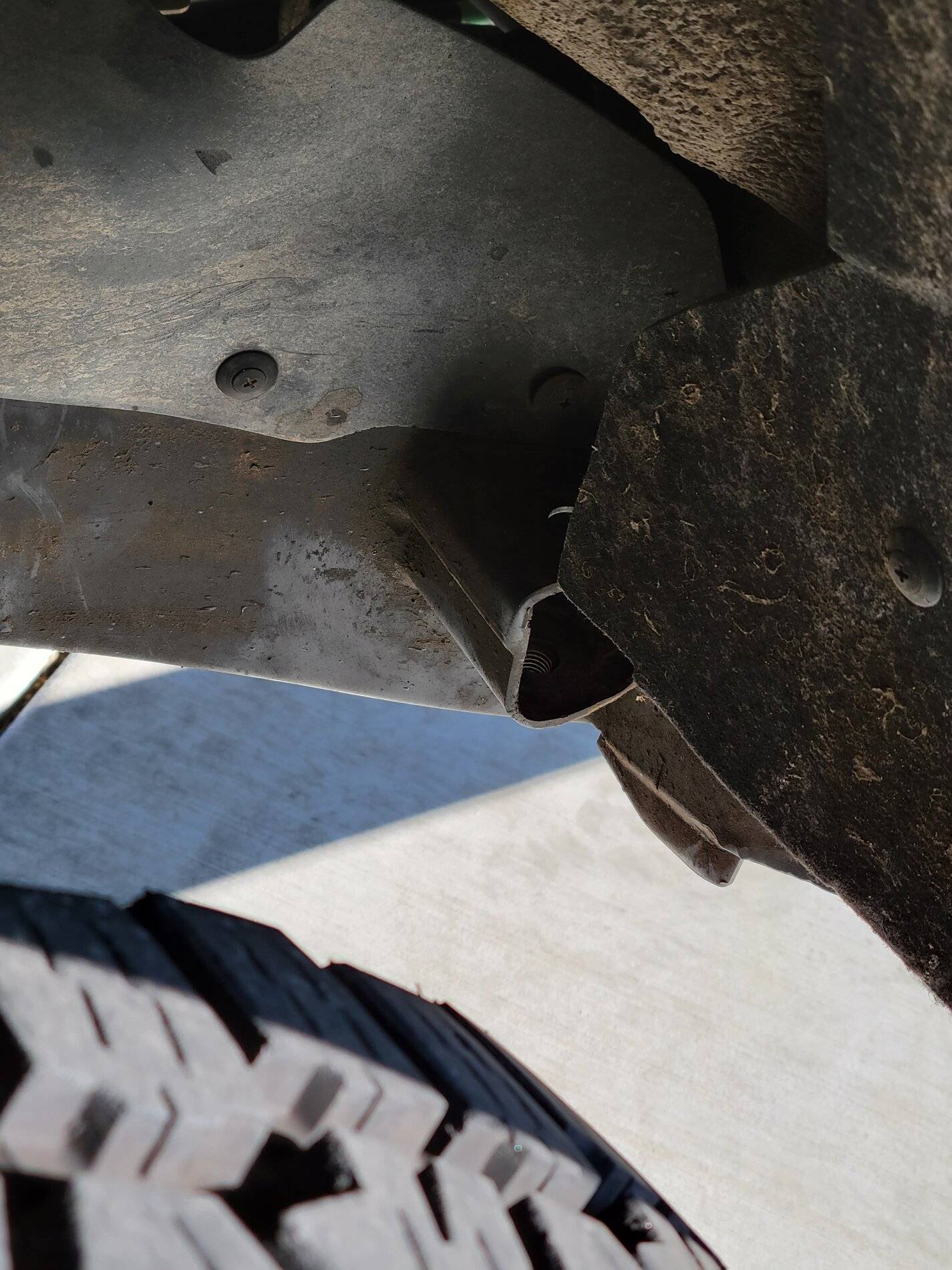

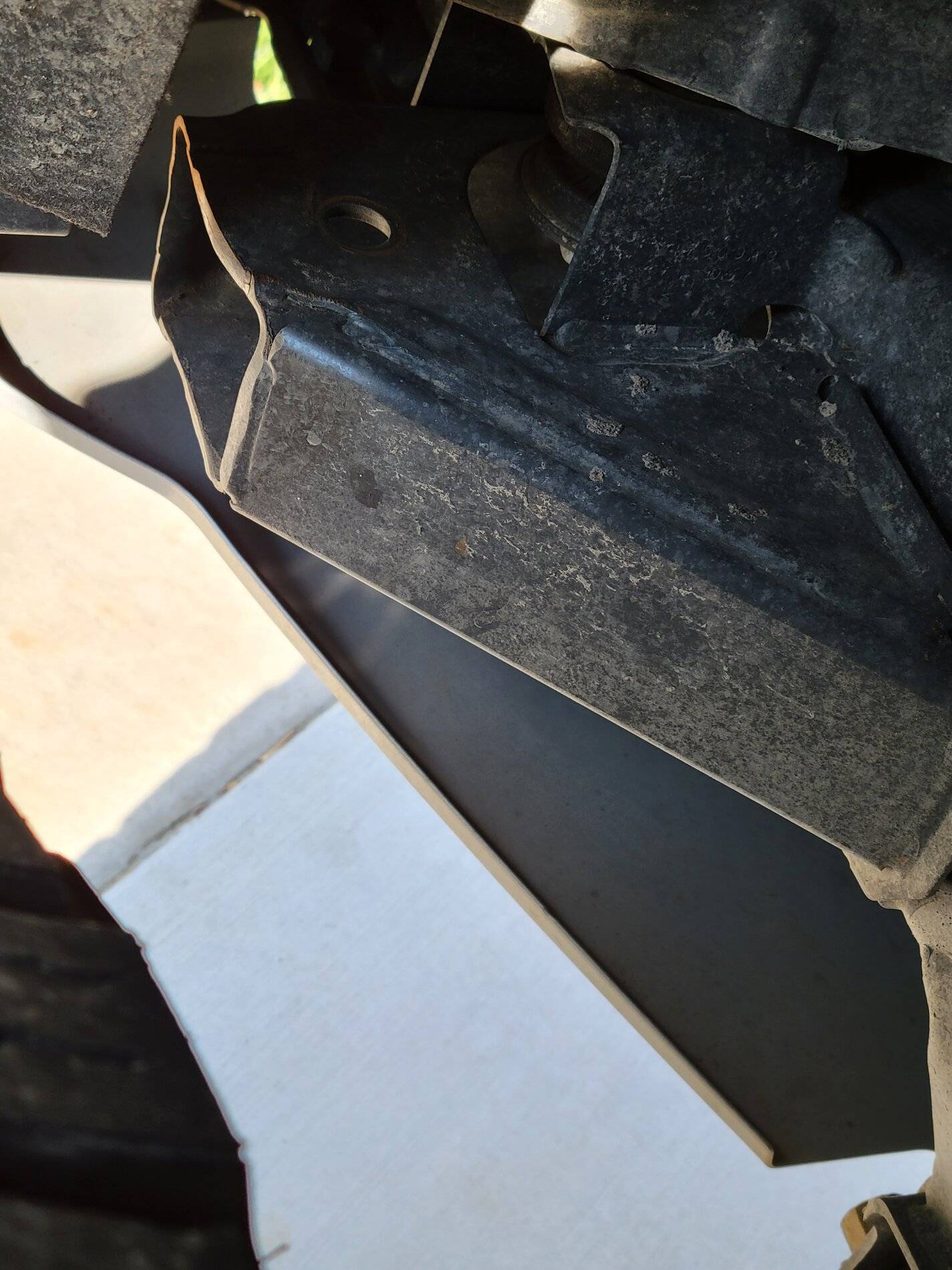

Any details on what intrusion beam modifications you needed?? I actually got the same wheels (RRW -RR6H), Fox 2.5's and am trying to decide between 285/70/17 and 285/75/17. I'll have BDS intrusion beams in front and rear, but trying to figure out if the 285/75/17 will actually fit without rubbing.
I've seen other members fit a 285/75/17 with crash bars removed, so that's always an option too I guess.
In my setup, at full left turn, there is a slight rub on the D/S front wheel well. Not enough for me to really be annoyed by. The intrusion beams I use are Ready lift which is more beefier than BDS beams. So you might be able to get away with no rub issues.

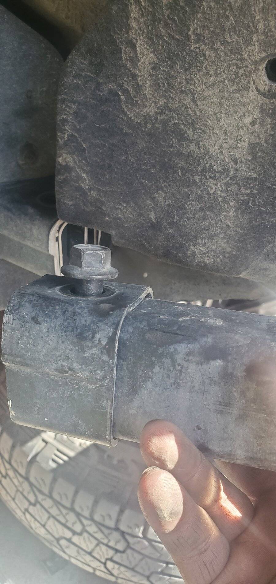

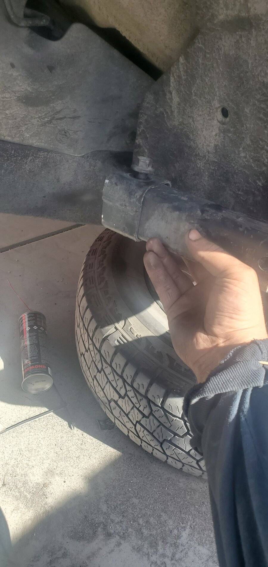

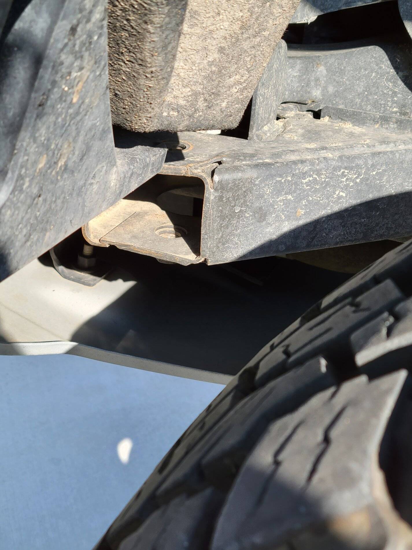

Here's my crash bar tolerance. This is driver's side, full right lock at the front crash bar.
Here is the rear crash bar, still on the driver's side, but full left lock.
I'm sure if I got to full compression, I'd have some rubbing but I'm fairly convinced this is the absolute biggest you can go on stock rims with a level.
