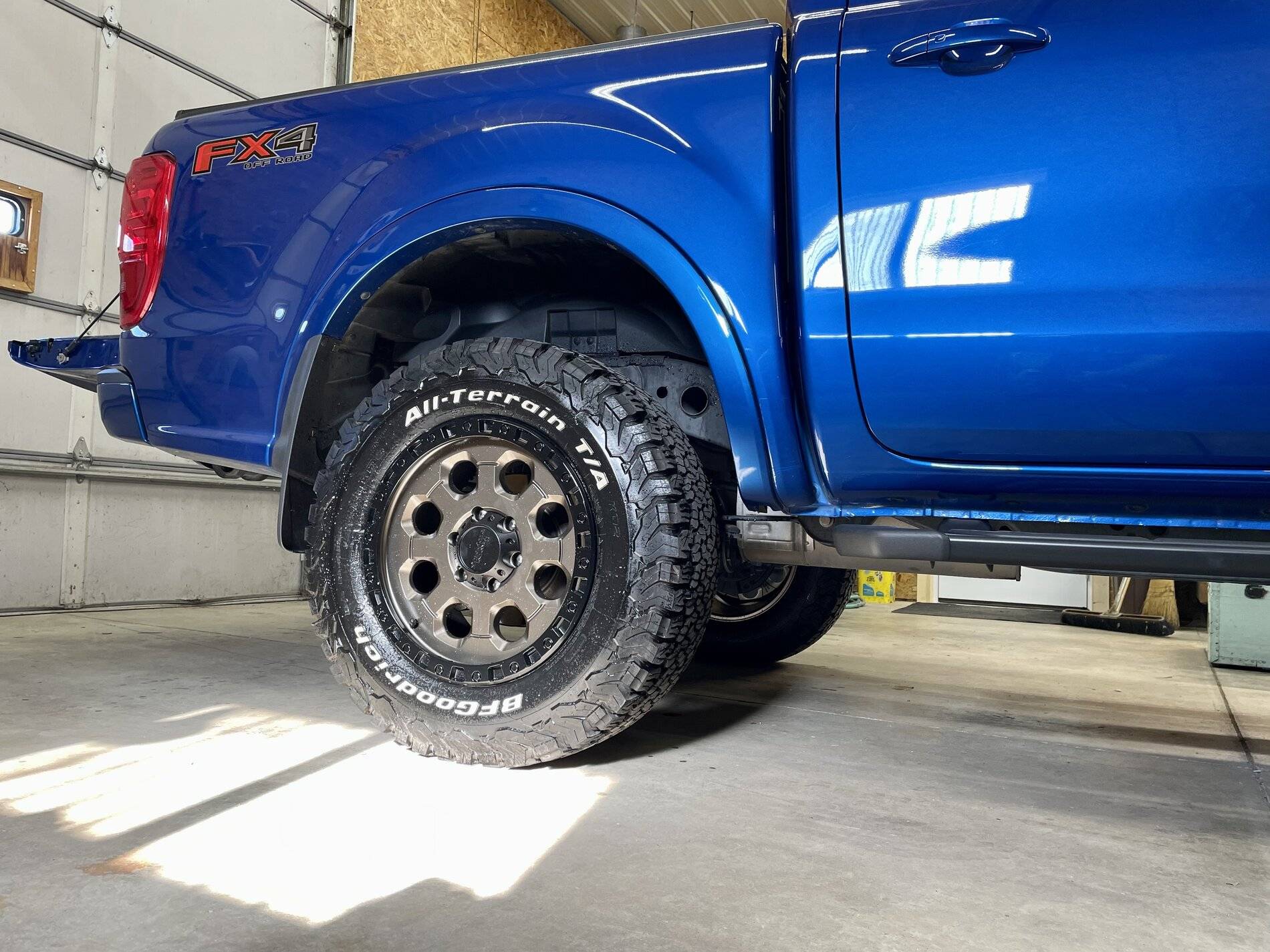

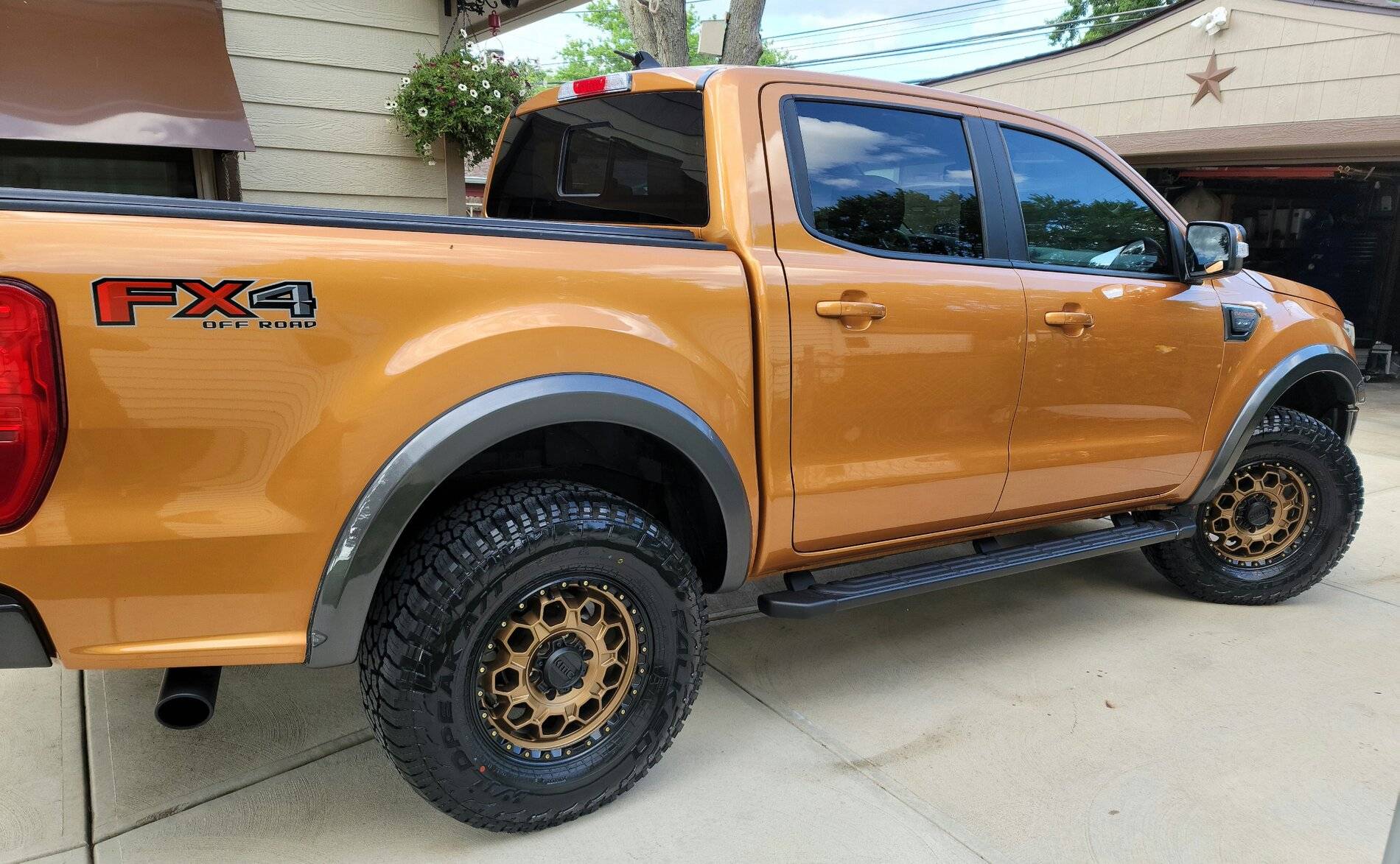

I just mounted a set of these exact wheels along with BFG KO2s in 285/65/18. My Ranger is blue, and the dark bronze wheel color looks great! (American’s photo is deceiving, the bronze color is much darker in person) I’ll get some photos up in a day or two…

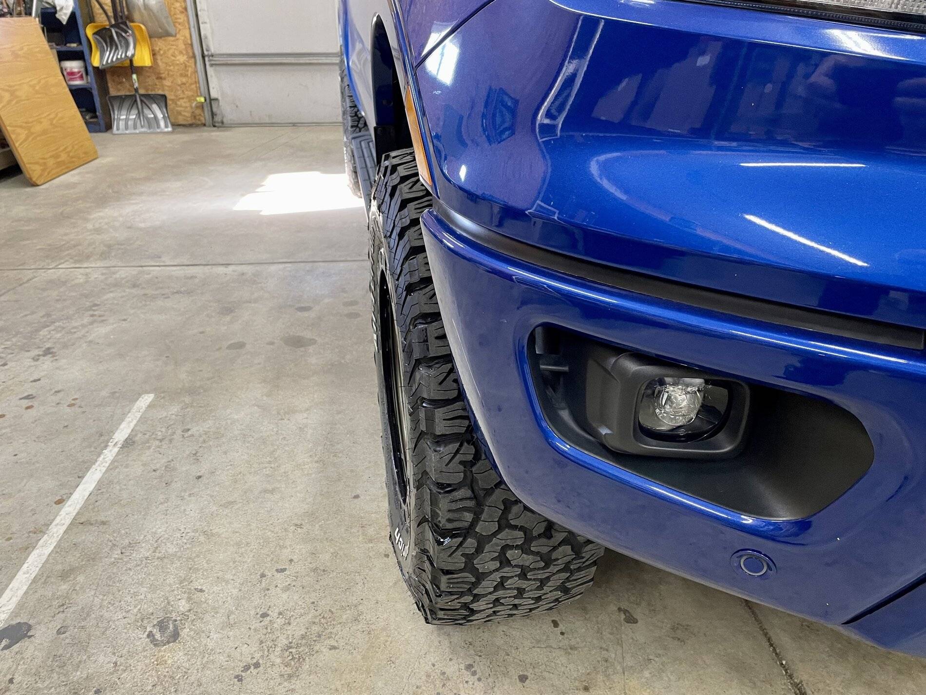

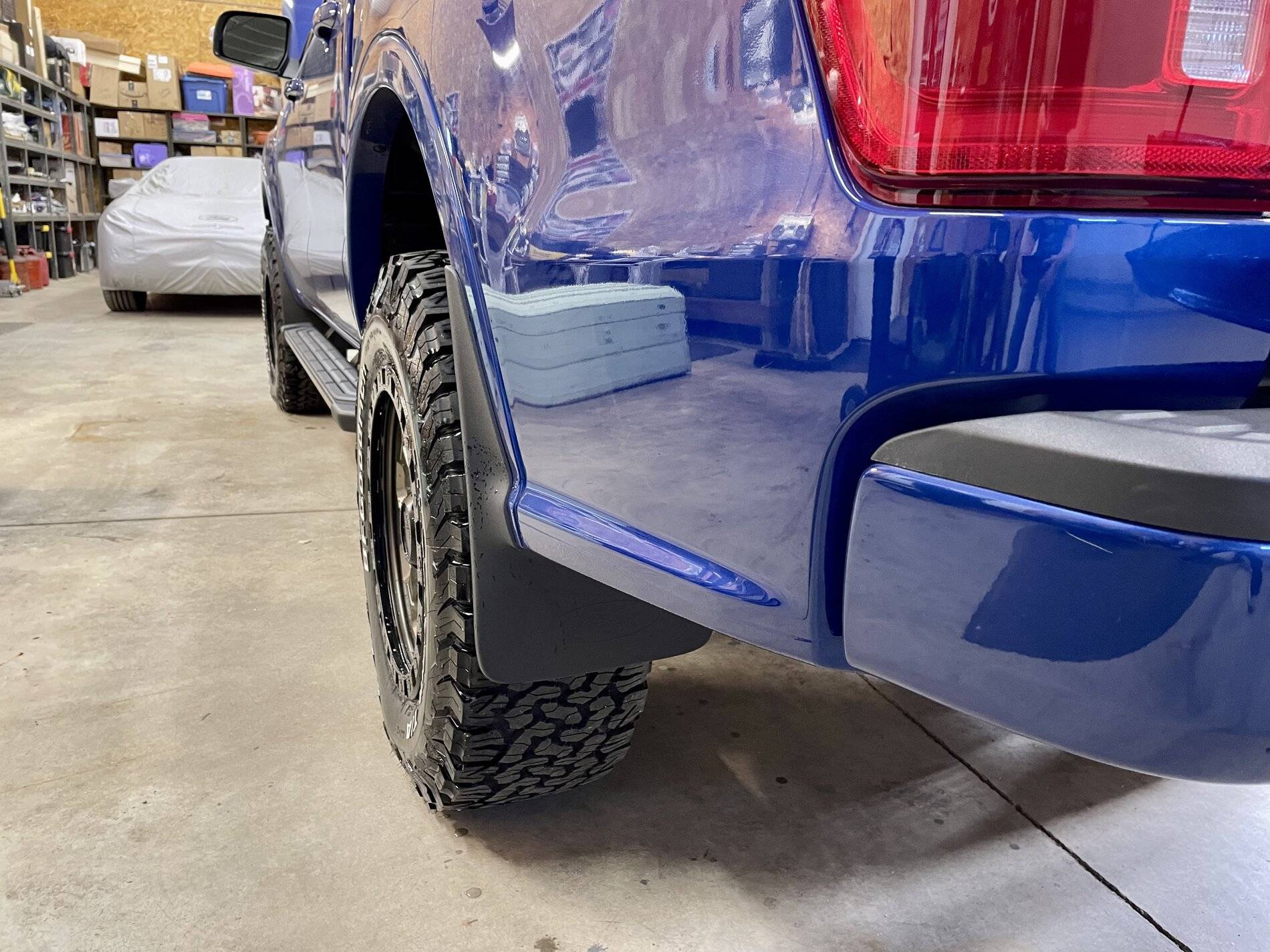

If that is with a 285, then my 265/65/18 tires should be fine. How is the overall clearance with those 285s?
I’m on a 3” lift in front, 1” rear. They clear ok. Your 265s should be a perfect fit. I bought the wheels from PerformancePlusTire.com. They had a good price and they were in stock.

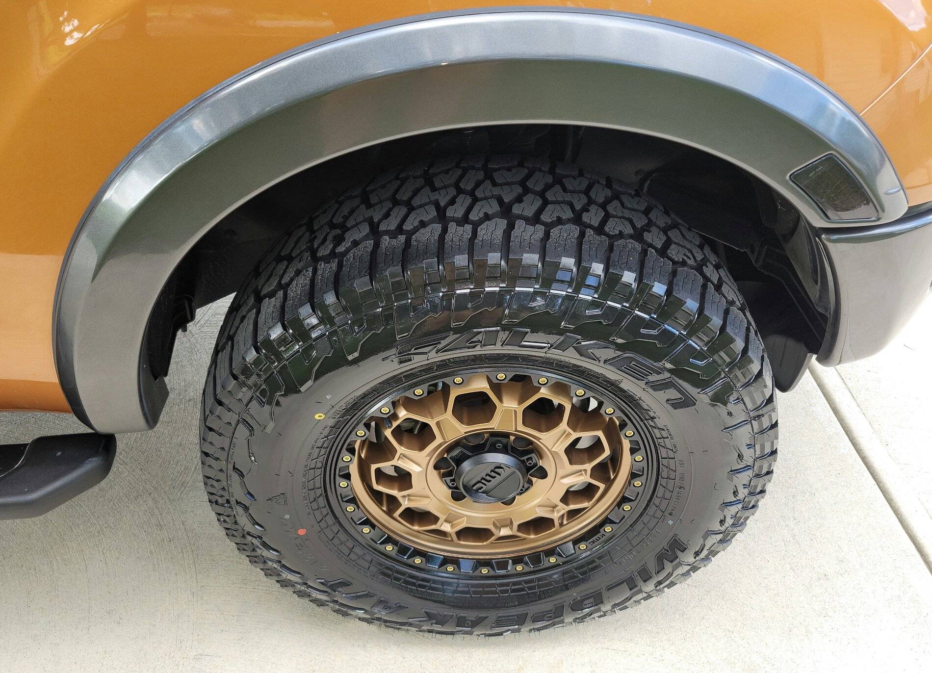

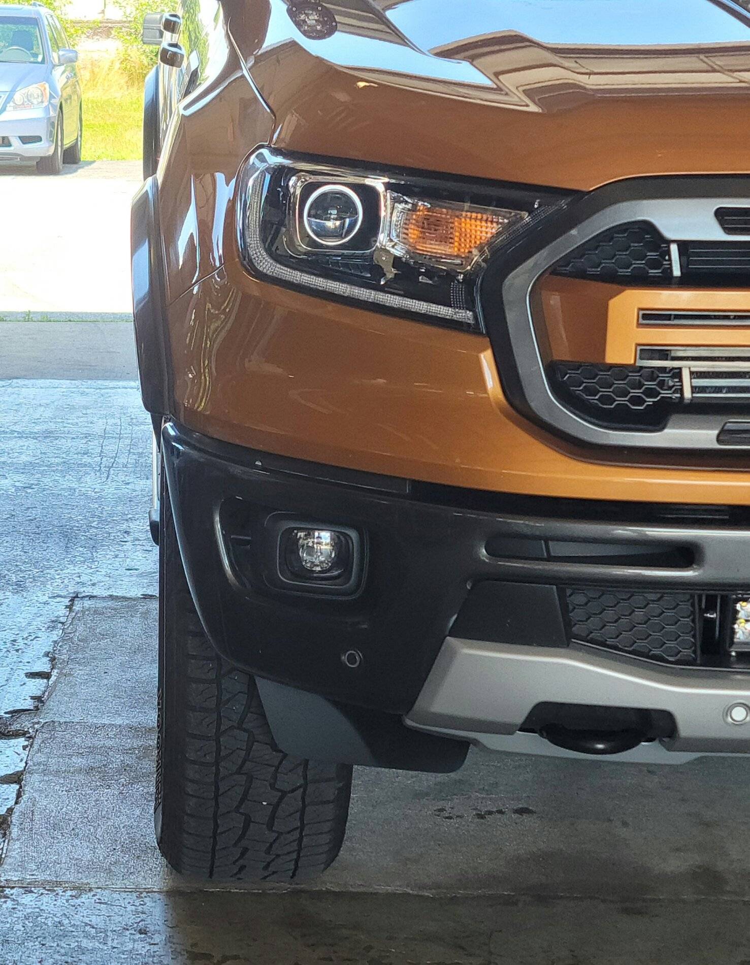

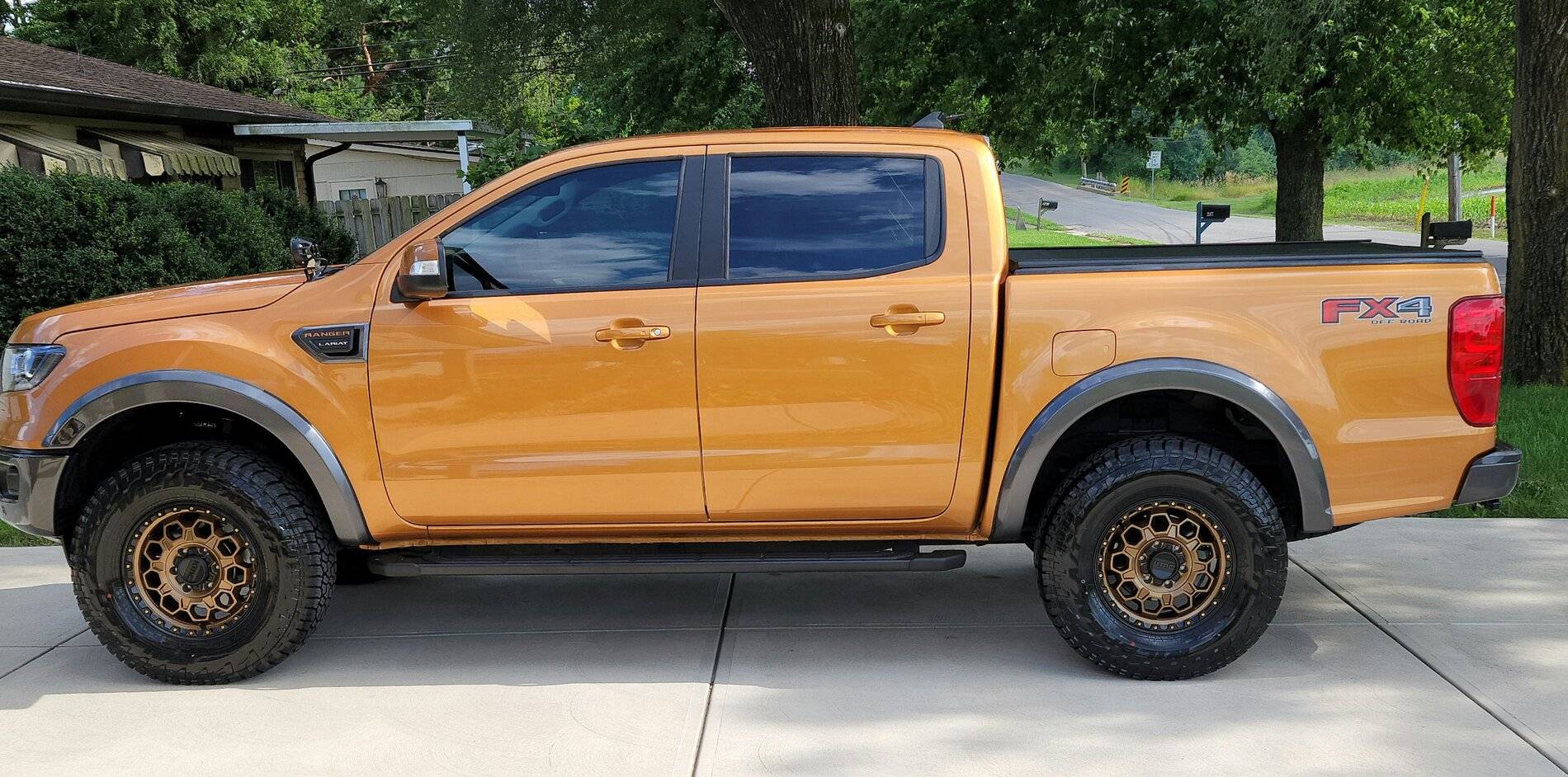

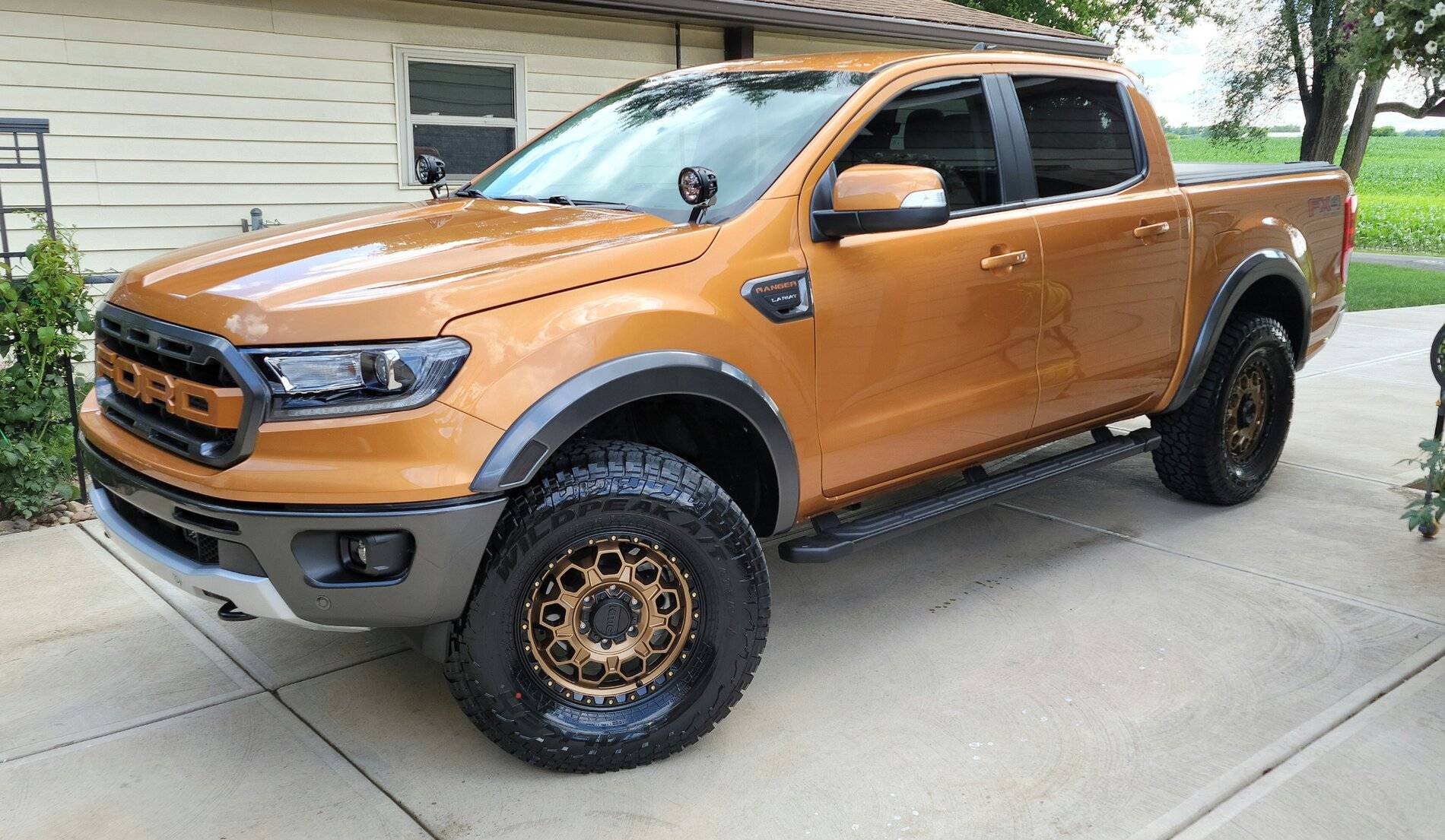

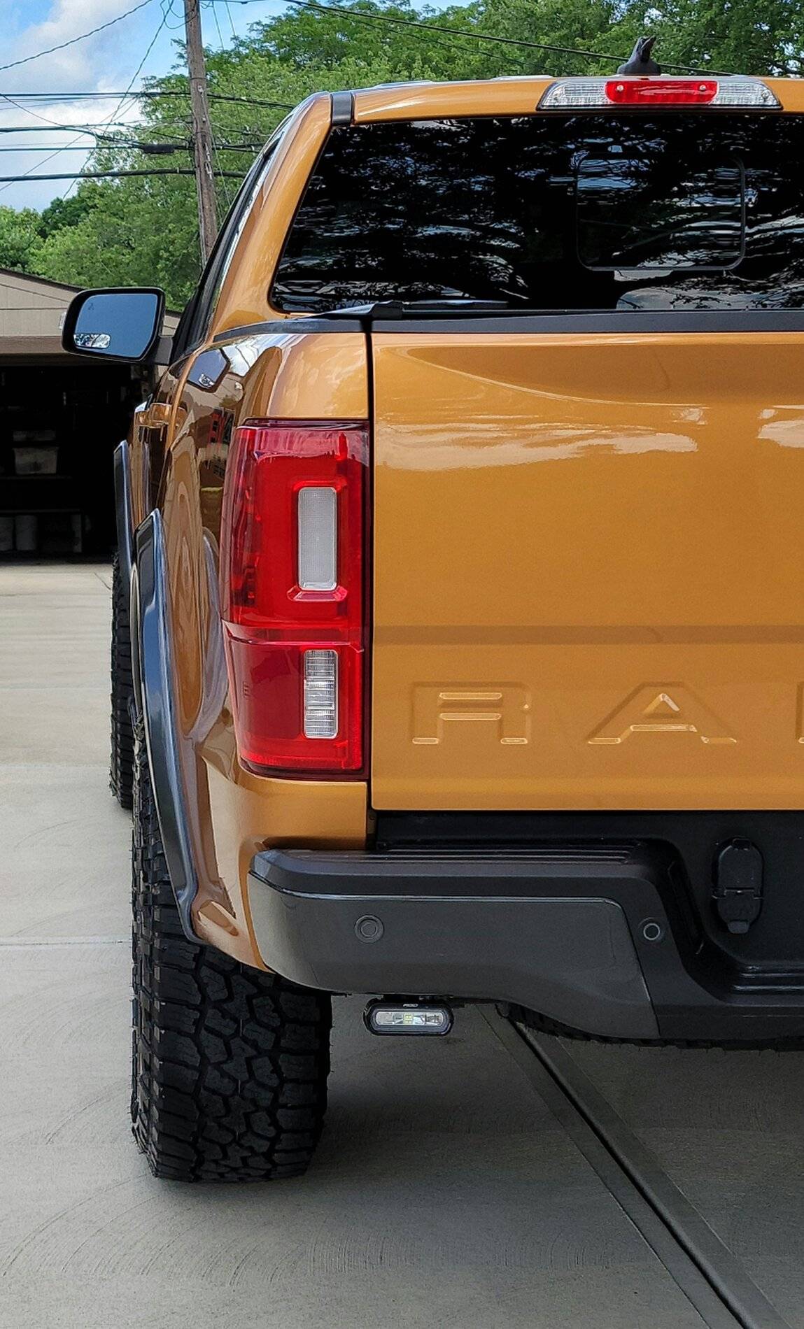

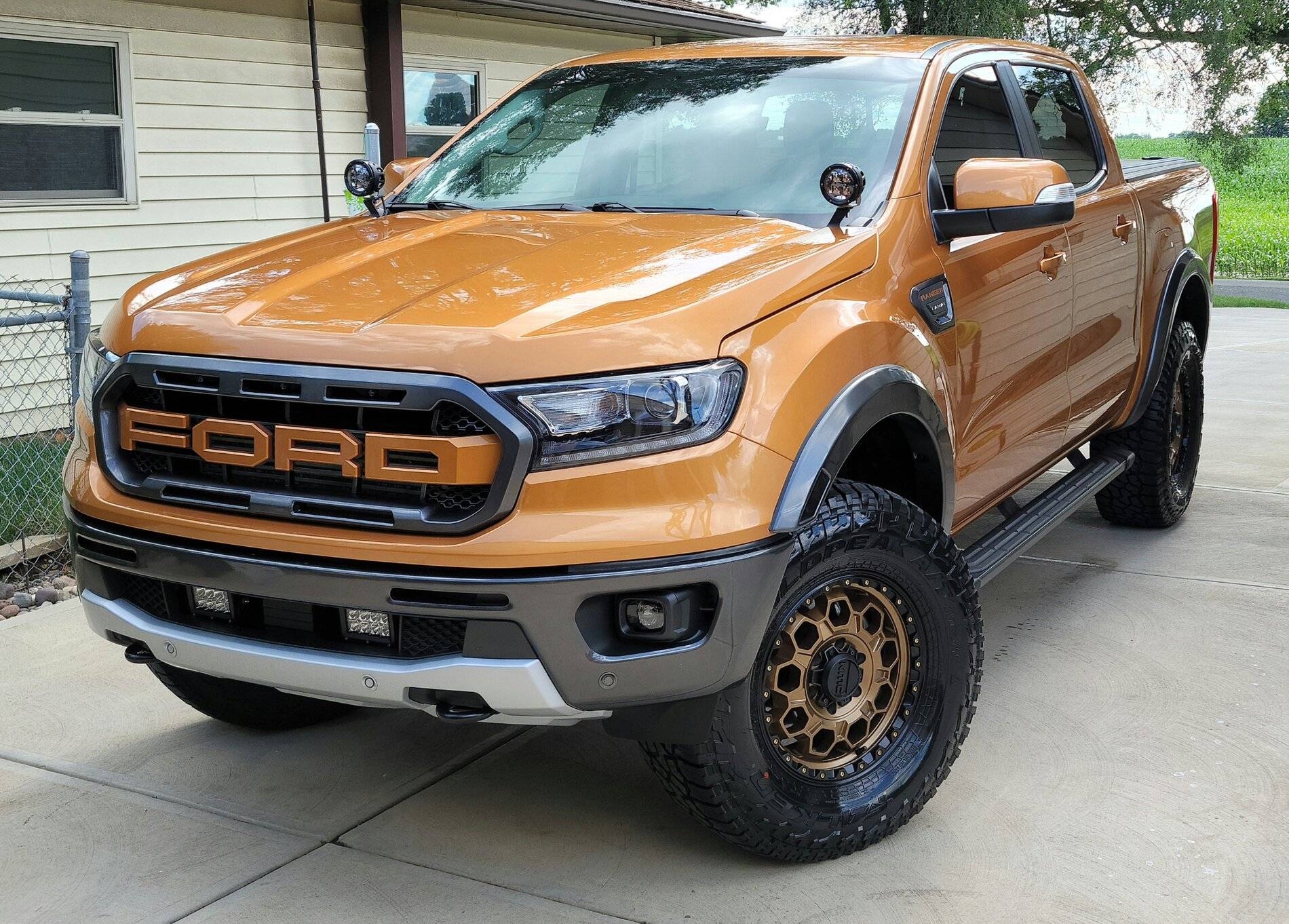

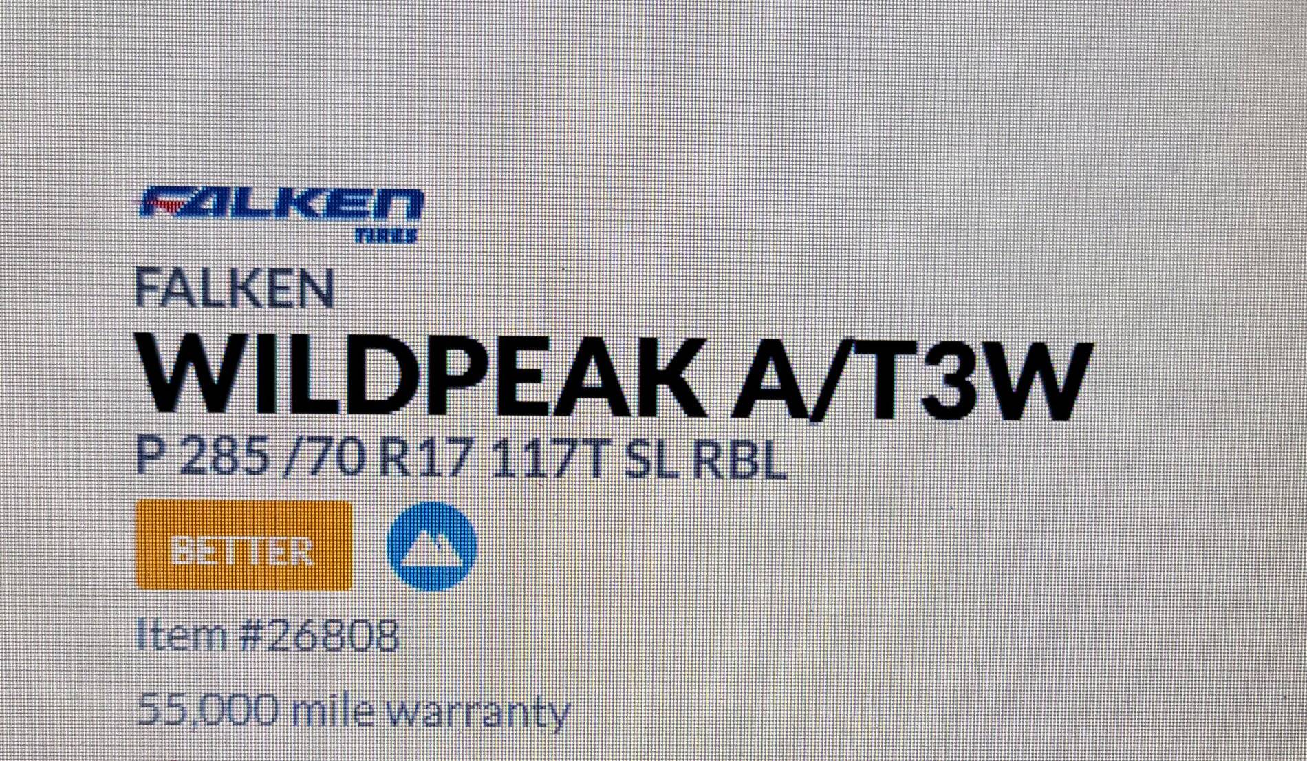

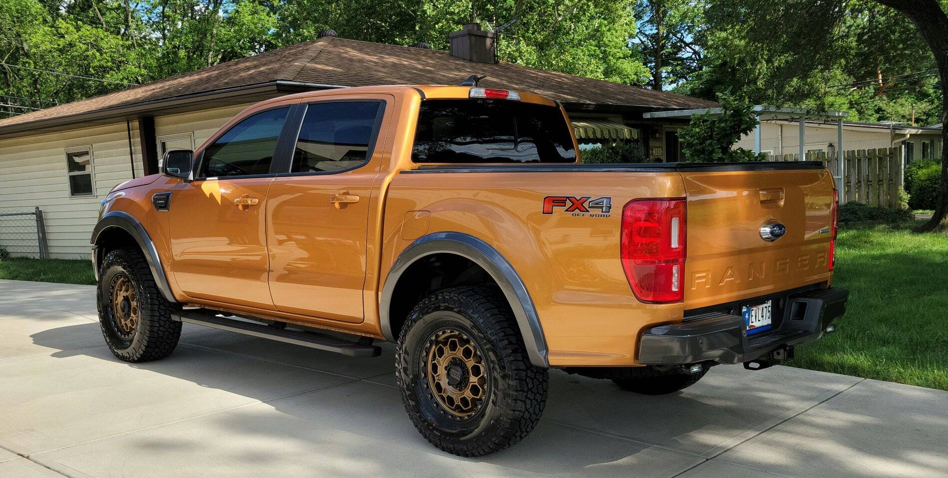

Installed my new tires and wheels today! KMC 17 x 8, 20mm offset and 5 Falken WildPeak P285 70 17 tires.
The 2nd to last Pic at the shop is the stance with the oem tires and wheels.
I still need to do some detailing but I managed a wash and meguiars tire shine foam.
I still have 2 3/4 inch clearance for the garage so I will install the last 1 inch spacer in the front next week and adjust the speedometer.
