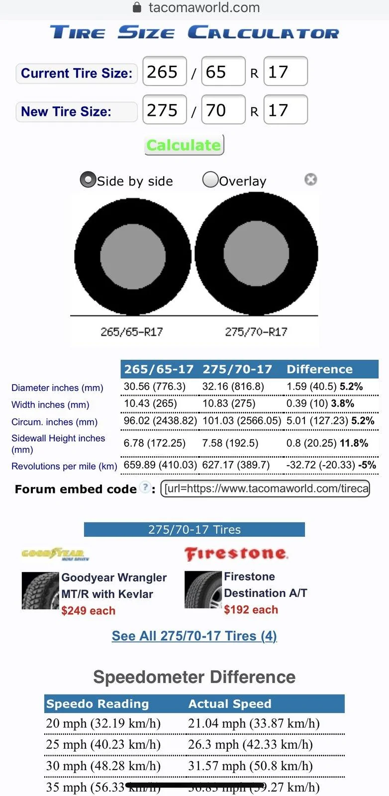

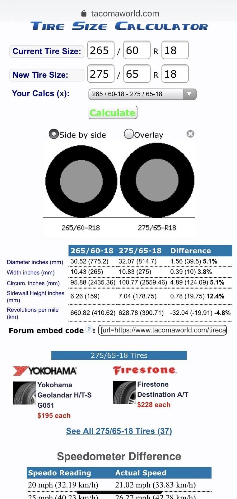

    Based upon what others have said regarding clearance issues with stock wheels and stock ride height this is what I’ve come up with for the 17” and 18” stock wheels. At modest 1.5” increase in height and .4” increase in width for both tire upgrades.
