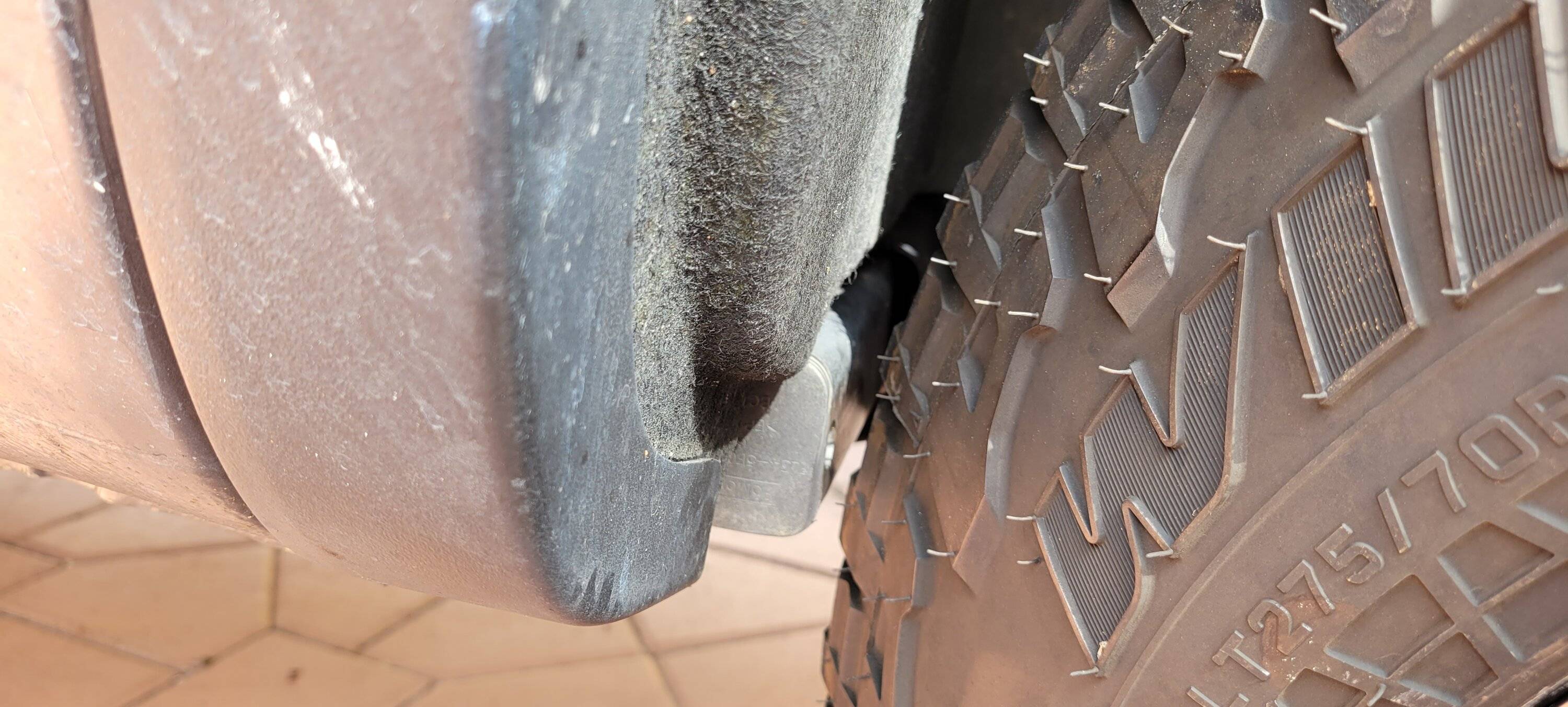

So I now have those same wheels but with 275/70R17, and I have the rubbing on the rear intrusion beams. What did you ultimately end up doing to solve the problem? Can the beams be loosened and bumped back for clearance or did you scrap them/replace them all together?
You can unbolt them and slide them out...you'll first need to remove bottom fender screw and pull away a tiny bit to clear...don't forget to replace the bolts....

Ughhhh. Looks like I will do that but I'm gonna have to order new lower profile ones. Damn it.

You could always just remove them... I did that. I run 285/75r17 tires and have no rubbing in the rear. Pulled the beams, the waffle boxes, and bolted the fender liner back so it doesn't interfere.

I think I will temporarily pull the beams. I've got BDS beams in-bound.

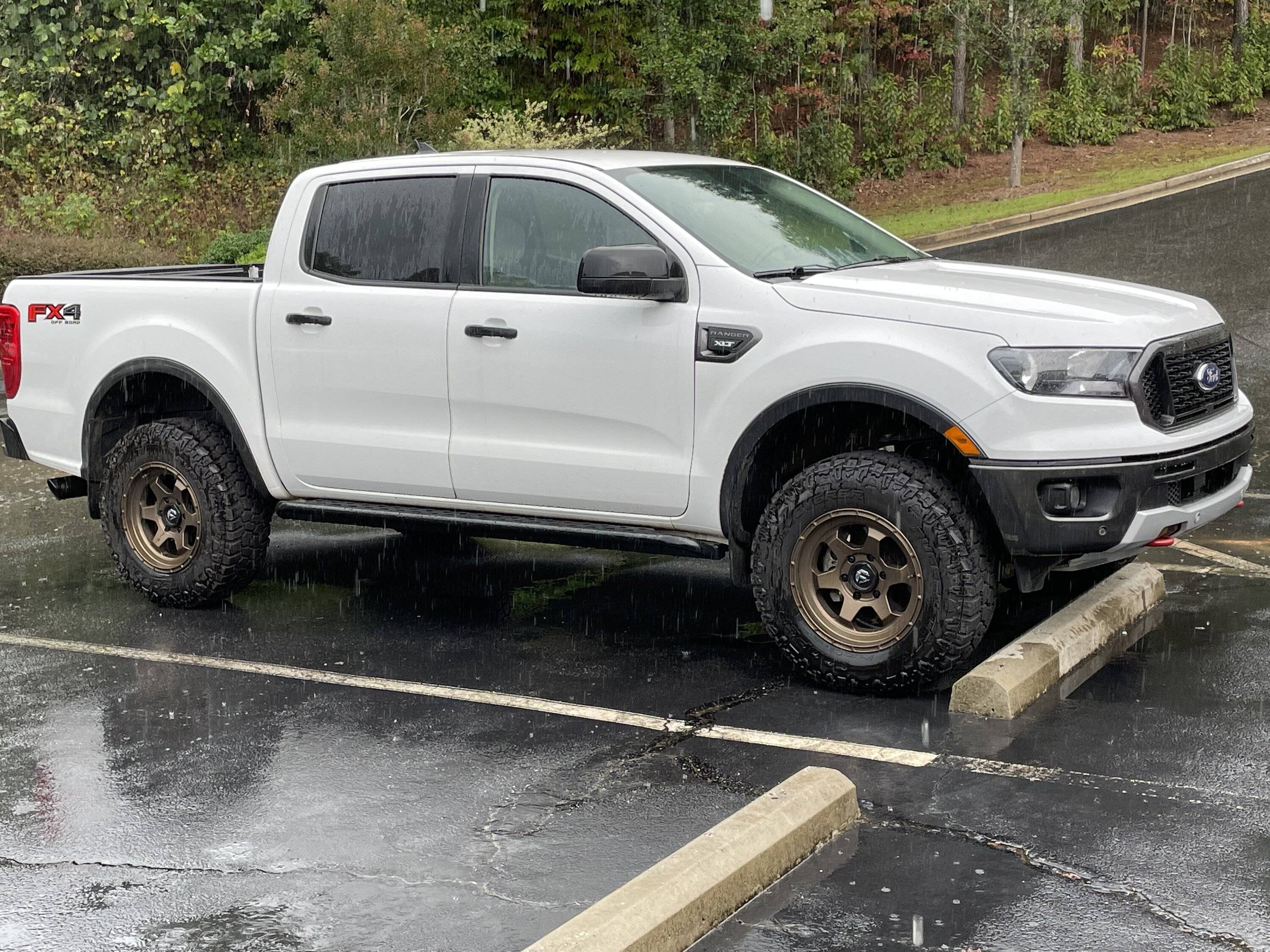

2019 XLT FX4
Bilsteins in front at 1.8
Tremor leaf springs in the rear with Bilsteins
Fuel Shok 17x9 +20
Cooper Rugged Trek 265/70/17
Factory crashbars loosened and moved forward as far as possible
No rubbing.

Nice set up! I like the bronze wheels on white. Thanks for sharing.

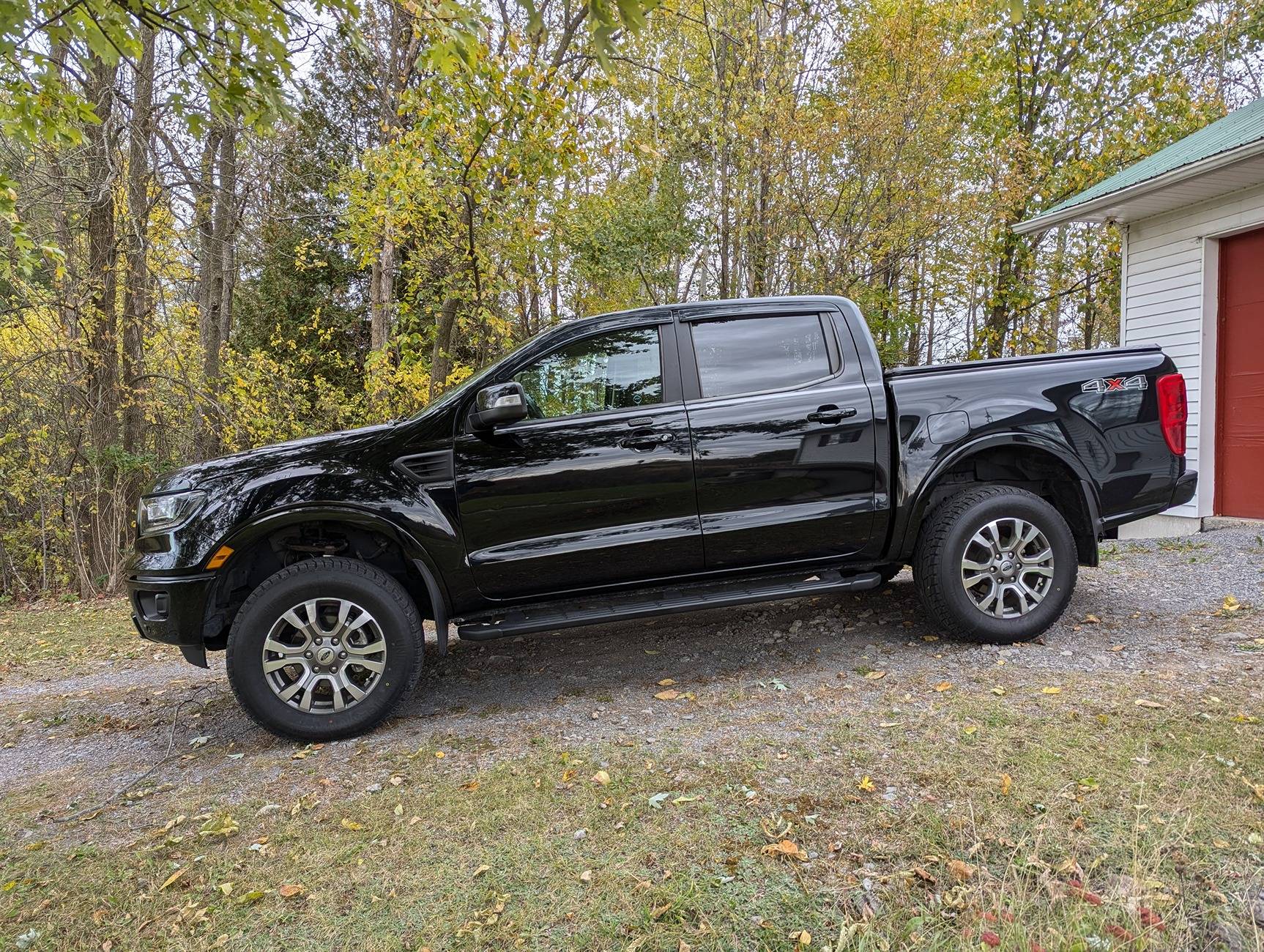

2020 Ford Ranger Lariat
265/65R18 winters on factory lariat rims
2020 lariat wit 2.5RC leveler
No rubbing and lots of room so summer tires are going to be bigger.
