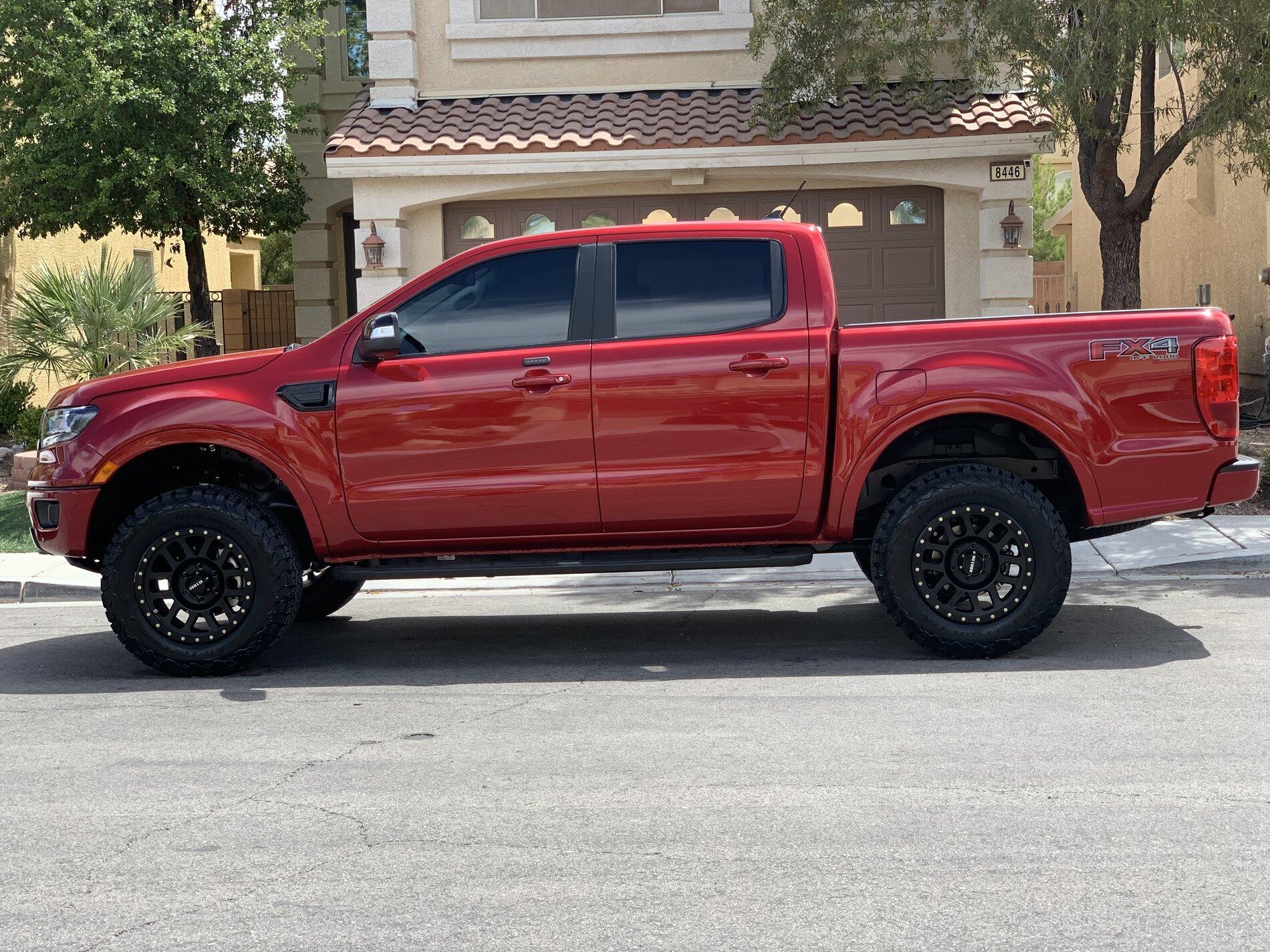

18" Method 309/Grid/Matte Black +18 offset, BF Goodrich All Terrain A/T KO2 LT275/65R/18LR

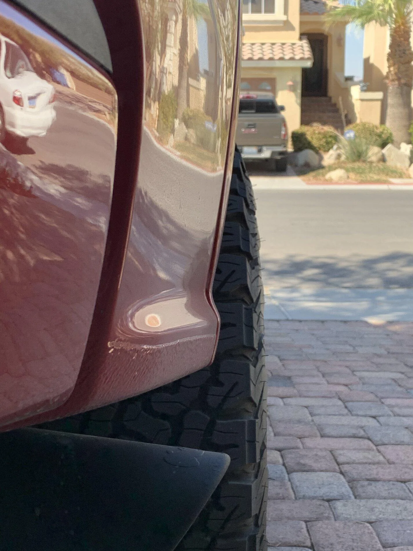

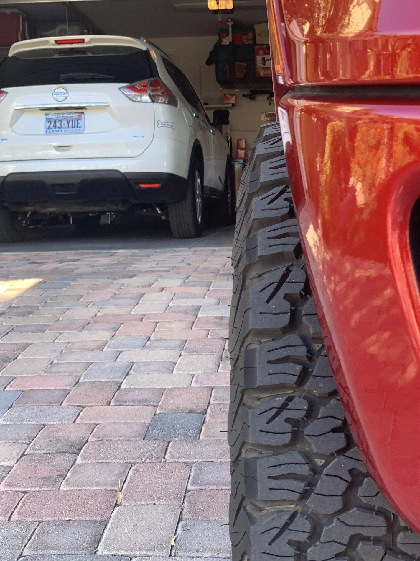

How far are your tires out past your fenders now? I’ve been looking at wheels with 18 offset just trying to get an idea if they’ll be sticking out to far.
Here are some pics. They do not stick out very far. Sorry for the delay in responding. I had to go take the pics in daylight. Haha..
You remove the crash bars?

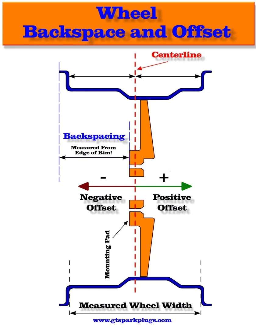

Every single one of those is incorrect in that link, as far as "offset" and "backspacing" is concerned.
I wonder where they are getting there numbers from?
Seems backspacing confuses a lot of people, which makes sense since it's a stupid way to measure offset (the method, not the concept). Here's a place that gives a good chart. The gist of it is that the backspacing measurement is the distance from the back of the wheel to the centerline plus 1/2". So 0 offset on a 10" wide wheel is 5.5" of backspacing. Here's another resource that shows that.
I did. I put in the BDS after market one. I just had to do the front ones. The back ones are still factory
