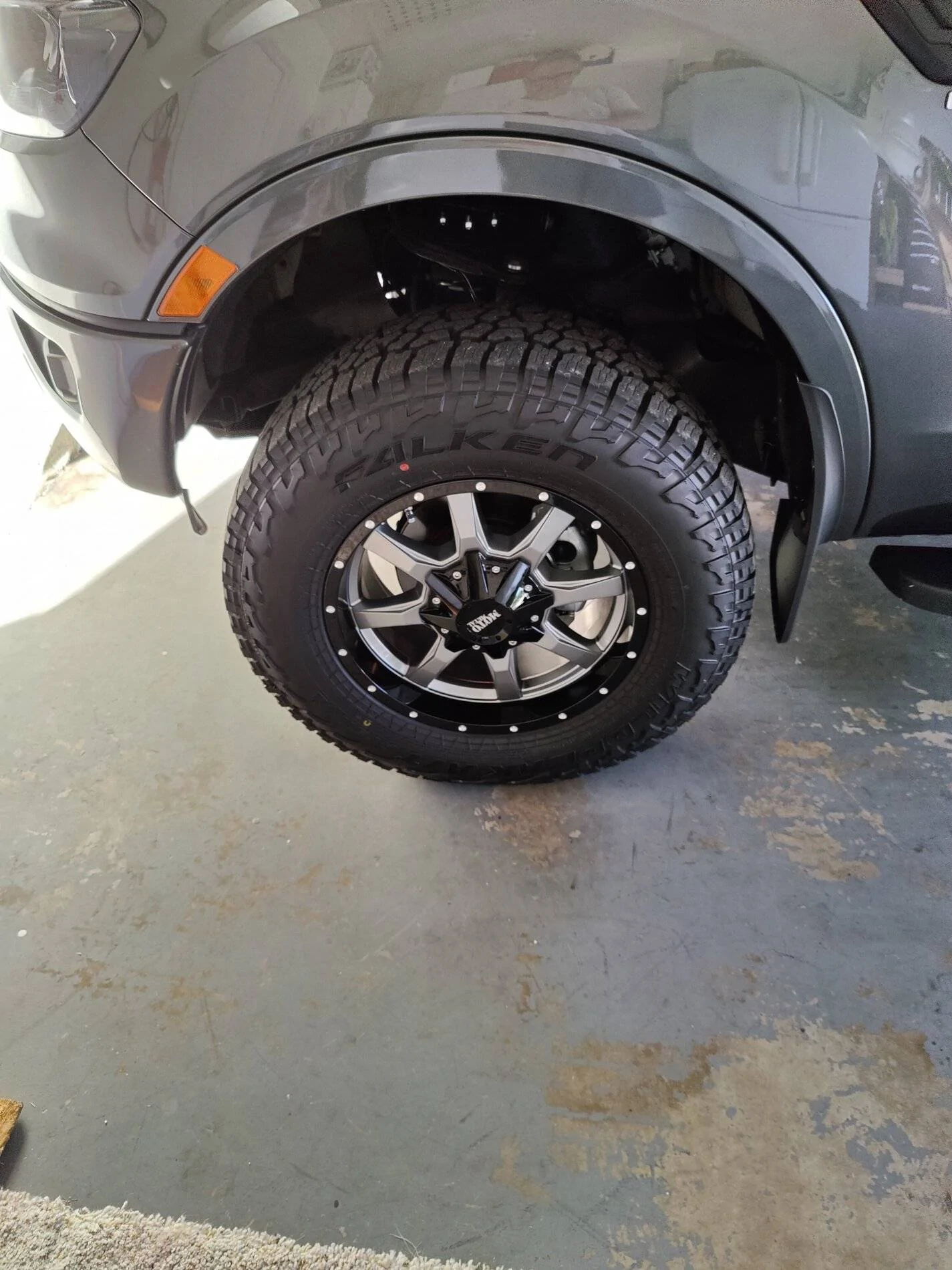

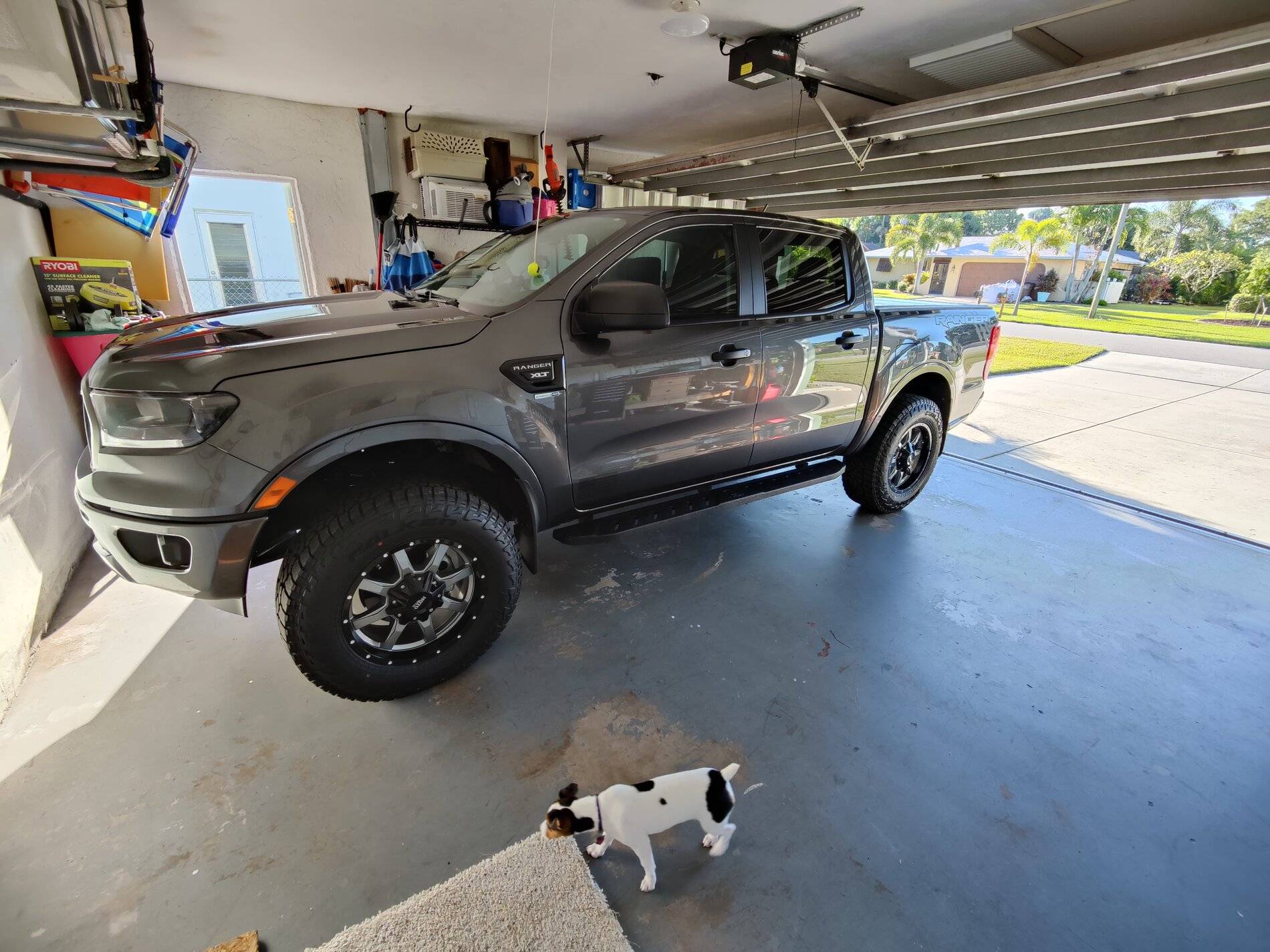

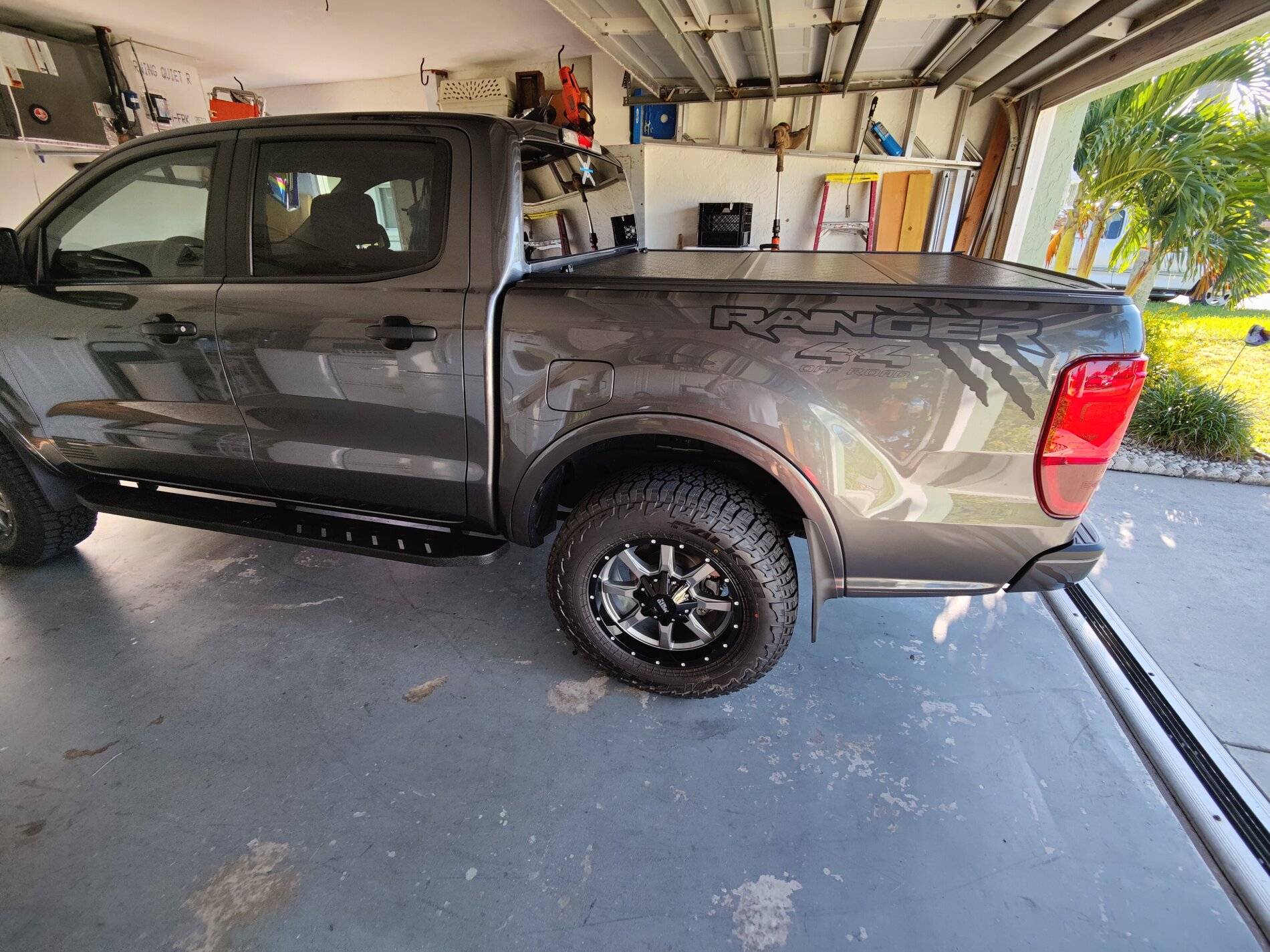

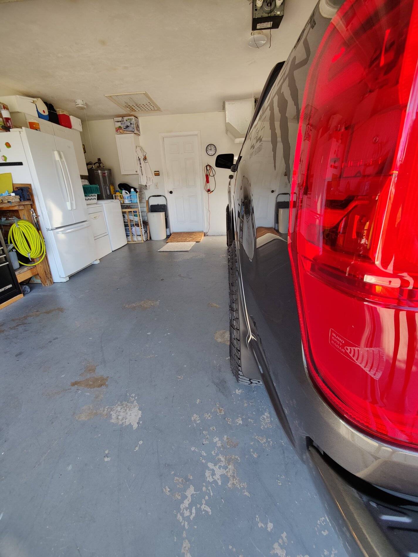

Installed my new tires and wheels today! KMC 17 x 8, 20mm offset and 5 Falken WildPeak P285 70 17 tires.
The 2nd to last Pic at the shop is the stance with the oem tires and wheels.
I still need to do some detailing but I managed a wash and meguiars tire shine foam.
I still have 2 3/4 inch clearance for the garage so I will install the last 1 inch spacer in the front next week and adjust the speedometer.

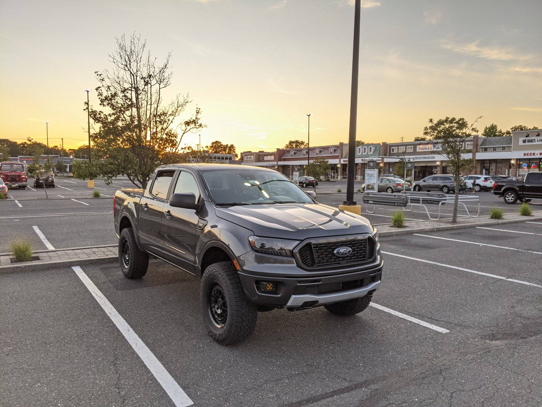

see my post two posts above, KMC canyon's, +20... everything you're looking for. I am running a 285/70/17 though.
Stock offset is +55. The 265 isn't much wider. I'd imagine the +35 would do it, the +20 has a decent amount of poke from the fender. If you find my build thread there are more pics.
EDIT: also, +35 to +20 to +0 is pushing the tire further and further out. You will not need to modify anything for that tire width. I'm 99% sure guys are fitting 265's on the stock wheels but could be wrong.

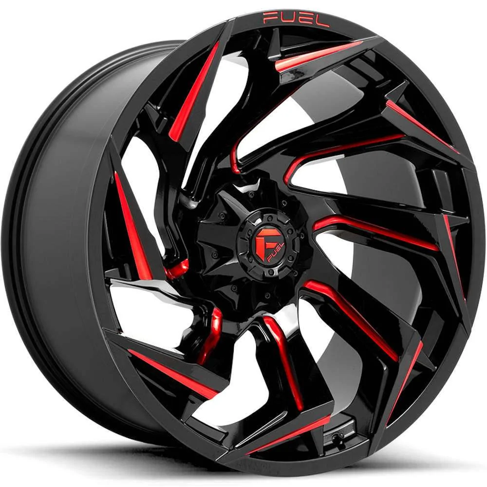

I'm looking at these fuel wheels for my truck. I'm curious what everyone's thoughts are on potential fitment issues/offset. I have the rough country leveling kit in the front. I'm looking at 18x9 and keeping the tires I just bought which are 265/65 18 ridge grapplers. The problem is they only come in +1 or -12 offset. I know the factory offset is +55. Any input or thoughts would be appreciated. Not looking to cut anything at all. Any modifications necessary I would rather run the 6in lift.

Plenty of guys running 0 offset here. I would search and compare to those. Gonna have a decent amount of poke and could potentially run into issue with the crash bars.
Wheels look fun though!

I was running 265 75/16 KO2 on 16x8 wheel zero offset, they slam against the front and back crash bars. This setup will most certainly hit the crash bars unless you have a big lift. I only have 2" lift
