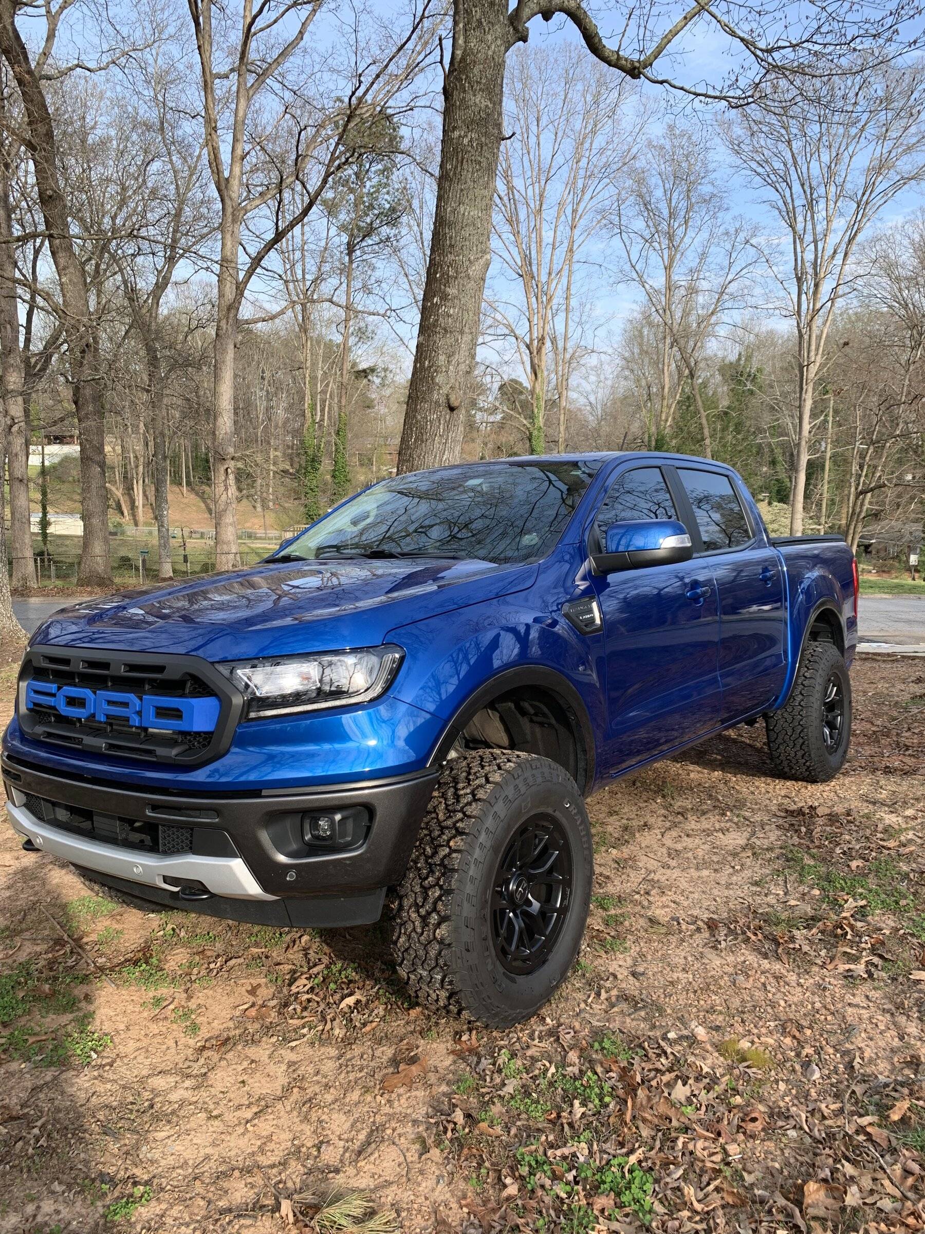

looking to see 17x8.5 0 offset with a 265/70/17. i have a 2.5 level in the front. got wildpeak at/w3 on order
17x9 0 offset and 275/70/17, figure this would give you a close idea. Got a front lift around 2.5” I forget what exactly the Eibach settled at.

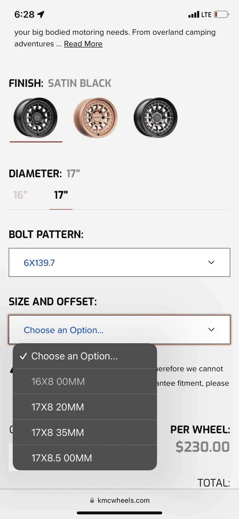

could use some help here!
Tire Size: 255/75/r17
Lift: 2.5 front, fox 2.0
I’m deciding between 0, 20, and 35 mm offset wheels. (KMC Canyons). My ideal stance is a tiny amount of poke, or flush, with the stock fenders. I’d also like to avoid having to cut the crash bars or do any trimming.
which offset wheels should I get?

I have a 3" level. My wheels are 17"x9" with a +1mm offset. They stick out around 2".

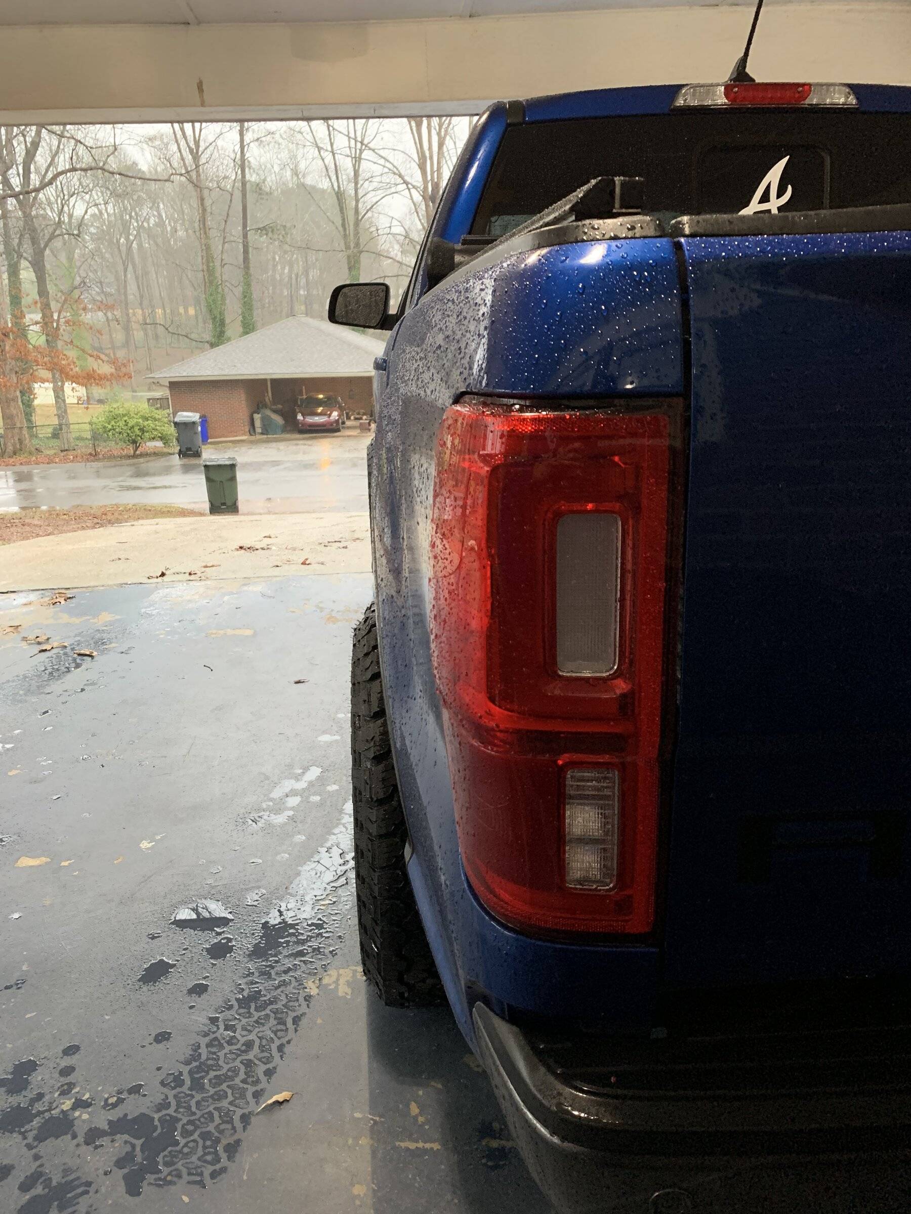

Did some fuel 20x9 with a +20 offset. Tires are a 275/55r20. Heard a little scrubbing backing up today full lock. But nothing bad. No issues going forward.

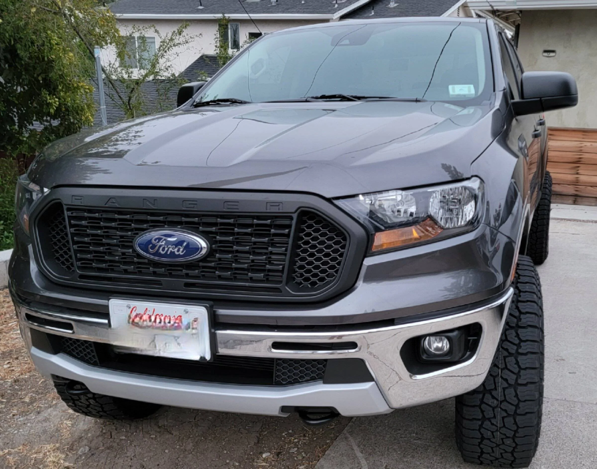

Ok i have seen the wheel size on the exact rim i have. So question for those that have them or have had them.
255/75/17
No rubbing???

I had a 2.5" leveling kit stock rims on a STX 4x4. Zero rub for me.
