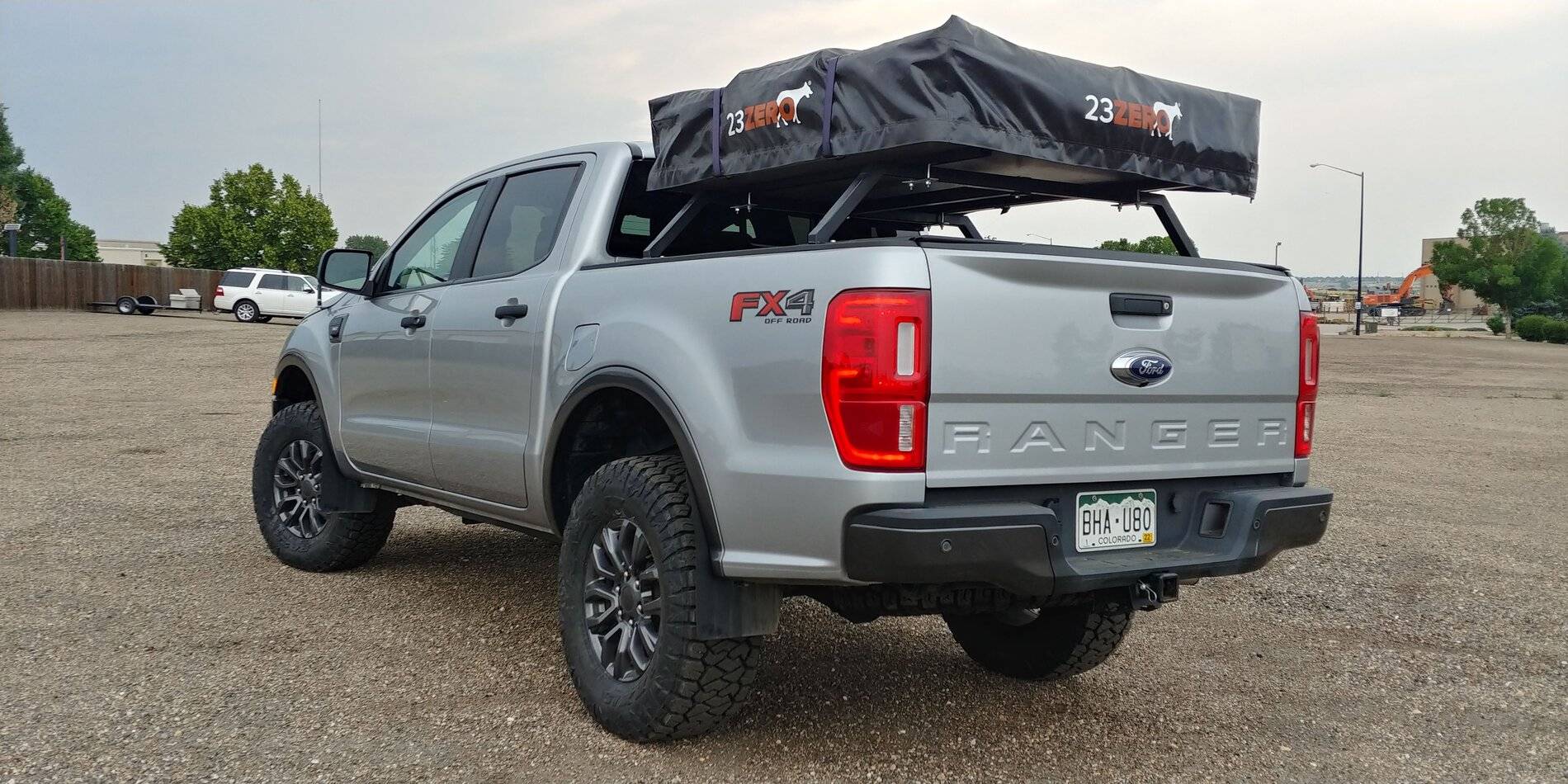

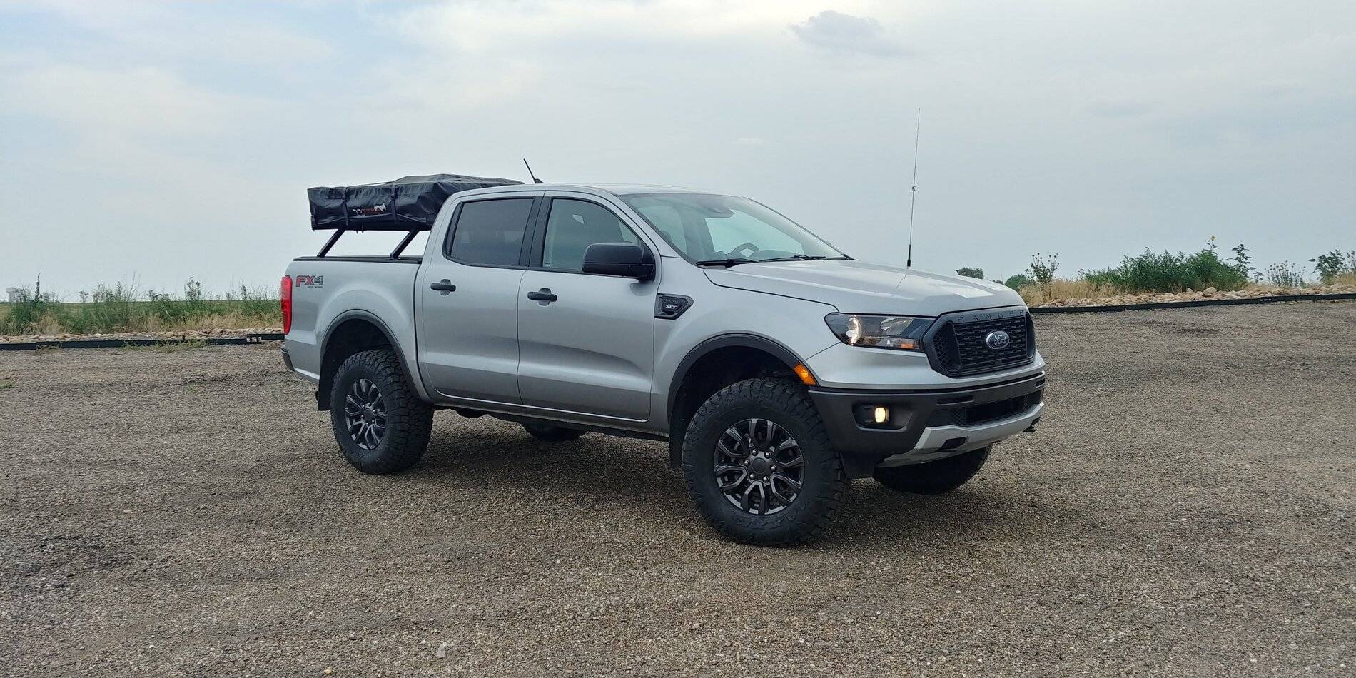

I am stock FX4 height. I rubbed on the intrusion beams in reverse. I did not use spacers. I ended up swapping them for 265/70r17s. With a lift, you would probably be okay, but I would have had to remove the intrusion beams and I wasn't ready to make that leap. At stock height, I also worried about rubbing offroad.

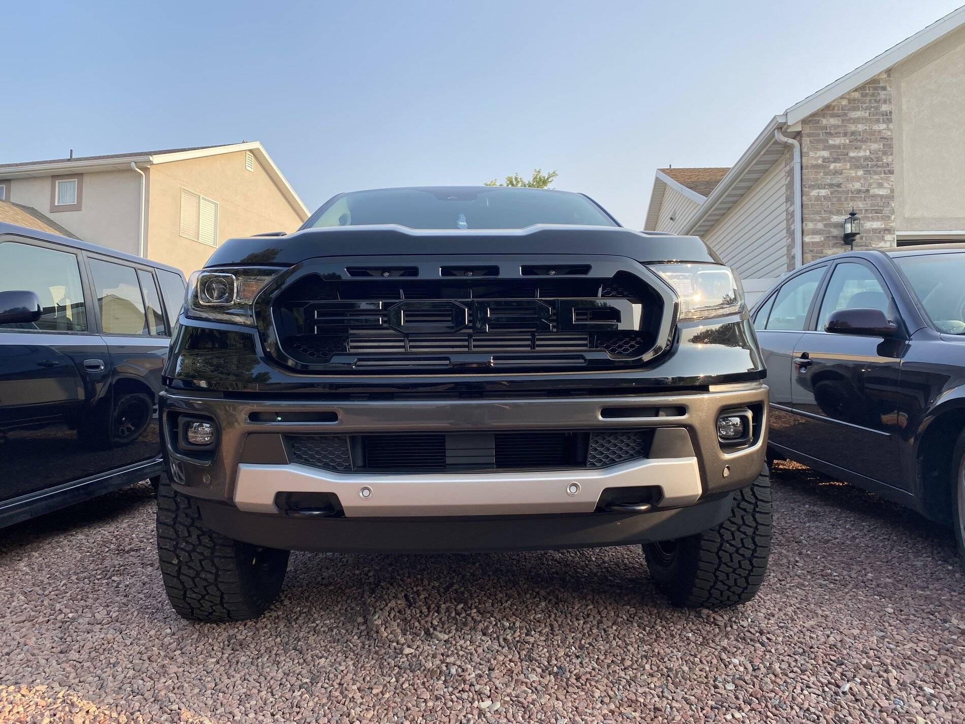

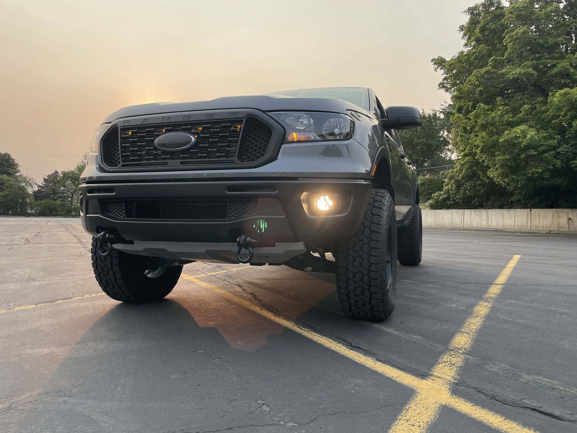

I think I posted in this thread. I went ahead and got the wheels and tires. Turned out exactly as I wanted and it barely clears the Intrusion Beams. I plan on replacing them because it’s a lil to close and runs if I punch it in reverse.
Wheels: Fuel Vector D579 17x8.5” 7mm offset
Tires: Falken WildPeak A/T3W 265/70R17
Thanks for posting these. I just ordered 17x8.5” 0mm offset with the same tire size. I have been stressing because I haven't found much with close to 0 offset and a 265/70/17 tire. Could you post a whole front end picture if you can?
No problem do you want just a shot from the front? Or a side shot showing how much they poke?

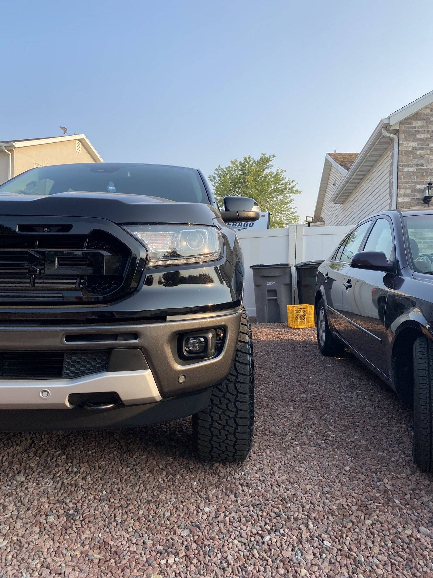

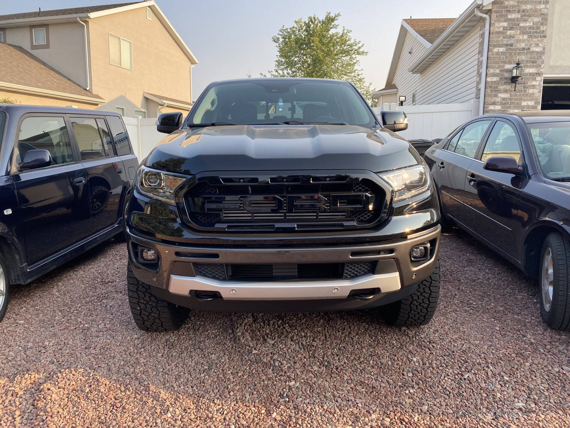

here you go let me know if you want a different angle or got questions.

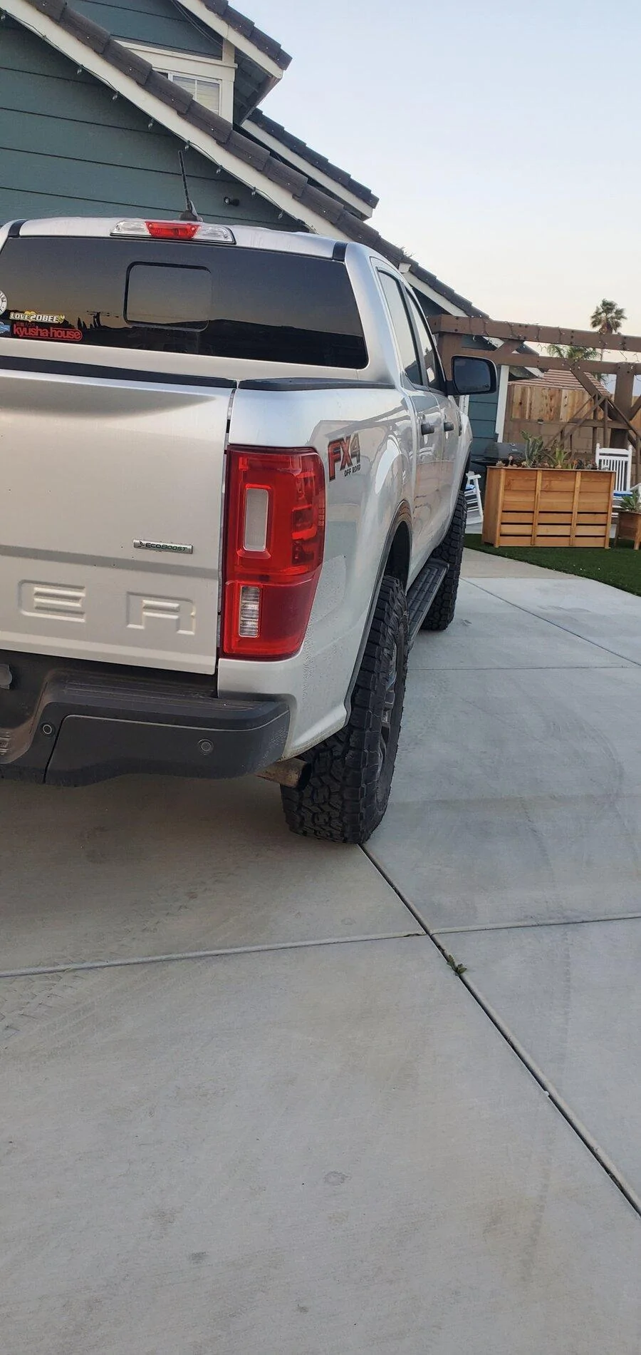

BFG KO2's 285/70r/17 rims are 17x8.5" (+0 offset) race relations RR6-H. Fox 2.0's, modified intrusion beams.
Any details on what intrusion beam modifications you needed?? I actually got the same wheels (RRW -RR6H), Fox 2.5's and am trying to decide between 285/70/17 and 285/75/17. I'll have BDS intrusion beams in front and rear, but trying to figure out if the 285/75/17 will actually fit without rubbing.
I've seen other members fit a 285/75/17 with crash bars removed, so that's always an option too I guess.
