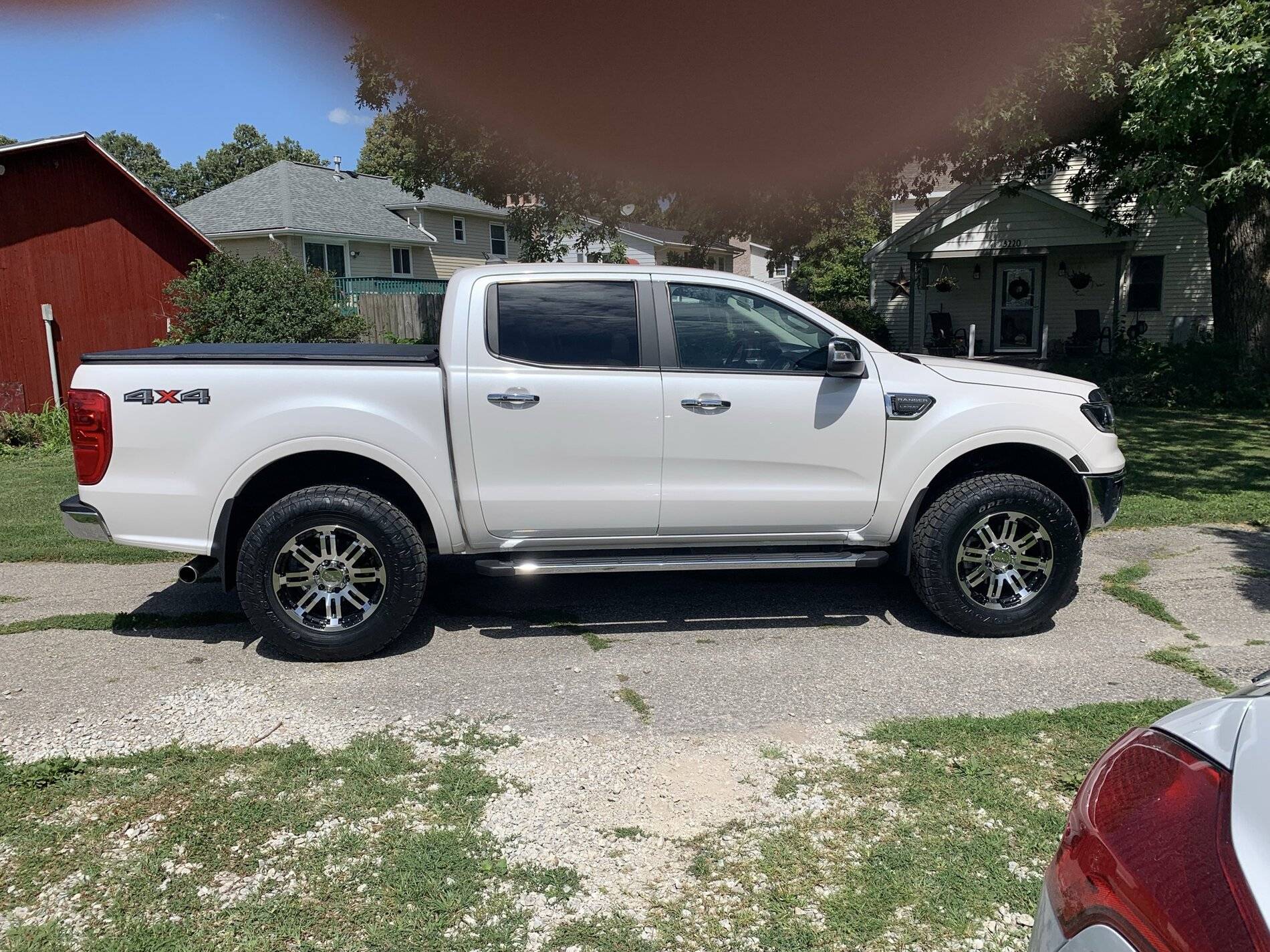

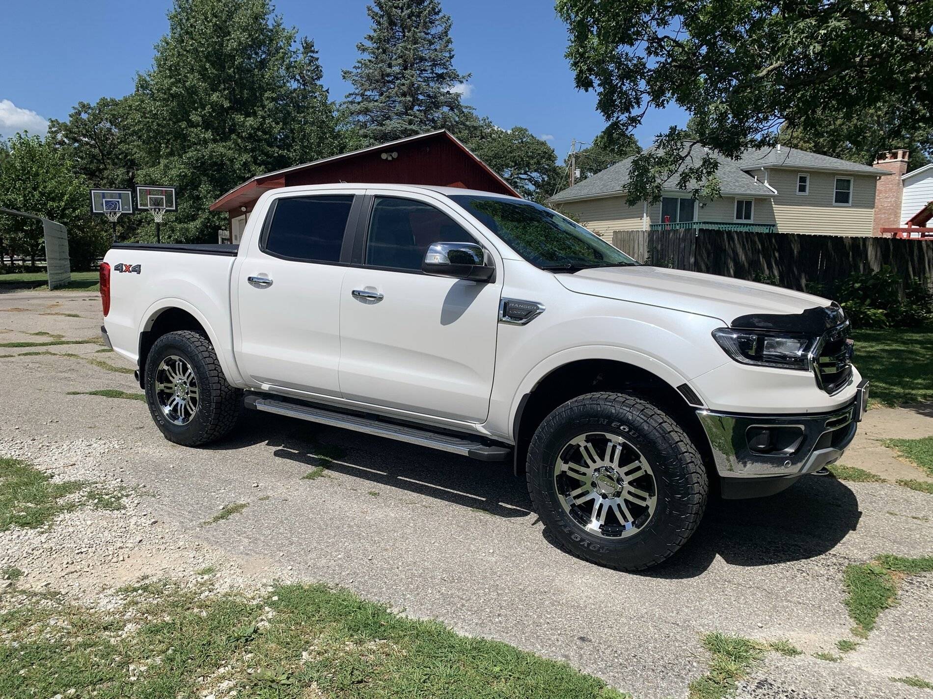

Toyo Open Country AT/III 265/70R18
Vision Warrior, 18x8.5, +25 Offset
2” Zone Off-road Level
Crash bars removed, replaced with Ready Lift Anti-Intrusion Beams
No spacers
No rubbing

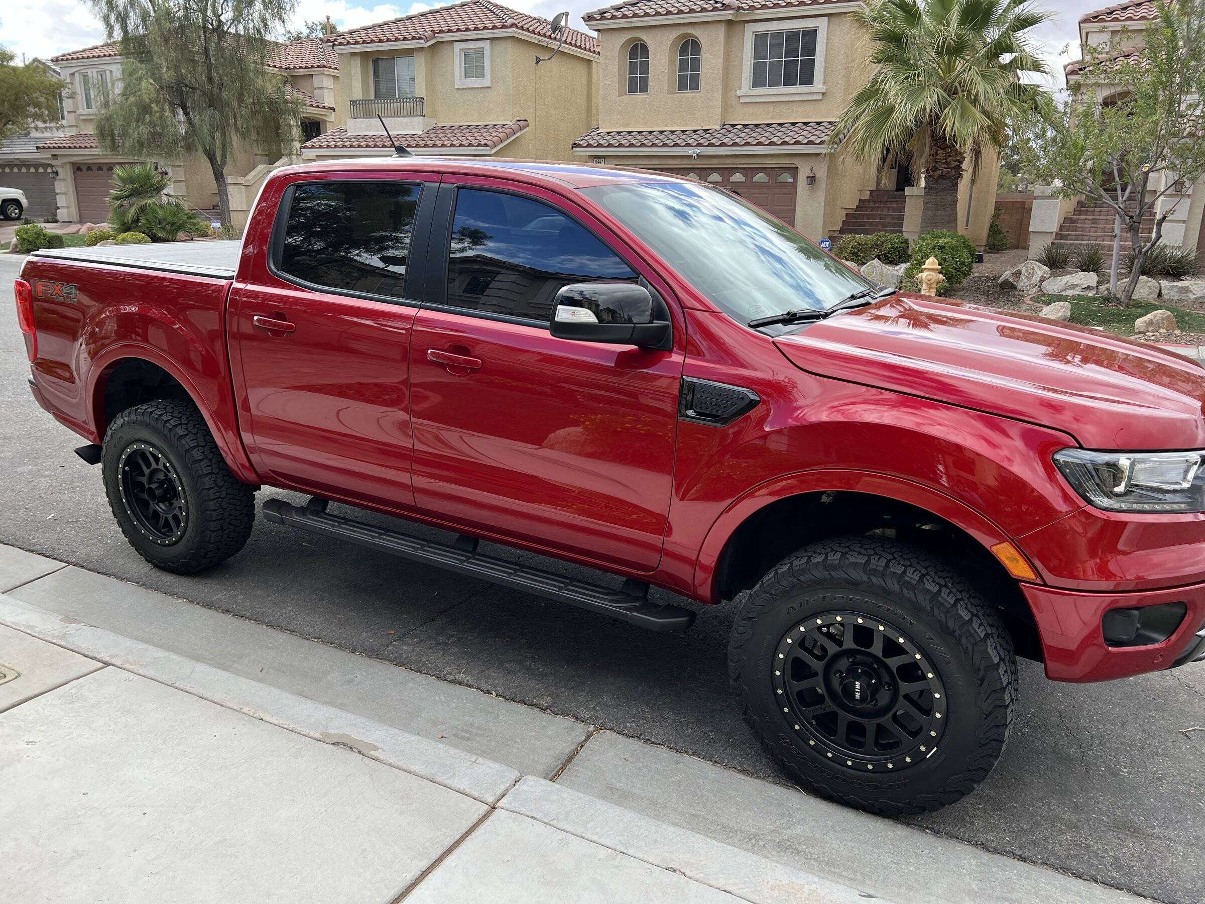

18" Method 309/Grid/Matte Black +18 offset, BF Goodrich All Terrain A/T KO2 LT275/65R/18LR. Readylift SST 3" Lift. Readylift high clearance intrusion bars on front. Damper enhanced.

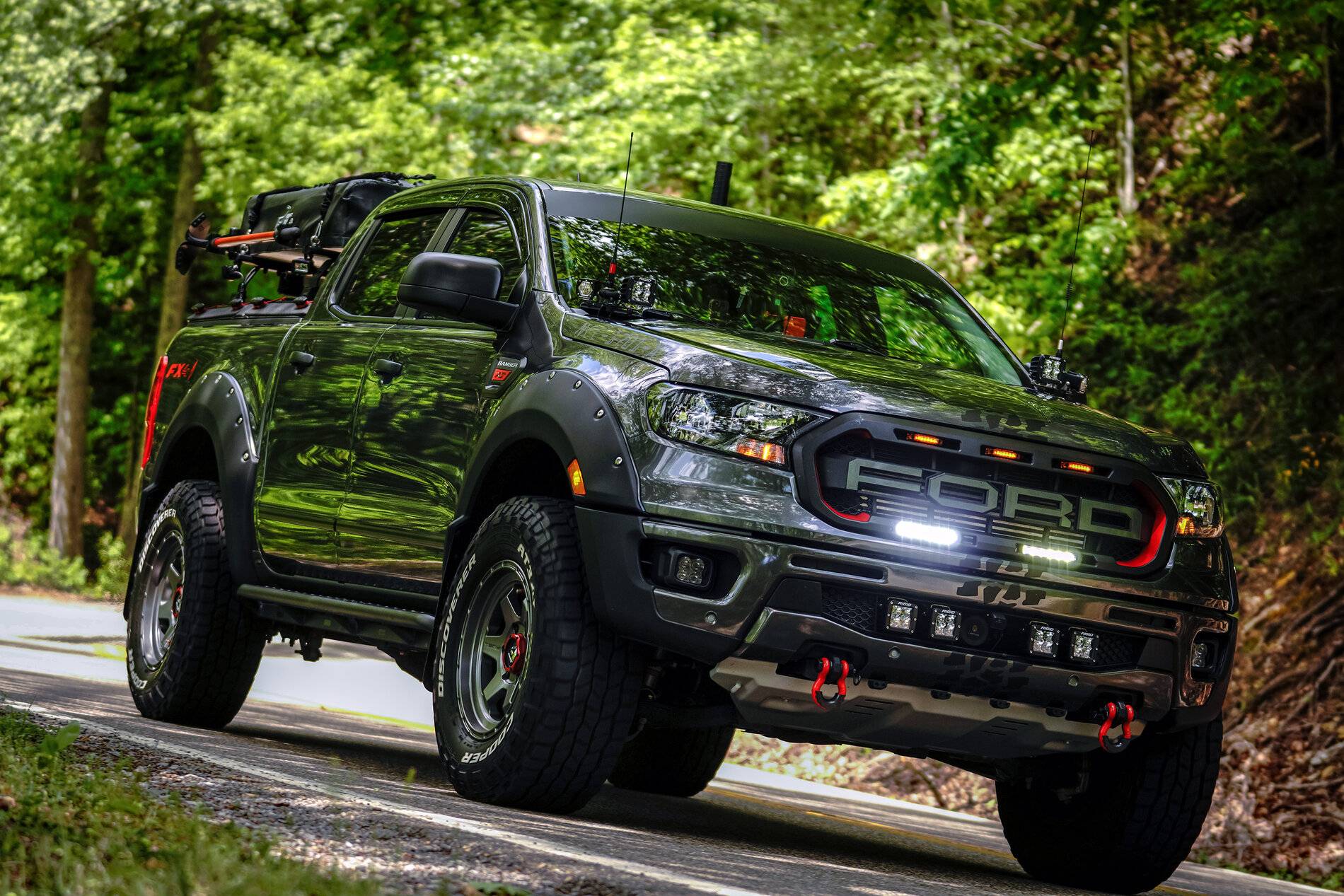

Picture taken on the Tail? Is Killboy still snapping and posting?
Yes and yes! There're two, maybe three other shooters out there now but KB still have the best quality...?
