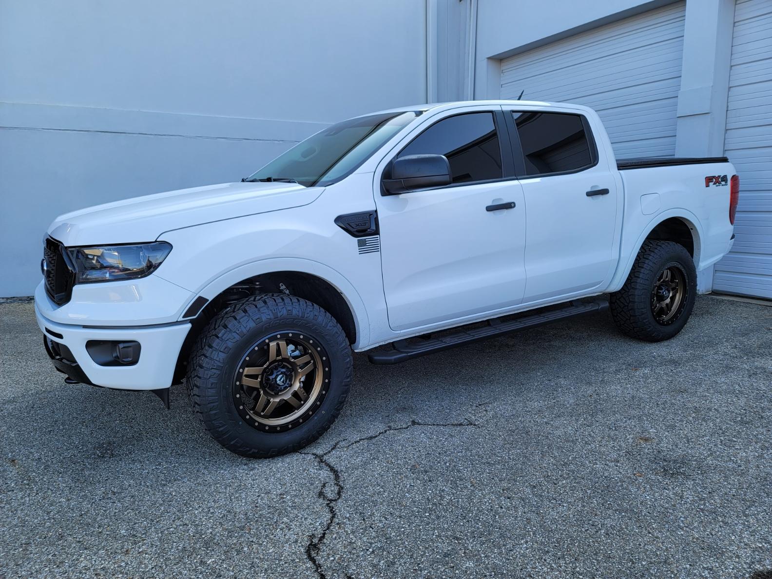

New to the Forum and just read through this ENTIRE thread...The configuration I am considering is a set of the Fifteen52 Analogs in the 16 x 7.5" / BS 4.25" / 0 Offset size. Mounted to a set of General Grabber ATX 235/85/16's. Will also be adding an ICON Stage II kit adjusted to 2.5 (level) in front and 0-1/2" lift in the rear. I'm fairly confident I will not have a rub issue but my concern is with POKE. I do not want the tires to stick out beyond (or much beyond) the fender. The tire is tall and narrow 31.7" x 9.3" but the rim is only offered in 0mm offset. Can someone check my math and advise. Cheers

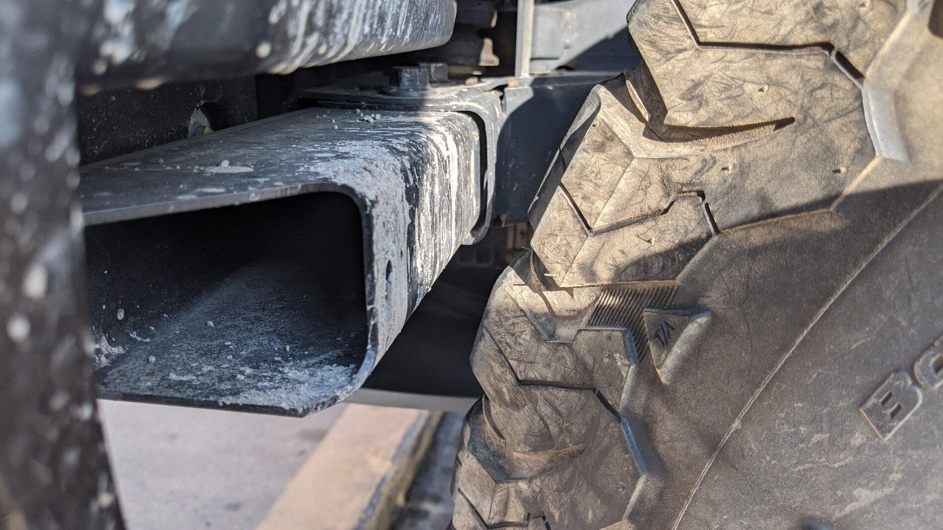

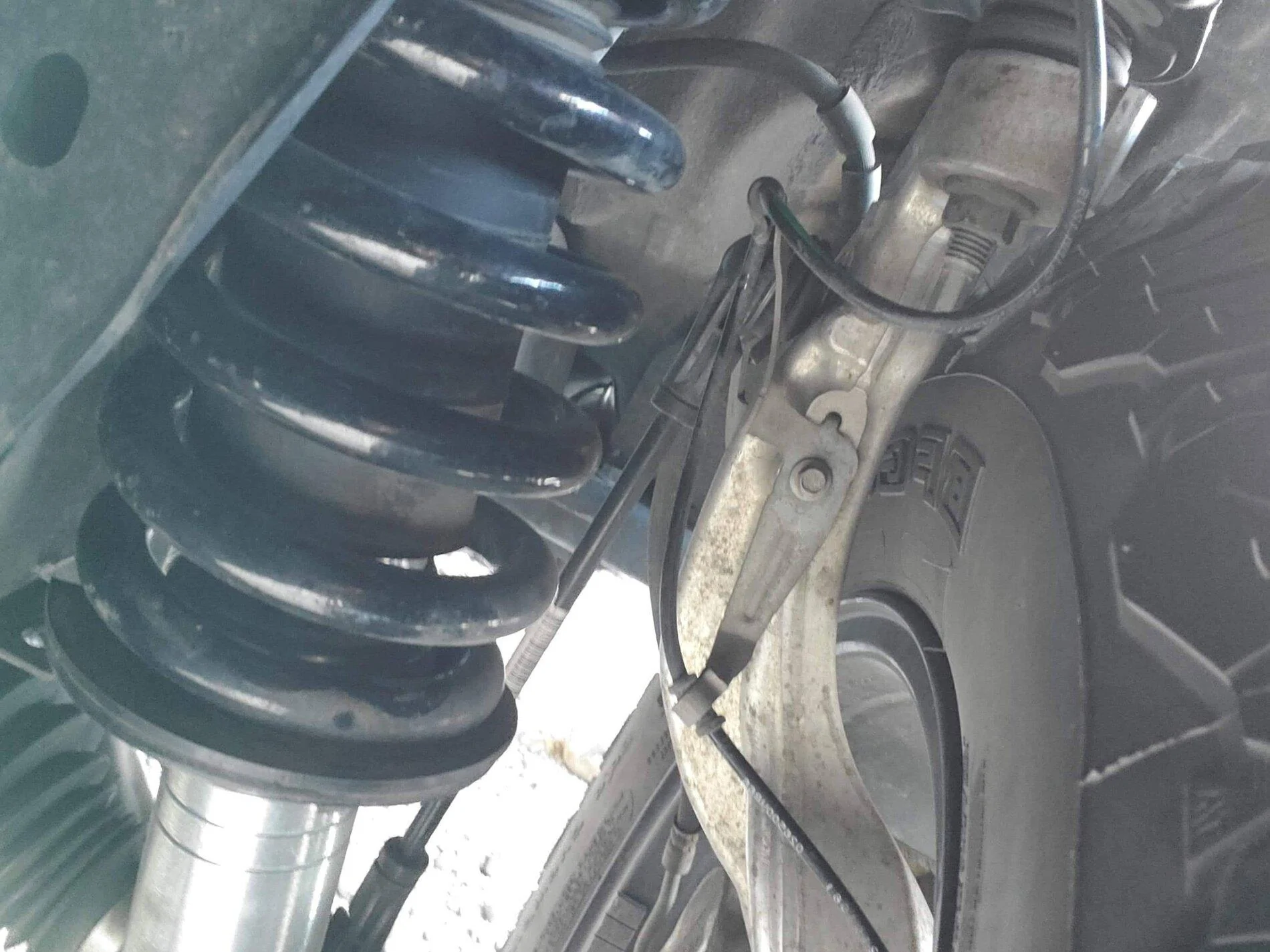

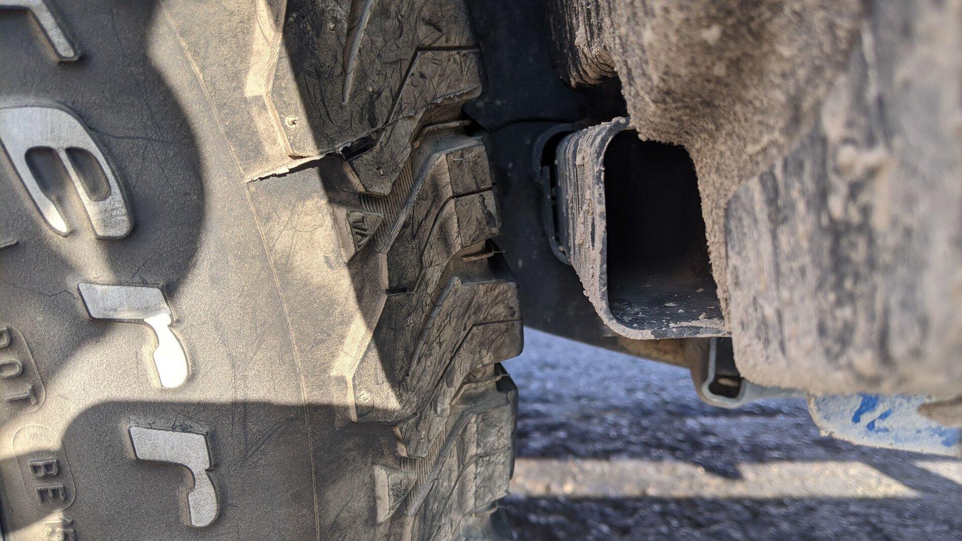

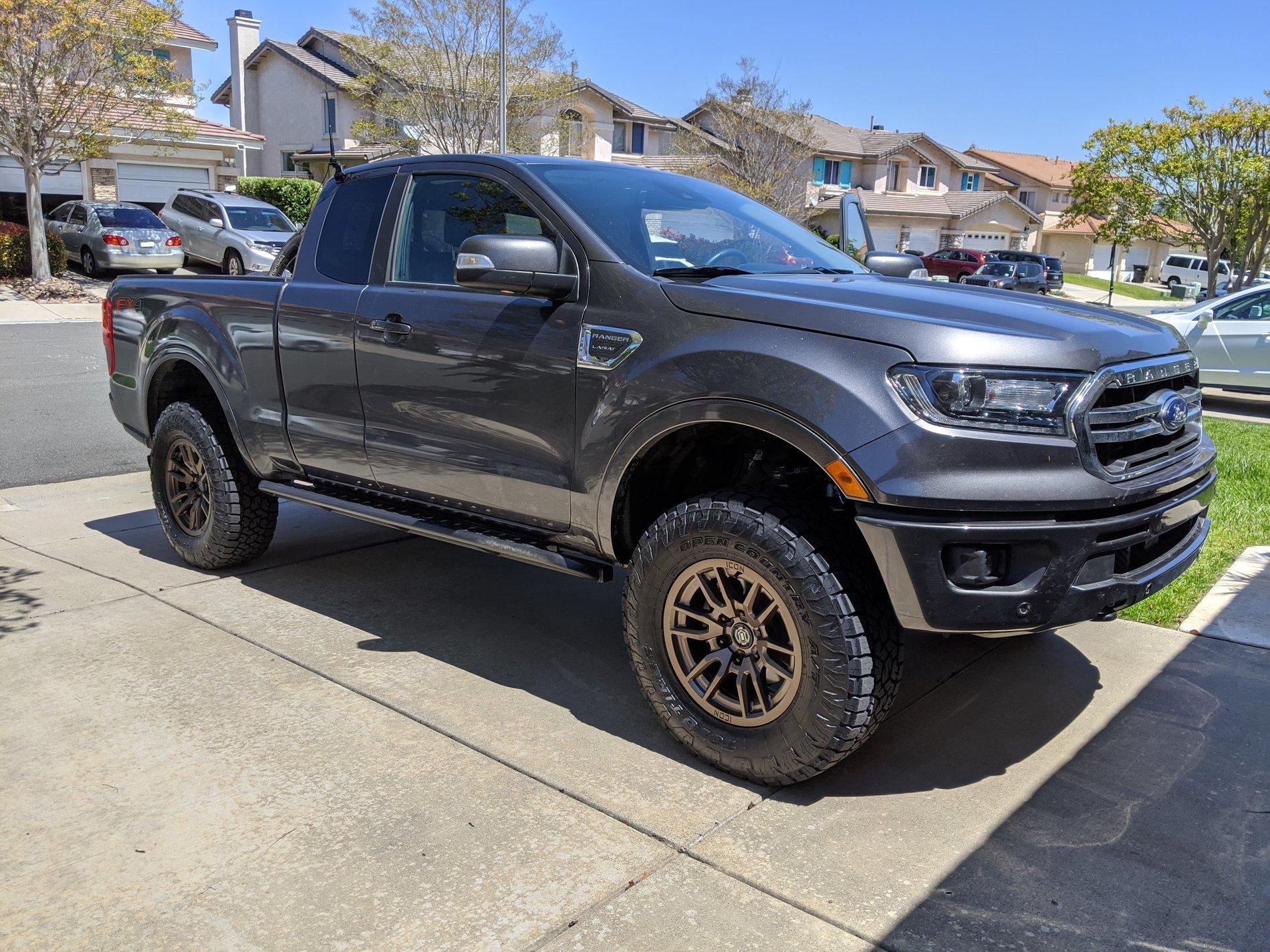

I've had a few questions since I posted in the off-road pic thread so here's my setup.
I'm running BFG K02 275/70/18s (~33") on stock rims with the Bilstein 5100s on the highest setting. They are suuuuuper tight but so far no rubbing even after some mild off roading in Moab.
Here is how far I am from the knuckle:
I can just about get my fingers in-between the knuckle and the tire at it's closest.
The stance is near perfect in my opinion.
Here's my crash bar tolerance. This is driver's side, full right lock at the front crash bar.
Here is the rear crash bar, still on the driver's side, but full left lock.
I'm sure if I got to full compression, I'd have some rubbing but I'm fairly convinced this is the absolute biggest you can go on stock rims with a level.

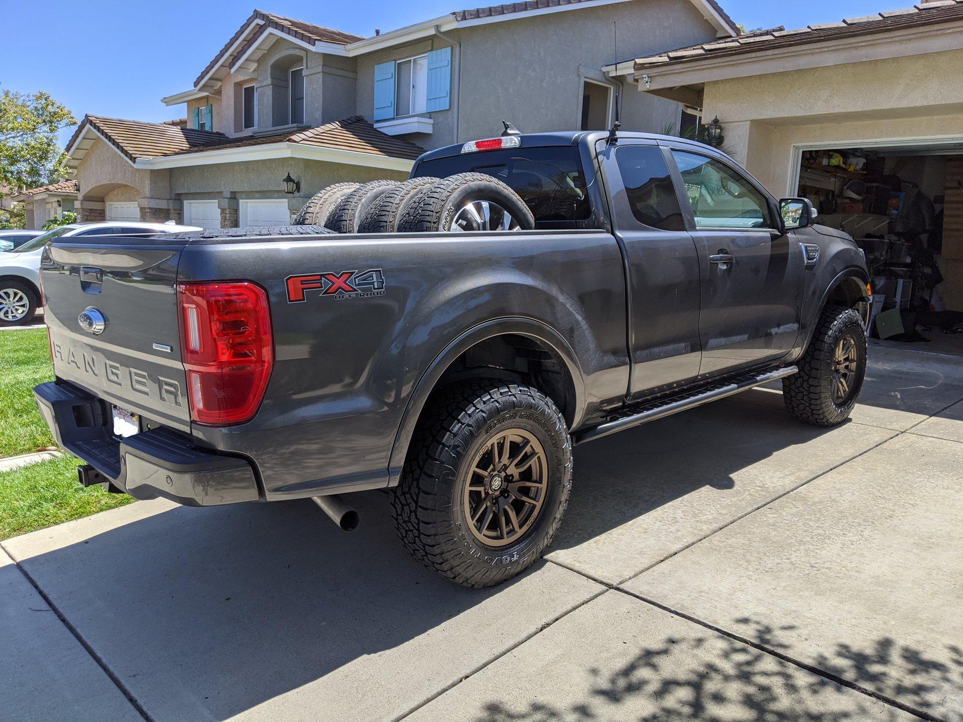

Didn't go as daring as others, but haven't seen anyone else with this size so thought I'd throw in for reference.
Old tires: Stock 255/70/R16 Bridgestone Duelers
New tires: 265/70/R16 Falken Wildpeaks (+0.5" same size as stock 17")
I dig the look more than I would have thought. Might not even upgrade to a 17" wheel, currently running the base level steel wheels rattlecanned matte black w/matte clearcoat.
sweet mod to the stock rims. love it

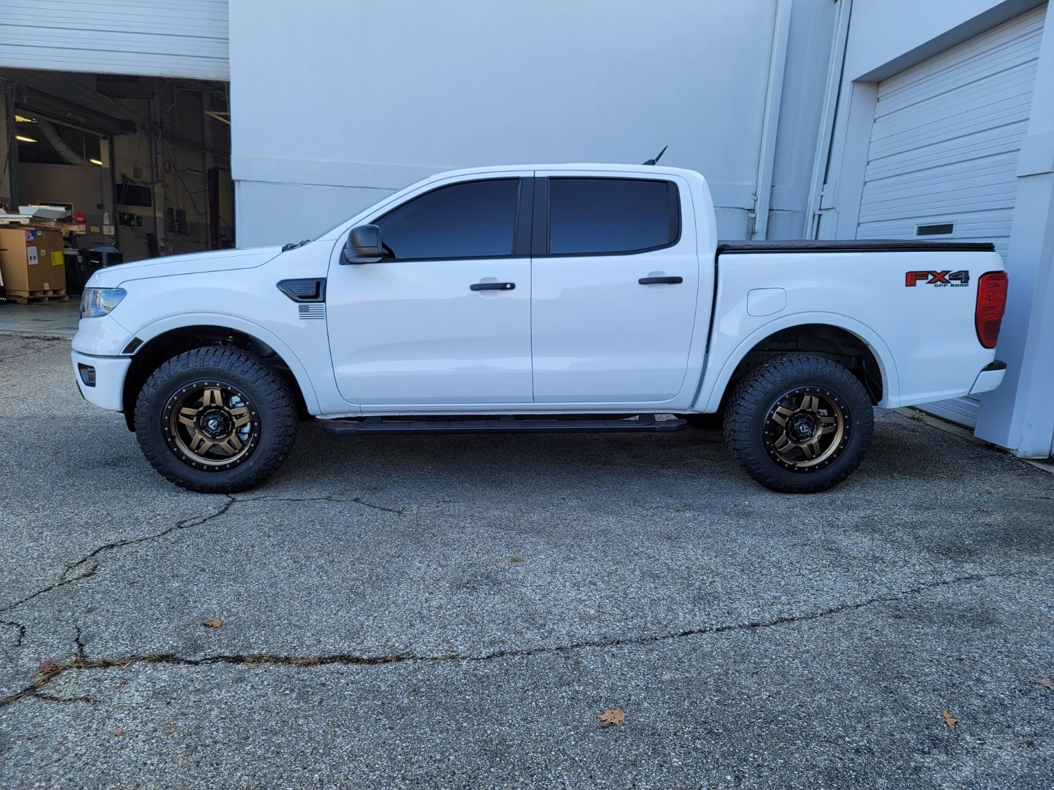

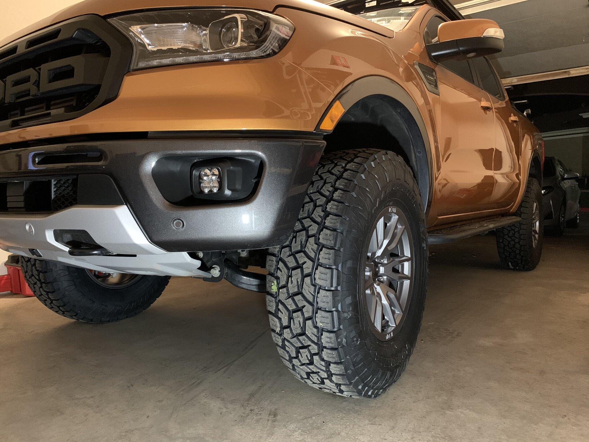

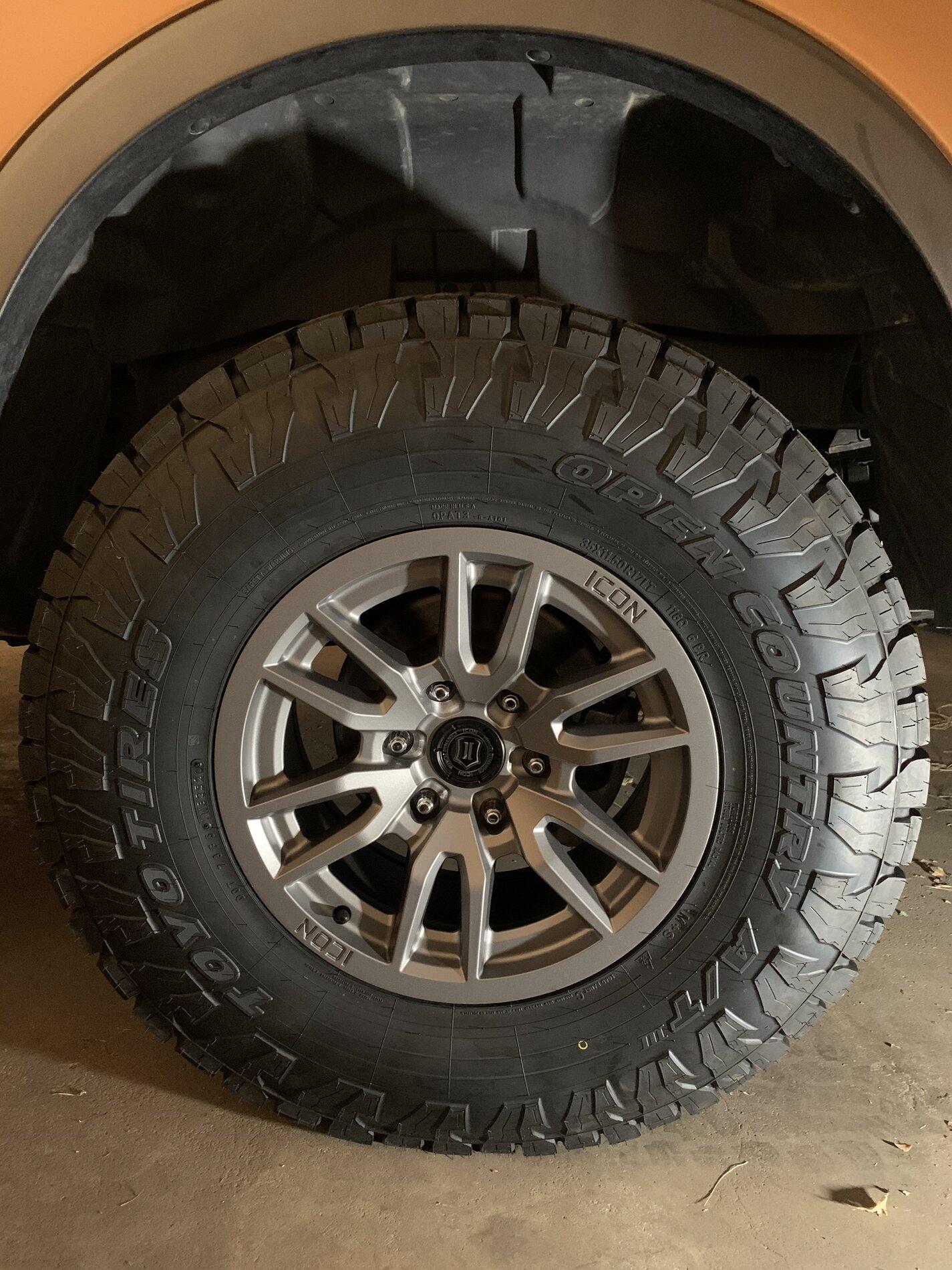

Installed the new Toyo Open Country AT3s, 285/70/17 C with Icon Vector 6 wheels today. BDS intrusion bars replaced in front of the wheel, but the rear-of-wheel intrusion beams are stock. No rubbing with ~1" clearance in front at lock and ~1/4" in back.

Dude this truck looks great, lift, wheels, tires. I'm considering 275/65 r18 vs 275/70 r18 with a stage 1 fox 2.0 lift on my 2020 ranger fx4. Grabber atx tires.
I agree - looks about perfect, you got any overall shots of the truck?
