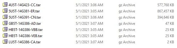

For my VIN which has Navigation, the update is available on the Ford Owner website and includes 7 files.
I did not get the *-CC.tar file.
Any thoughts on what that is?
'19 Lariat w/NAV. NA 119 and 3.4.20282
Thanks.

I thought that was the license file? What the hell is gracenote? :)
In the context of our truck, I think Gracenote is the music database used to improve voice recognition of artist and album names - it's usually used by audio systems to identify artist, album and song names.
That technology has been around for a while and is used in all sorts of consumer electronics and software.

It's the music meta data, like the artist picture, etc.
These.
