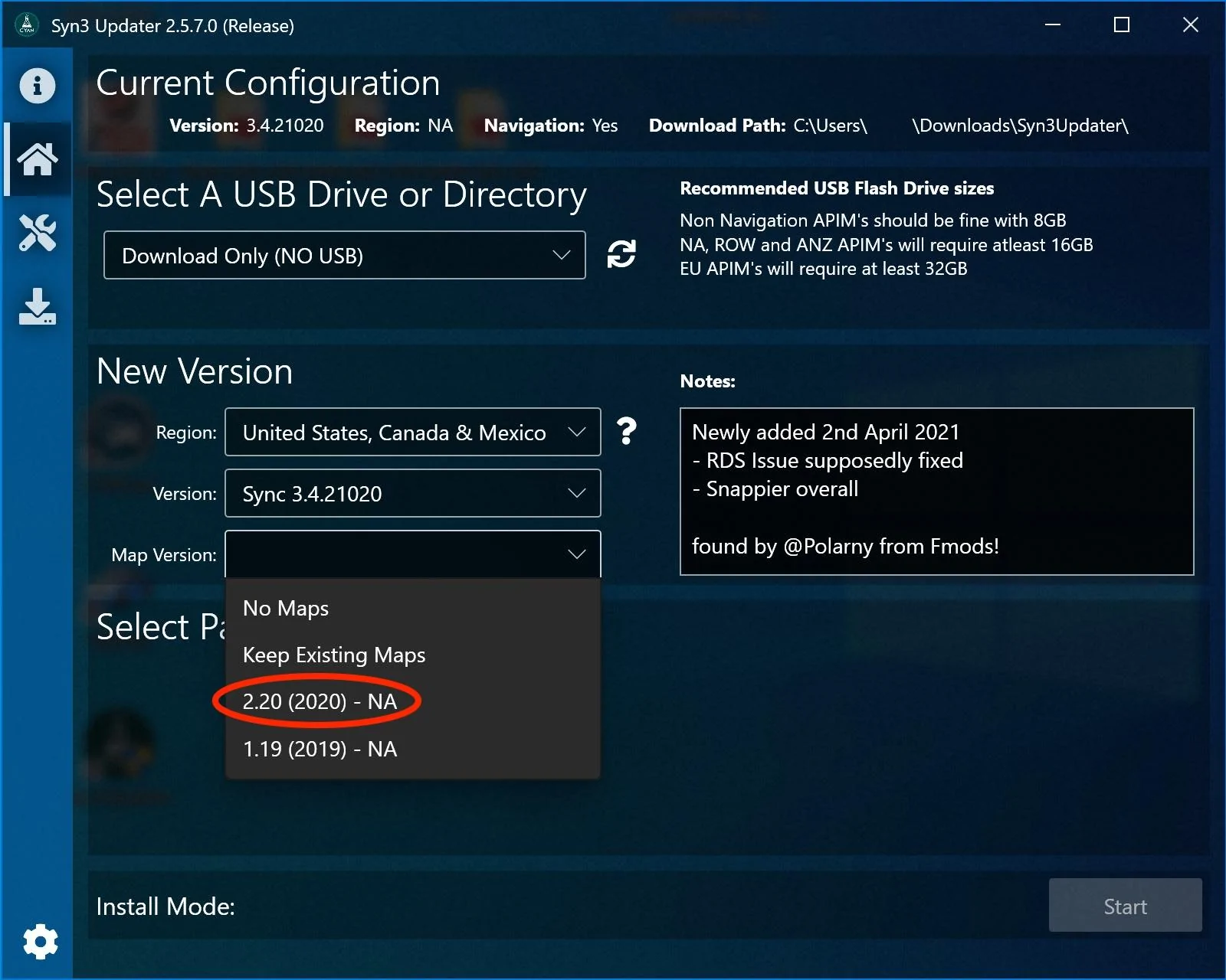

Since posting my question, I ended up testing the app "Syn3 Updater".
Was wondering if anyone knew what was that 2.20 version they are listing?

Good question, I don't know. From what I've read 1.19 is the latest and doing a check for updates over wifi showed mine is up to date with 1.19. Now I'm curious too.
The plot thickens:
I went onto https://syncnavigation.com/ford/home, typed in my VIN and ESN, and it told me I had a map update available. So I placed the order (at no cost since it's a download), I downloaded the ZIP (12.3GB) and proceeded with the update using a USB stick. Took its sweet time. I came back to a successful update, and it was still showing on NA119 running on 3.4.21020... Not sure why it told me there was an update in the first place.
So I called the number provided in the email confirmation (https://syncnavigation.com/ford/contactus)
Questions on Map installation and/or SYNC® 3 software updates for your vehicle
Please contact the Ford CRC at (800) 392-3673
The rep confirmed that as of today, the latest map version is NA119.
So not sure what "Syn3 Updater" is referring to. Except if maybe it gets access to updates somewhere in a backend, before the Ford websites and reps even do. It's possible; I'll try all this again in a few days.
The end.

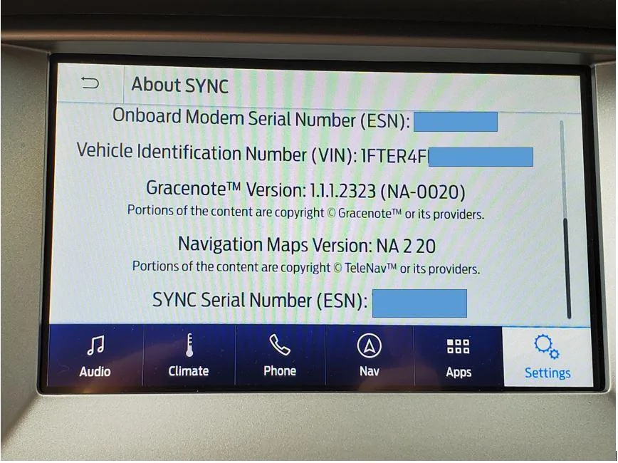

The latest map version is NA 2 20 but it is only available OTA - currently not available through the Map update website
Your sig indicates that you have a 2019.
Did you get the map update for free?
Ford wants $40 to update my 2019, which is most certainly not going to happen.
