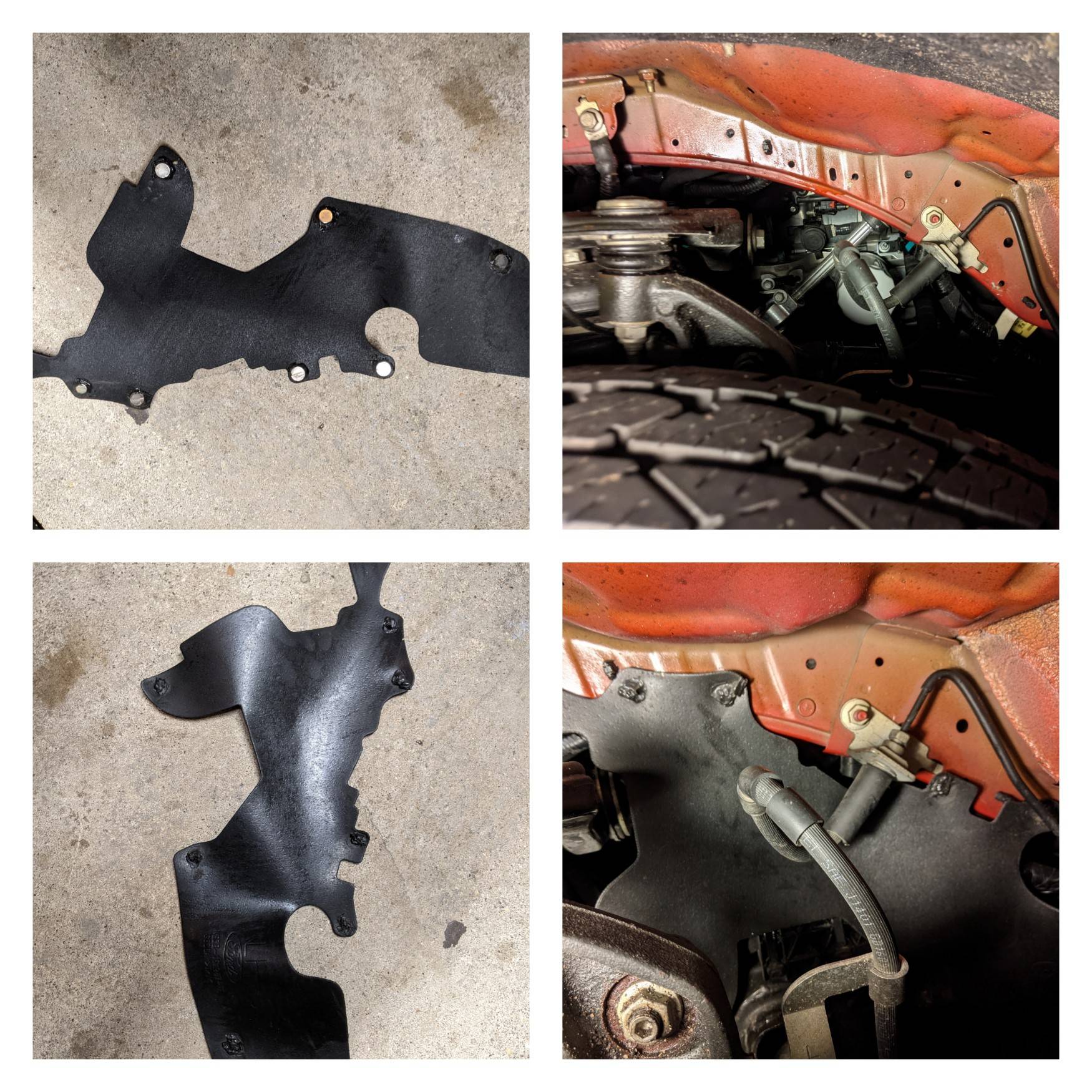

Sharing some learning here.
I totally buggered the plastic trim rivets for the rubber flap over the oil filter. I found the parts diagram, but the call outs for the plastic rivets didn't have a p/n.
So I called the dealer and ordered some. $8.54 ea. Surprise?
p/n W715694-S300. On my second Google search I found them for <$3.70 ea.

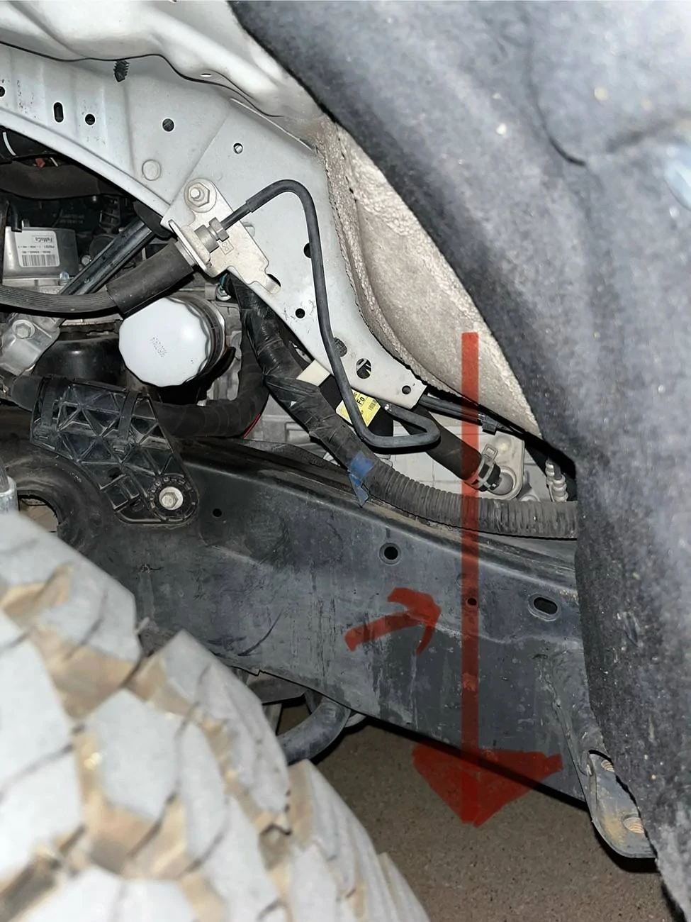

Little tip when you go to move the drain pan from the plug to the filter, center your pan from front to back under this little hole in on the frame rail. I haven’t missed a drop out of there since I figured this out and my drain pan is small. I have a picture and just edited some arrows in to show ya exactly what I mean.
Edit: This is for a 4wd, probably not the same front frame rails on a 2wd, not sure. But once you risk it once you can figure out a spot.

Thanks, that's helpful. I made a big mess the first time.

I let the main sump drain for at least an hour and simultaneously place a smaller catch pan right where you indicated for the oil filter spout to catch drips behind the sub frame...
