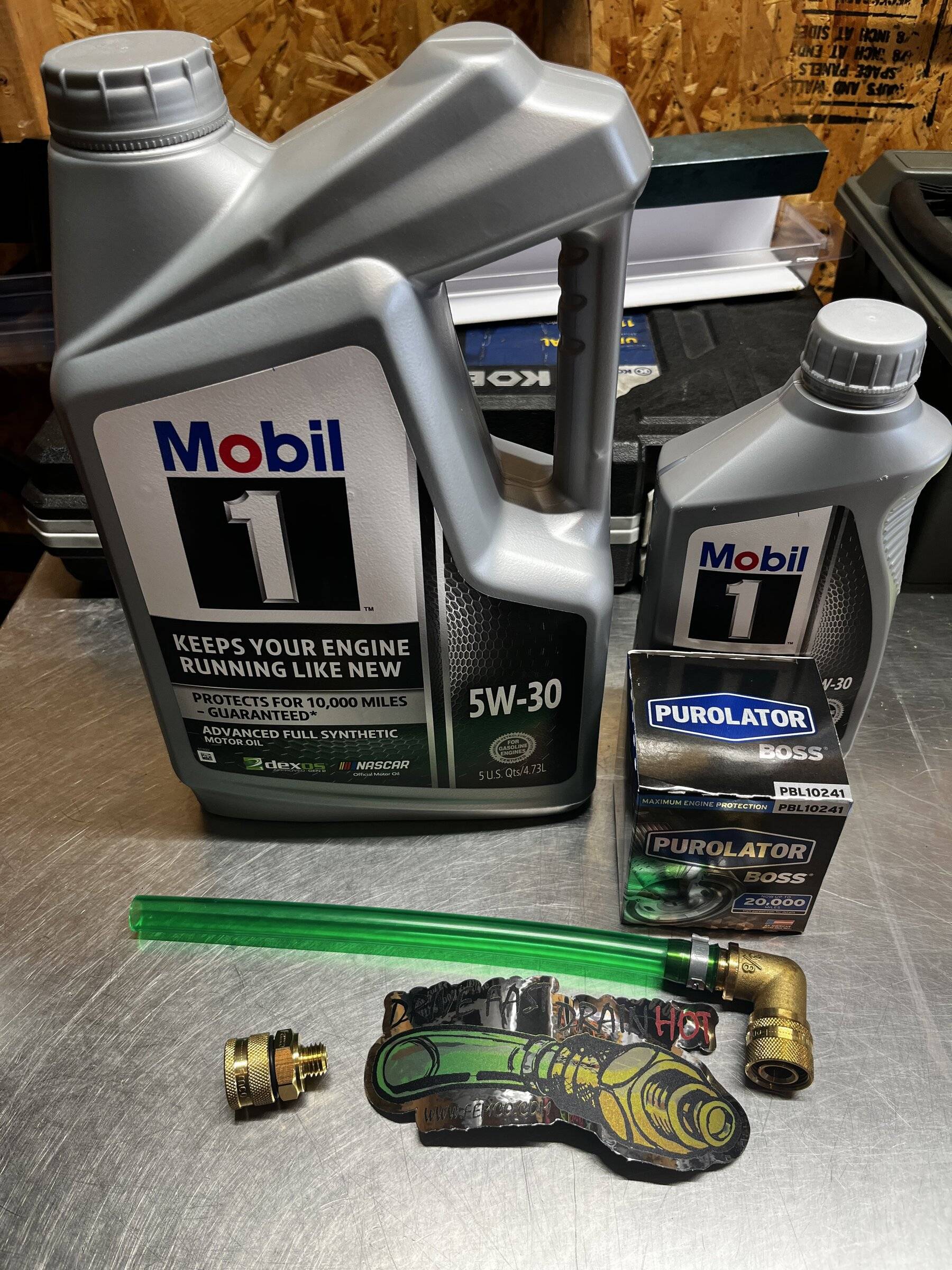

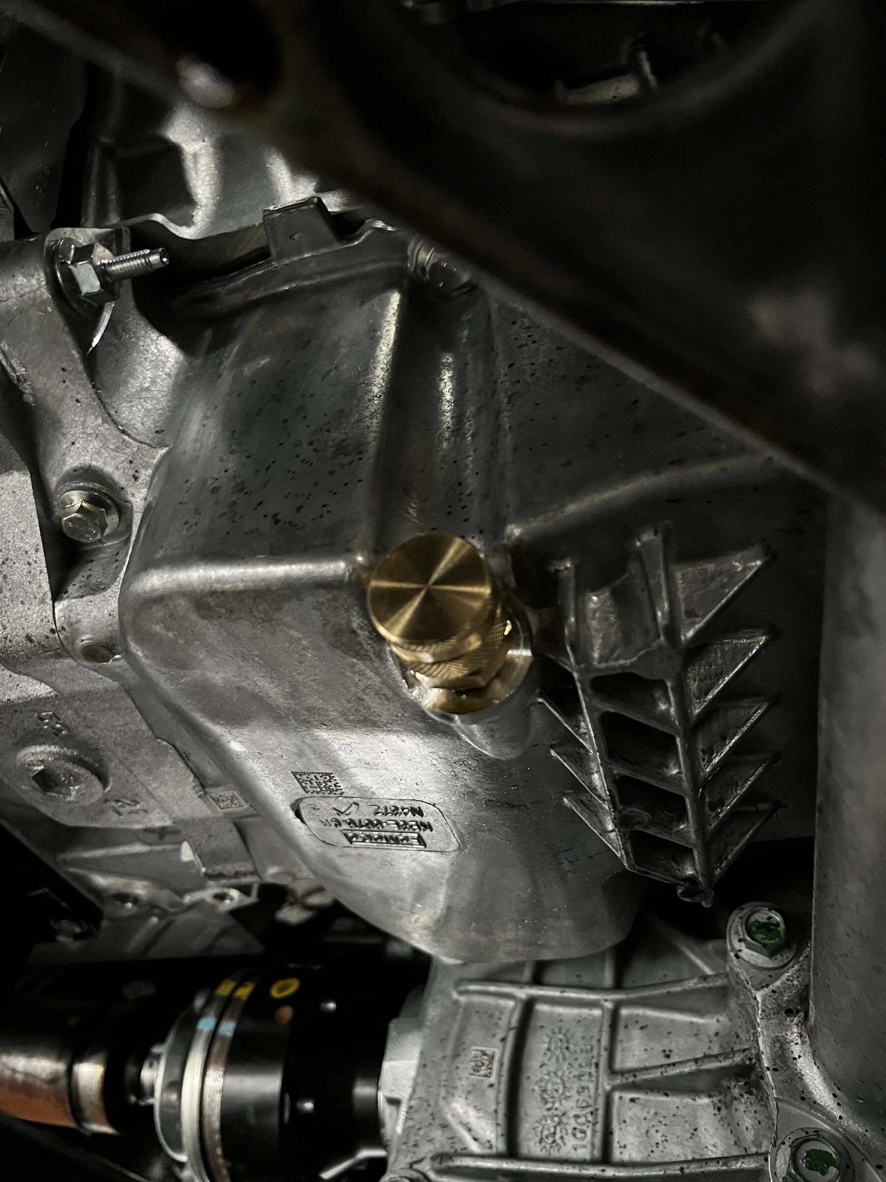

Femco oil drain valve installed! I also had a fuel smell to the oil and it was over 6.2 qts when it was emptied. Will probably change in another 3k to see what it looks like second go around.

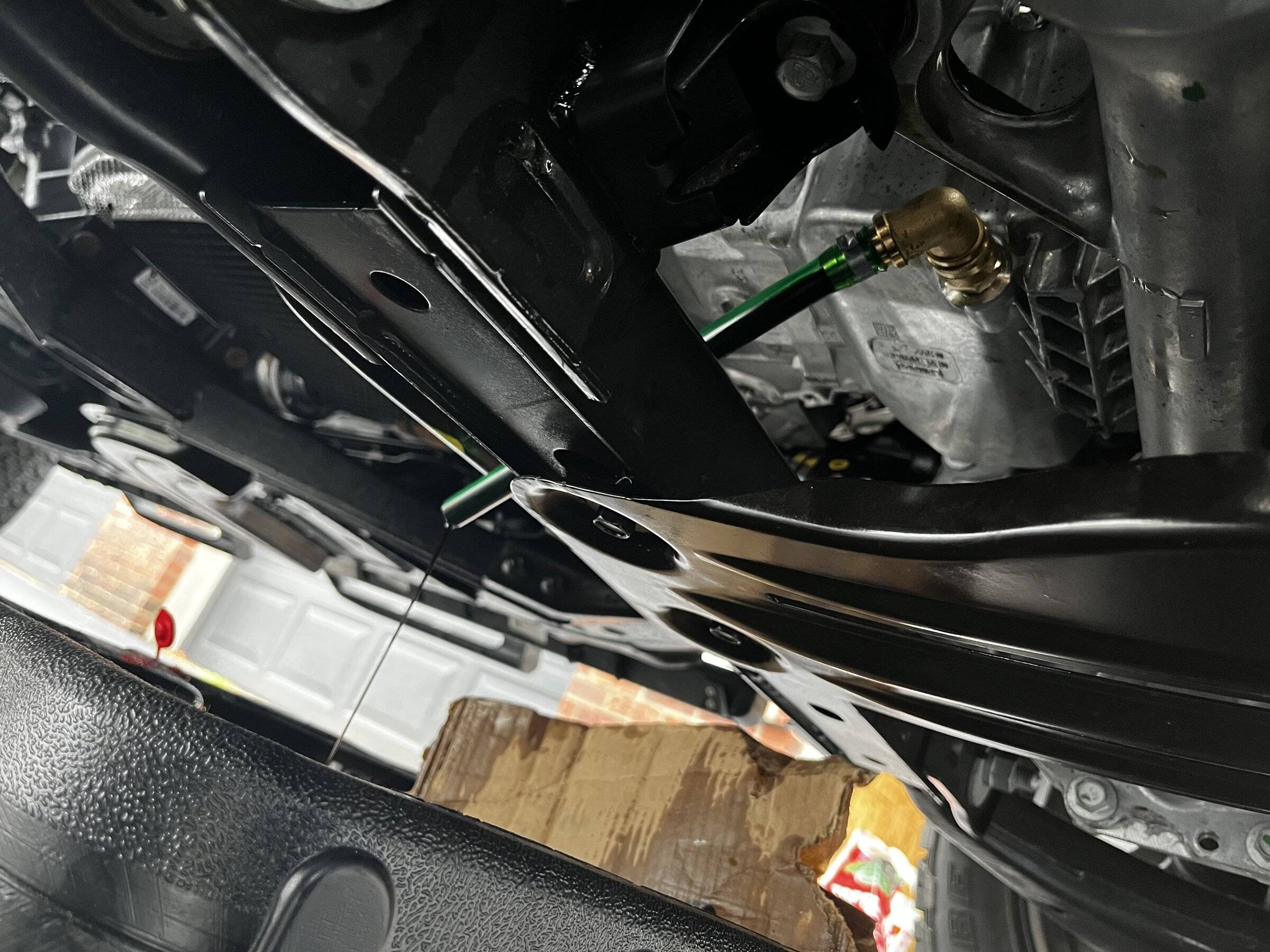

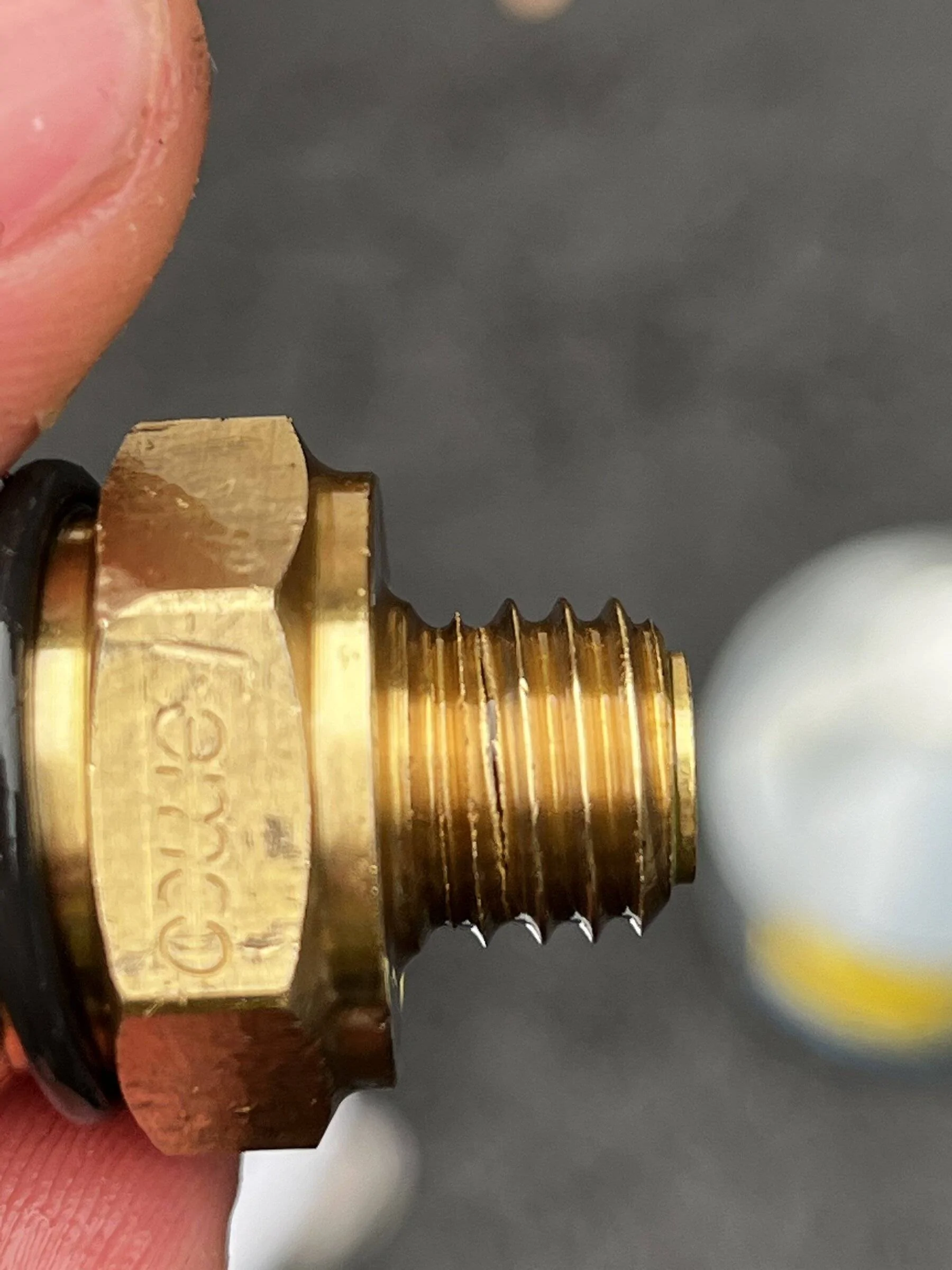

Well Femco was a bust. Stuck a box under the truck to check for leaks and sure enough here is what I found.
Oof. That's not a reassuring performance out of your new drain valve. I'm on team Fumoto - really like my drain valve, never had it leak.
Glad you were able to save the oil!

I had a fumoto before and it worked fine. Might just go back to that one
