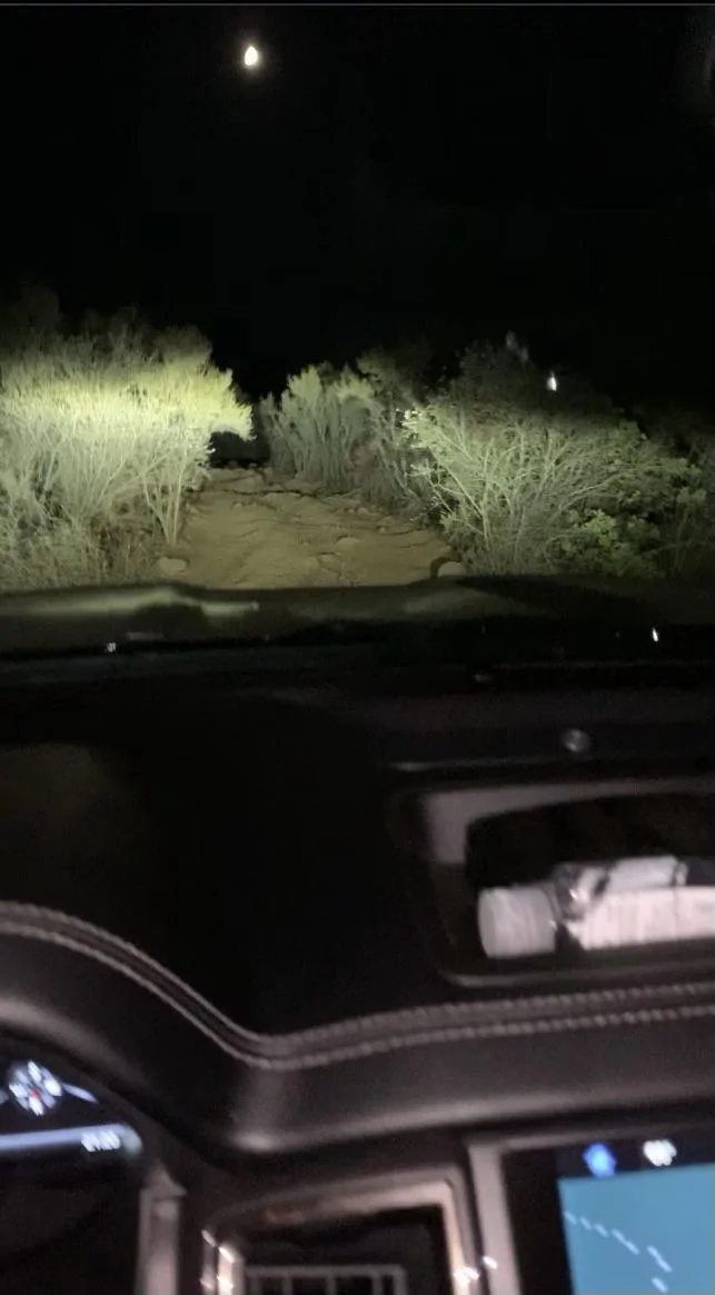

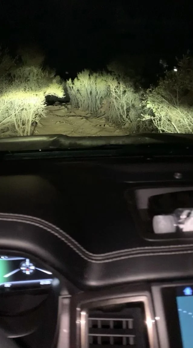

I personally run the tow tune on my truck which is my daily driver. The tow tune is a much better option when off-roading. The picture doesn't do the hill justice but it is a grade in the low 20's and the ground is a fine powder type of dirt kind of like walking in flour. My truck struggled a lot with the performance tune but in the end always made it up. Then when I switched to the tow tune I would climb up like it was nothing. After that experience I decided to always leave the tow tune installed. My tires are LT265/65r18 BFG K02 and I leveled my truck with Fox 2.0 coil overs, I also air down to 15 psi when off-roading.
