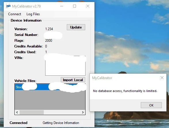

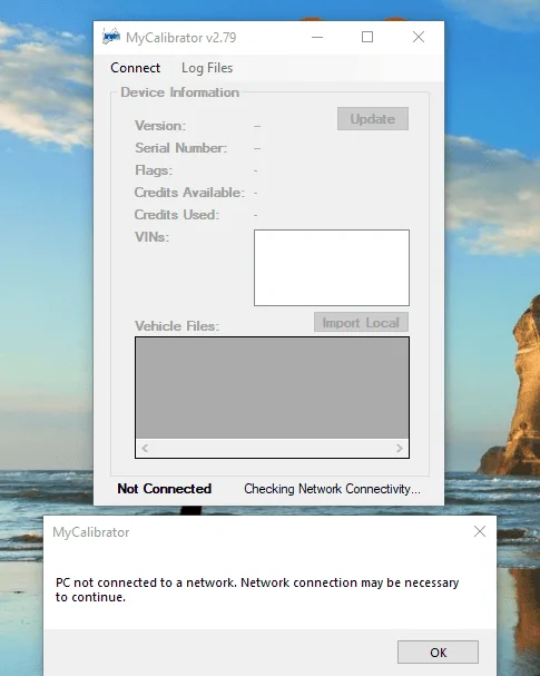

TLDR If you have errors installing Livernois tuner software & Xfinity-Comcast router, this might help. Otherwise, skip to next post.
Big shout out to Anthony for helping with the installation of the MyCalibrator software.
Great customer support! He remote connected to transfer the files since the software was being blocked. We did not find anything in the virus scanner or Windows 10 blocking it. Norton Security Online Software listed the software as Trusted.
I was getting a couple error messages when installing the software.
The errors were: click "Update" button: "PC not connected to a network." "Network connection may be necessary to continue message." (Though I was connected directly to the back of the router.)
Then click the "OK" button and receive an error: "No Database access, functionality limited error message."

Here's what I did to get it to work.
Basic Instructions:
1. Open Internet browser.
2. Type 10.0.0.1 in the address bar and press enter. (This is Xfinity-Comcast's default gateway number.)
You will be presented with a login screen.
3. Type in the default username "admin" and the password will be "password" (type in lowercase, it is case sensitive!
Also WITHOUT the quotation marks: example " ")
Then click LOGIN. You should go back later and change the default password afterwards too!!!
3. On the left side of the screen, click on Firewall.
It will drop down with more selections.
4. Click on IPv4.
5. Click to select Typical Security (Medium), then Save Settings. Mine was set on Maximum Security (High)
That's it!!!

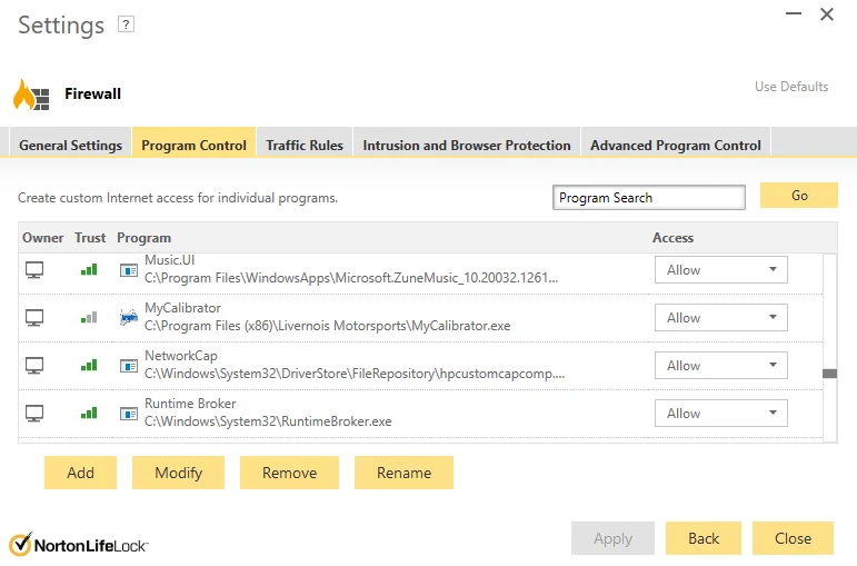

I'll finish with saying I installed the 91-93 Performance tune from Livernois Motorsports boy does it run great! Highly recommended! :like: I will be trying the other tunes when I get a chance. Thanks, Robert
This error involves a Xfinity-Comcast internet router.
