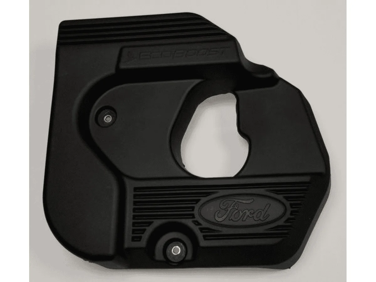

Where is this trans dip stick exactly? Anyone take a pic of it? I like to check the level...
you have to take off the painted engine cover
IIRC the "dipstick" for the trans is not under the engine cover.
It's under the truck, right by the exhaust. Loosen first, finger tighten, go for a drive to warm up, then check. Otherwise you could burn yourself easily.
