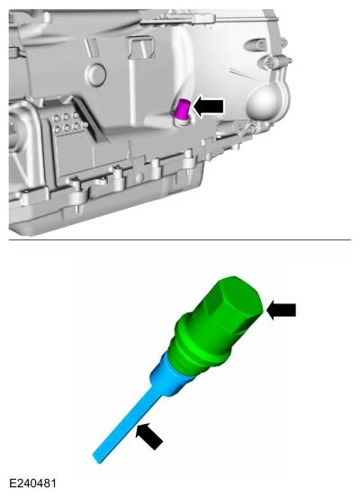

To the OP question. This job is not easy or fun.
Operating temperature of the fluid is critical to obtaining the correct level as is installation angle of the powertrain, so you can't just jack up a part of the vehicle. You will probably want a hoist and then you need to make sure you have the vehicle set at the correct angle.
You need to pull the pan to drain it. This will only get you the oil in the bottom pan and whatever may have drained out of the torque converter. You will not get most of the torque converter fluid or the fluid in the cooler. The dipstick is inside the large nut towards the front of the trans, behind the bellhousing.
I would save my pennies and get it swapped out correctly at a dealership using a fluid exchanger a later interval. If you feel you need to go earlier than the recommended interval, pick a mileage like 75k and get it done then. I have a feeling it won't be cheap.
Yes, the procedure is relatively complicated. I found the service manual chapter on it in an F150 forum and posted it earlier in this thread, so yeah, I'm aware of the procedure and it's not very fun. Unless you have a lift, it's basically all done on your back.
And I agree. I've always done my own transmission oil changes in the past, especially since getting it done elsewhere has always been expensive relative to the work involved in all of our previous vehicles. For this truck, though, I haven't decided for sure I will do it myself. Like you point out, it will be expensive, but even if you cut the recommended schedule in half, that's still only once every 75K miles.
