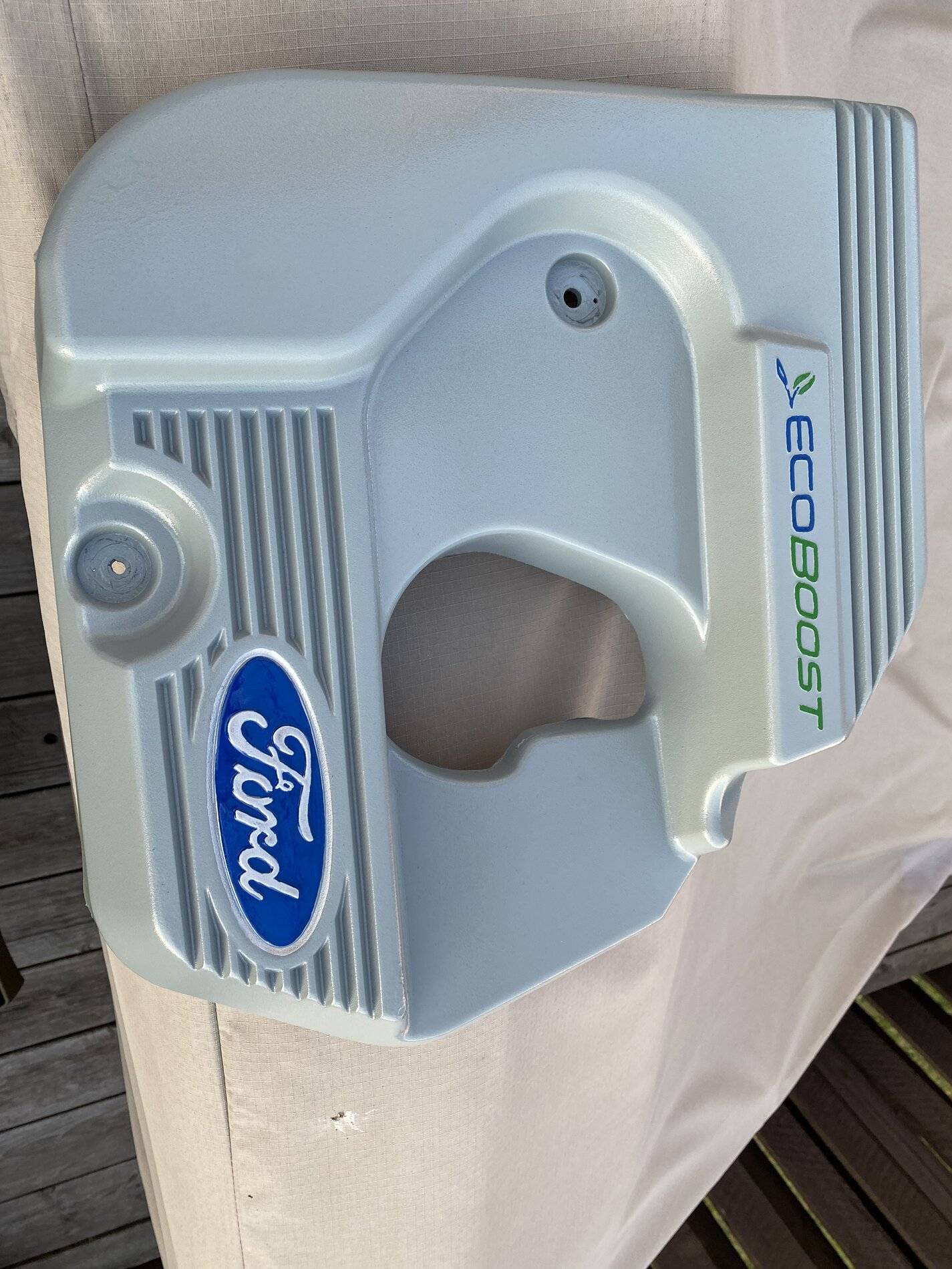

Here is mine. Has formed a large crack and a few smaller hairline cracks. The only two people who will see this are me and the oil change guy. Only one of those guys cares… and he isn’t repainting this indoors over the winter months.
I had the paint matched to Cactus Grey “NE”.
I can edit and post the primer, base, and clear info later.

Yes please on the edit later with primer, base and clear. I was trying to find this photo for a little bit, I knew I saw it sometime recently. I appreciate you posting it here!
